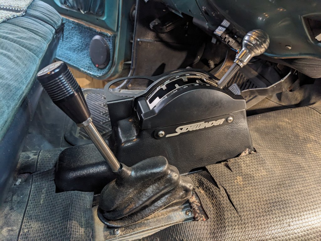

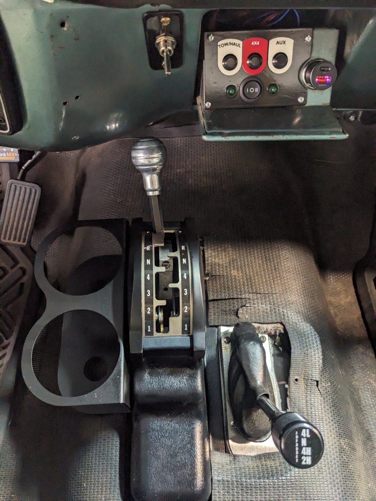

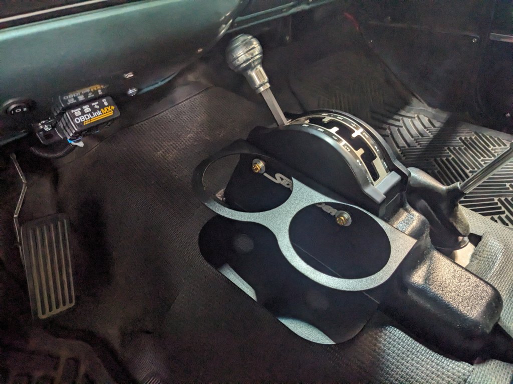

The truck is finally in service! Still working some kinks out.
Today I finished the install of the Winters Sidewinder. It looks great next to the JB Fab cable transfer case shifter. It'll all look much better when I get to revamping the interior!
