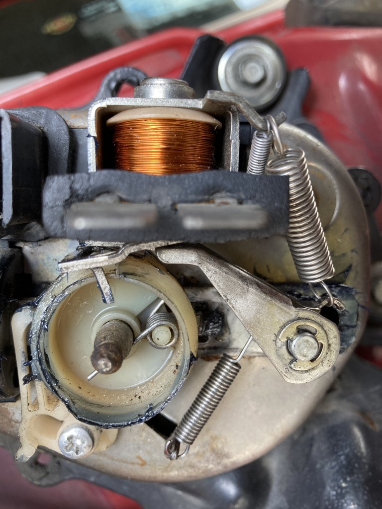

Found out the problem was a spring missing (don’t know where is went) in the motor that held the ratchet down when wiper operated. As it was missing instead of it going one revolution and switching off, the washer just kept on going. Fitted a spring I had and it works fine now. It’s not always electrical and that’s where I was looking. Then after staring at the working for a while, I thought there is a tag there for a spring. Sure enough that’s what problem was. Happy now. Thanks everyone.
If you can send me a pic of that spring I would like to see it. I suspect my issue is mechanical and that spring is there, but maybe it contracts too much in the cold.:think:
dtbnz
Oct 3, 2014
18
Auckland, NZ
Dave
See picture the spring to the upper right was the one missing and this pulls the ratchet into the rotating mechanism

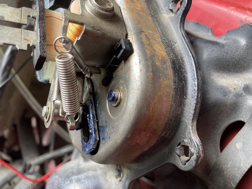

Note there is two springs the larger one was missing. See where it is connected
