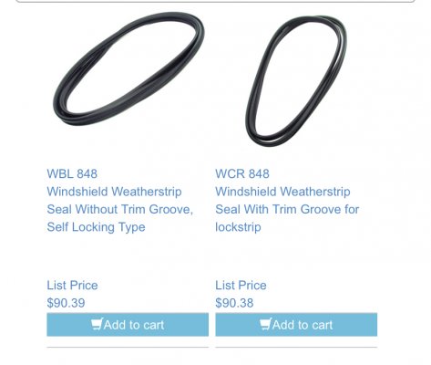

What is this? To my knowledge there was never a trim piece that went over the windshield gasket. Just the lock strip in any color you want as long as it’s black or chrome.

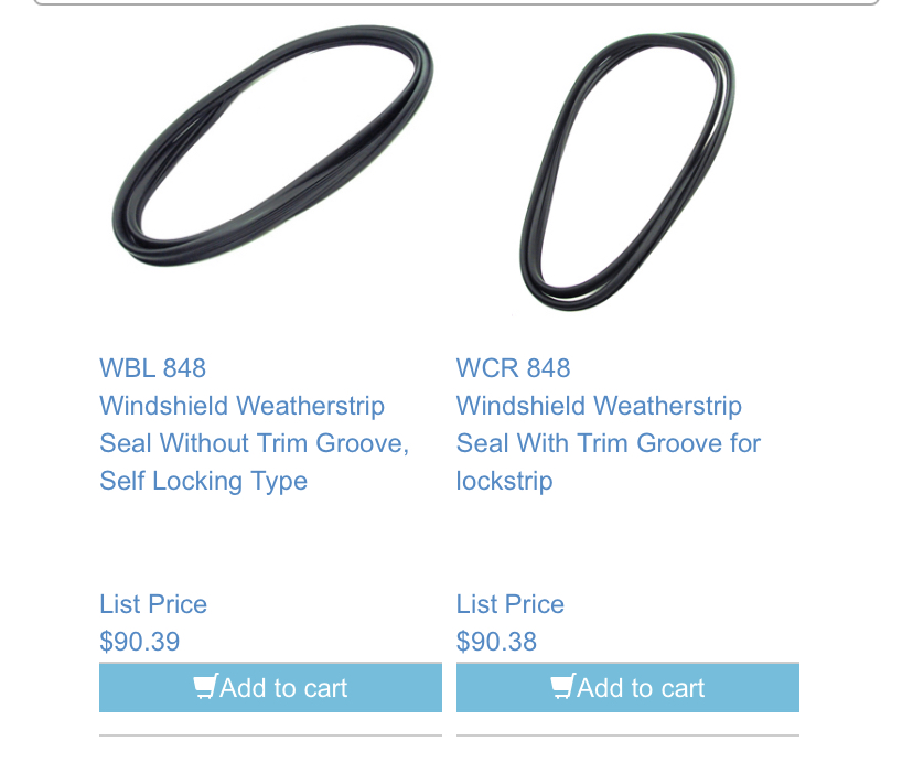

But they offer 2 separate parts. Normal or with groove for trim.

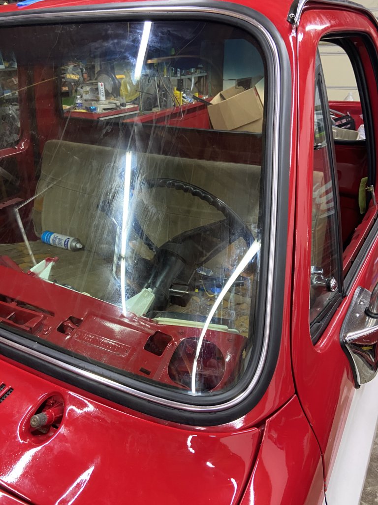

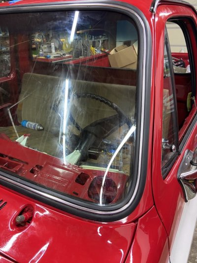

Here is the gasket with the trim grove and after the trim is installed. If you don’t want the chrome strip Wich is very hard to install just get the regular gasket

The "trim groove" is just the groove for the lock strip, weather it's black or chrome. Same thing, not actual trim
Ok makes sense to me. But I must be dense.
@86c10twotone, are you saying there are windshield gaskets that don’t have a lock strip? Just a gasket you fit over the windshield and that’s it?

Yes you can purchase either one . With or without trim grove.

Yes, I see both for sale. Hence the question.
@Craig 85, this question sounds like I’m dense, but are you saying there is one style of gasket (windshield and rear window) that has NO lock strip and the glass just fits tight in the gasket. And another style (like I’m accustomed to) that uses the lock strip?
