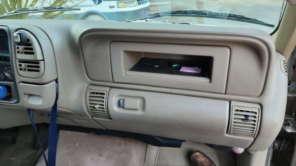

Yes there's a light duty 2500 that is 6 lug. 7200# gvw I think. The heavy duty 2500 is similar to the one tons. 8 lugs and no airbag; when these trucks were built, anything 8600#gvw and higher was not required to have them. If you see the dashboard and it has a cubby on the passenger side, and 8 lug wheels, then it is a HD2500 or 3500.
Here's a picture of the dashboard in my '97 C3500 CCLB for reference. Also, the steering wheel on these has a slightly smaller center/horn button, and doesn't have the SRS lettering on it.
