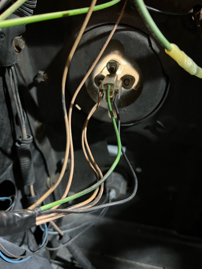

So I've got the stock sealed beam headlight with the male prongs sticking out into the engine bay, and female connectors from the harness that come into it.
I've got the hi beam switch next to the pedals (makes f-all difference honestly). As well I've got aftermarket round off road lights, that I use when visibility is really bad.

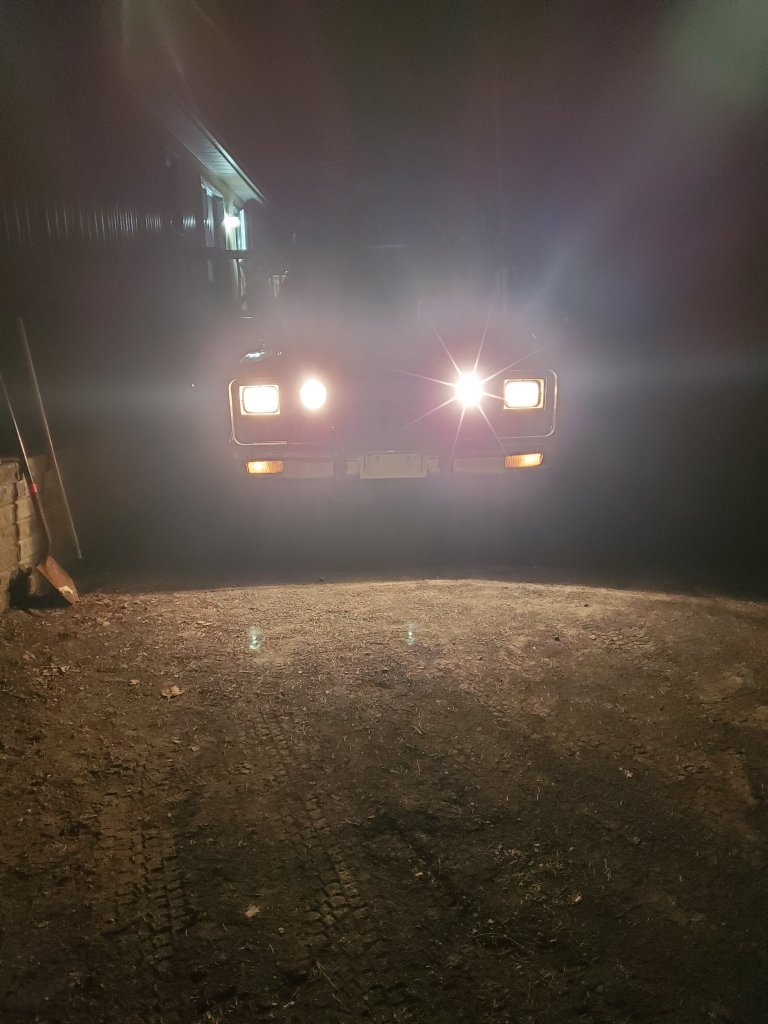

My truck is a 1982. I have noticed that my lights are in the bumper rather than the two square lights stacked on top of each other in the grill, which i think would look nicer, the classic squarebody look.
See pic for what I'm describing.
It looks like it's plenty bright but truth be told, those new hyundais with the collapsed sun for headlights, I swear, their lights illuminate more in front of me than my own lights, while their behind me, and when they come around facing me, I'm temporarily blinded. It's absolutely insane, fun when you're driving (a rental i drove had that) but being on the receiving end of those headlights, oh my God

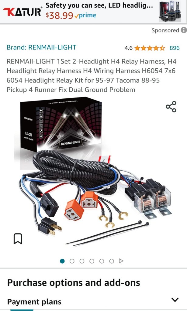

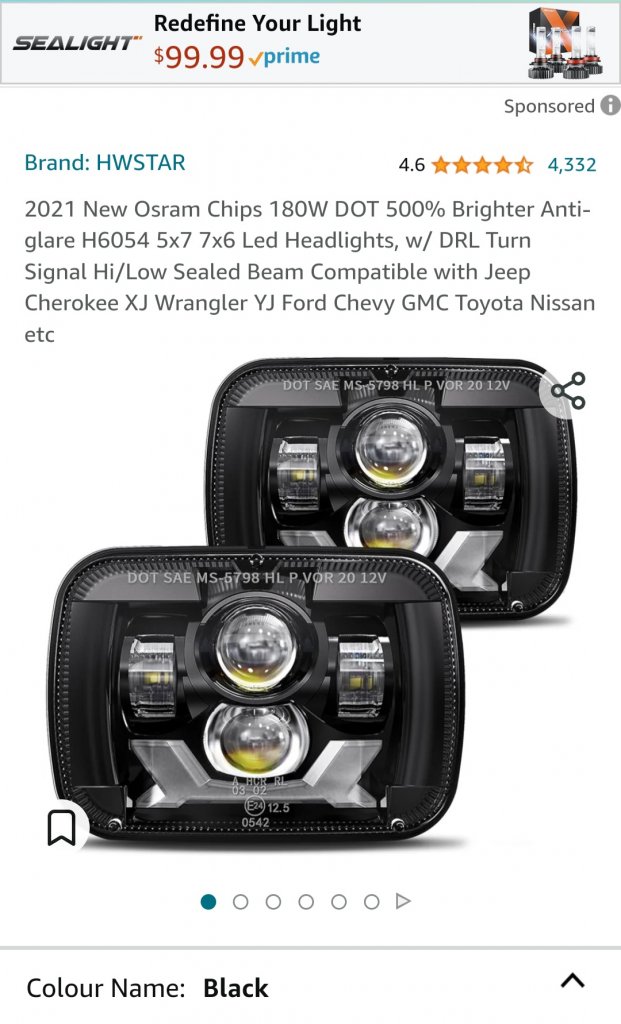

So I took two screenshots, one of an example of headlight I'm looking at, and the other of a wiring harness that is "frequently bought with" the headlight I chose.

I daily drive my squares and leave for work at 2a.m. So driving in the dark every day. I was looking into aftermarket lights, H4 halogens leds etc etc. I made my own relay harness to pull power directly from the battery and man, my factory style sealed beams are plenty bright. Night and day (pun intended) difference from before.
Any aftermarket light set up you get is going to be a disappointment if you’re only pushing 11.5 volts to them like I was before running relays and getting full 14.2 battery voltage while running.
Try that first and see how you like it. If not, then when you get whatever aftermarket set up, you’ll be getting the full potential out of them as well.

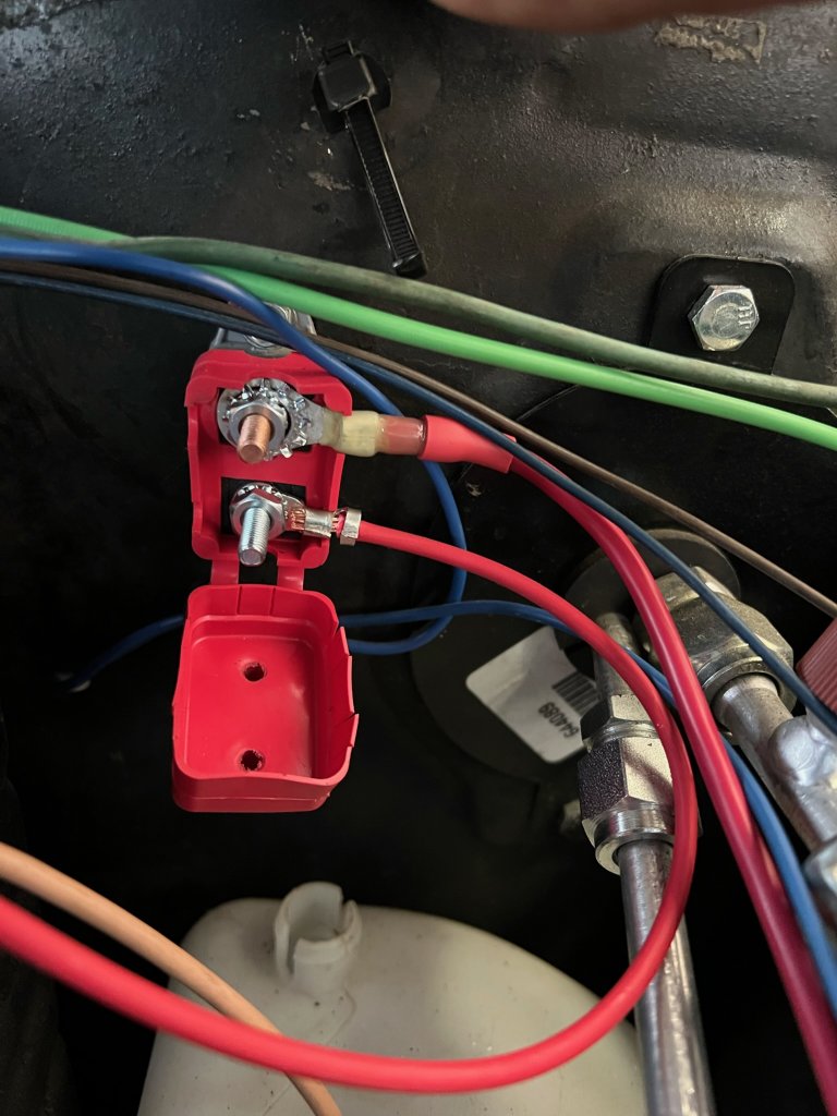

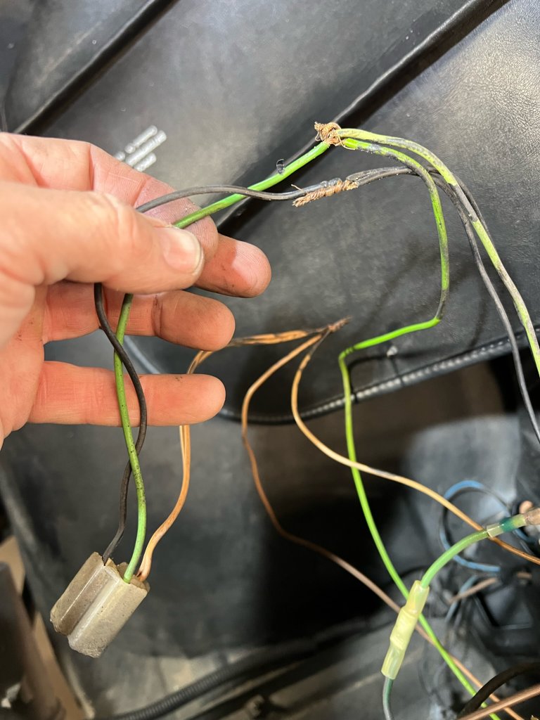

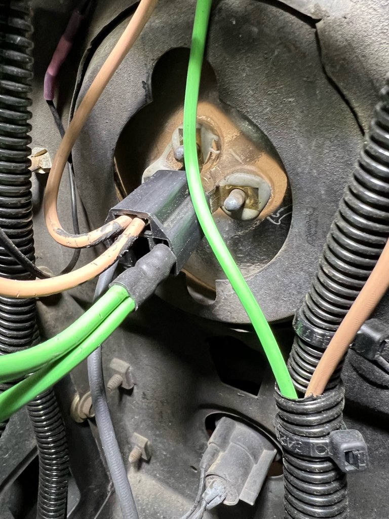

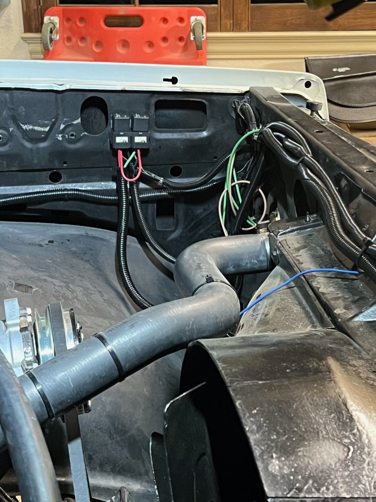

Easton wants to do LED but not a top of the list item at the moment. We had a mess of our lights from PO so we did the American autowire relay kit which allowed us to clean up all the mess firewall forward and now that we are battery direct to headlights Eaton is really happy with the light output difference.

I bought Hella housings/buckets to use 9003 bulbs. Much brighter than sealed beams and not obnoxious like LEDs.
We have the same setup, but I also have the Hella 550 (clear) fog lights.
As for the difference between sealed beam halogens and the Hella buckets with 9003, the difference is huge! My truck went from having the worst headlight out of all of my vehicles, to the best.
