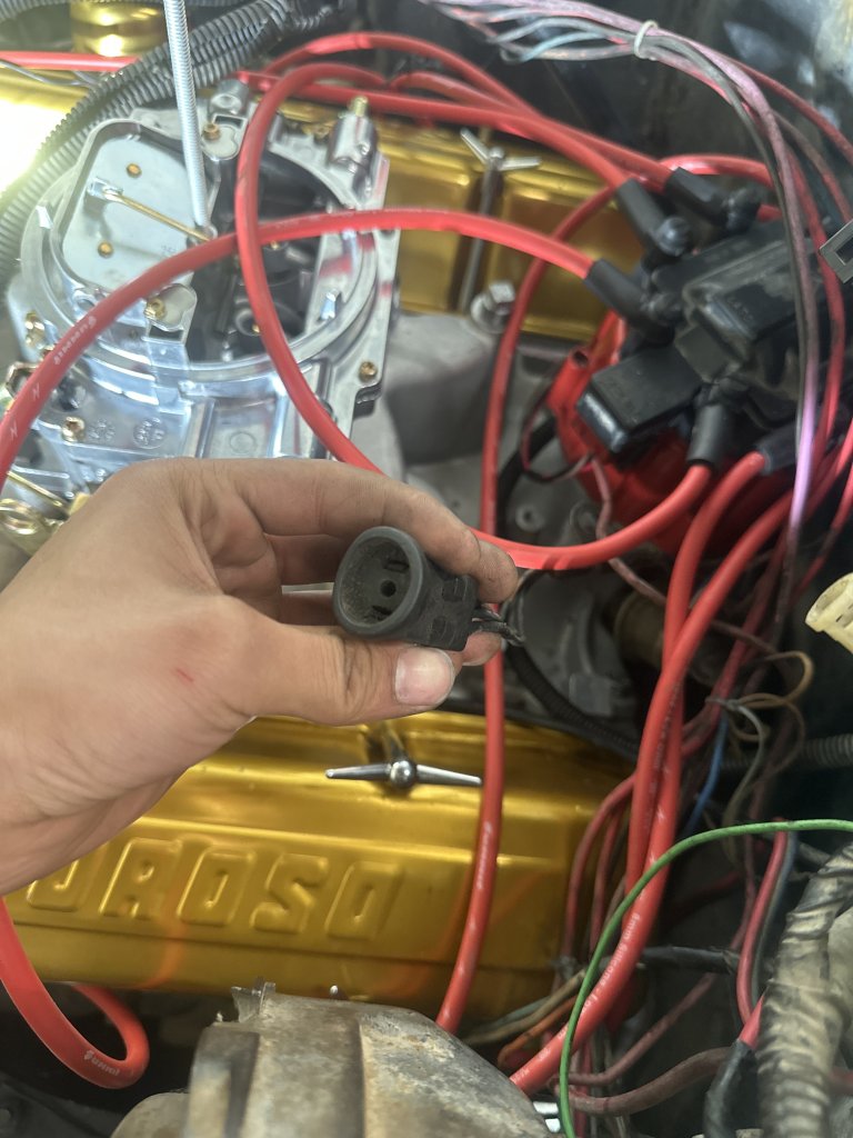

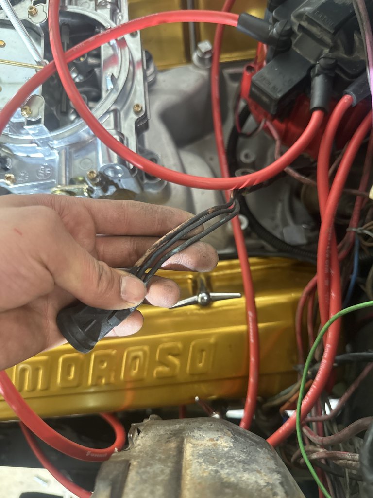

What’s is this wire?
I’m currently getting no crank no start, new starter alternator battery, ignition switch, neutral safety switch and stilll Notbing.

No idea what that is for but, check for 12V at your distributor.

Is that wire for oil pressure/sending unit?
Wouldn't have anything to do with power issue but to me looks like oil pressure switch connector
I don’t think it is since I already have the oil pressure unit connected. It’s a brown wire I believe

The plug you are showing is for the electric choke oil pressure switch.
