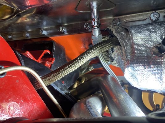

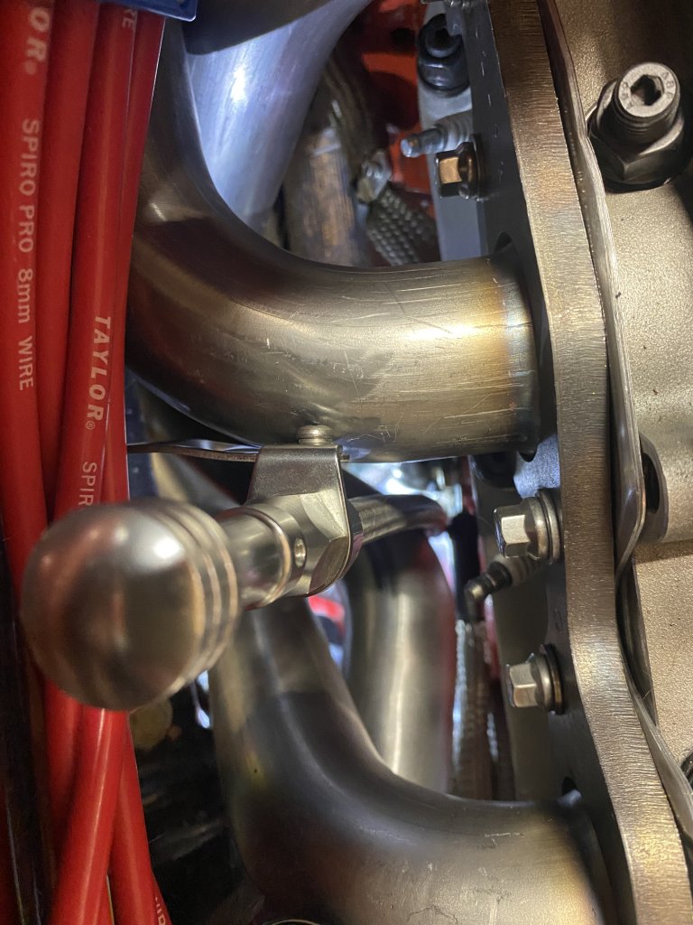

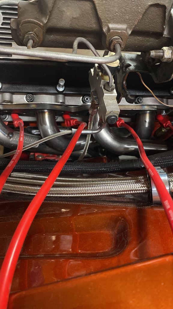

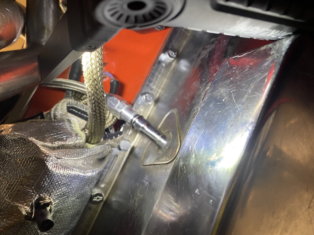

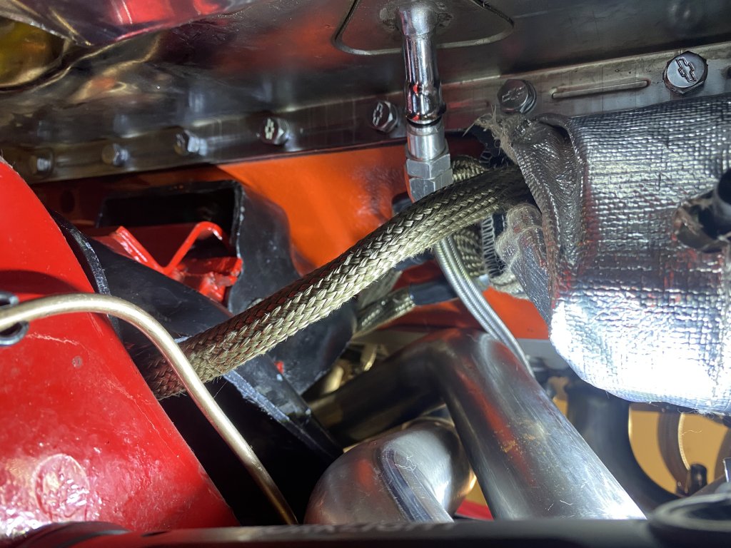

I have a 2WD truck (1966 GMC 1/2 ton) with a BBC with a Squarebody front crossmember.
I used Squarebody C20 clamshell mounts, which are different than SBC mounts.. especially the frame brackets.
In the original configuration with stock cast (781) cylinder heads… Hedman #69110 were a perfect fit.
However, an upgrade to Performance World aftermarket aluminum heads with 0.375” raised ports resulted in insufficient plug boot clearance. Boo.
I presently have a set of Patriot #H8054 Squarebody headers installed.
Plug boot clearance will work with 2500*F basalt plug booties.
Installation issues:
1.) it required the Vortec mini starter. No room for the stock Delco 10MT.
2.) the collectors are angled outward toward the frame, which is causing me grief with my 3” exhaust cutouts. Planning to rosebud the header tubes in front of the collectors and straighten them out.
3.) the dipstick is mounted on the RH side of the engine and goes into the oil pan. Welp, header tube #2 snakes under #4, and ends up almost completely blocking access to the oil pan dipstick boss!
I’m seeing both of the last two issues as straight up design flaws.
I have a set of Hedman #65002 (70-72 Chevelle application) on order and hoping for a better fit.
