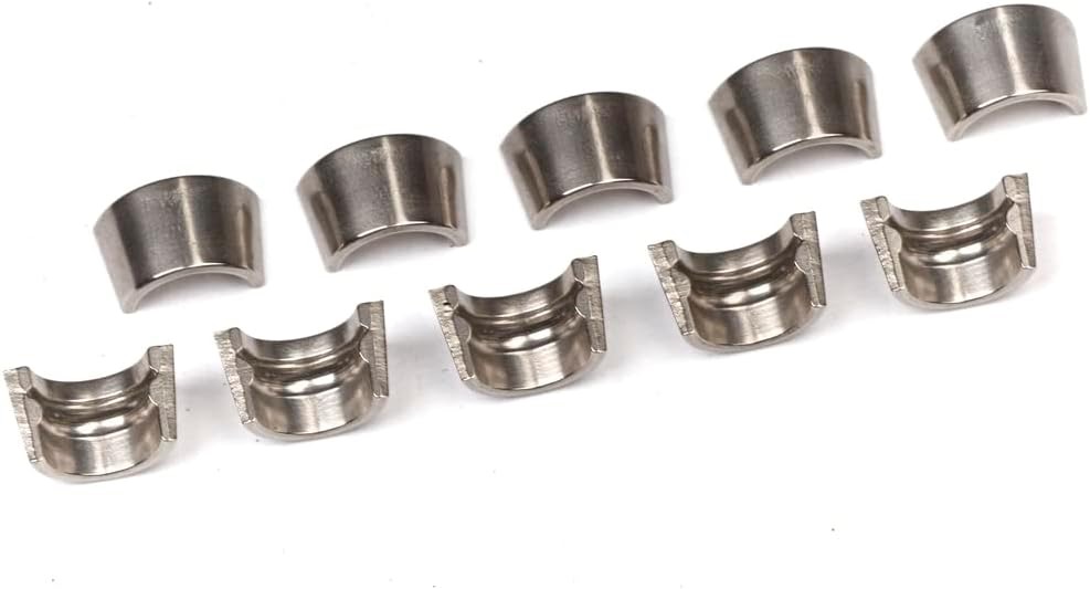

I'm having a heck of a time finding the correct size 305 valve spring retainer sets. I ordered from Summit and the Jungle Place but the retainers were too large. In both cases I was very specific 1985 C10 305.
My Go-To O'Reilly's can't get them. NAPA guy did not know what they were!
Am I missing something? Is there something specific about that valve size I should know? I'm absolutely sure the engine is stock.

Are you talking about the round part next to the spring or the split cone parts that hold the valve?

Rick, they are the two part cone lock/keeper that attach to the valve ends holding valve spring retainers.
I'm replacing the valve seals. On the very first valve I lost the keeper! LOL typical. :disgust:

Make sure you're installing them correctly. If those keepers are too big, they're probably for a BBC. or another make. All SBC valve keepers (the part in your picture) are the same.. The spring retainers (the part that fits on top of the spring are engine specific according to spring size..

I found out the hard way years ago that the valve spring locks' taper (official name) needs to match the taper of the retainer. No telling what has happened in the past or what brand hardware was used if a valve job was done.
Bring two locks and a retainer to a machine shop and see if they can match them up.

Thanks Rick, clearly this is the answer. The valve stems are 11/32 as they should be so it has to be a valve retainer/lock mismatch. I just assumed they were all universal.
