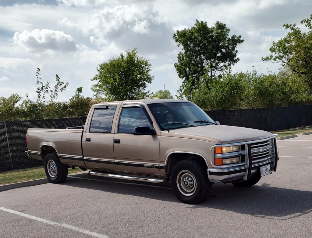

Yup the last year or so I've noticed fewer OBS trucks in the local yards in greater Houston area. I went today, to get parts for my CCLB, and they probably had a dozen or less of them in the whole 31 rows of trucks. People aren't scrapping them, they're using them for parts trucks.
