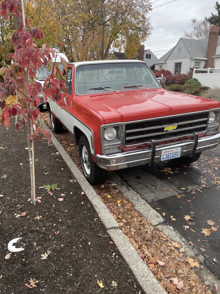

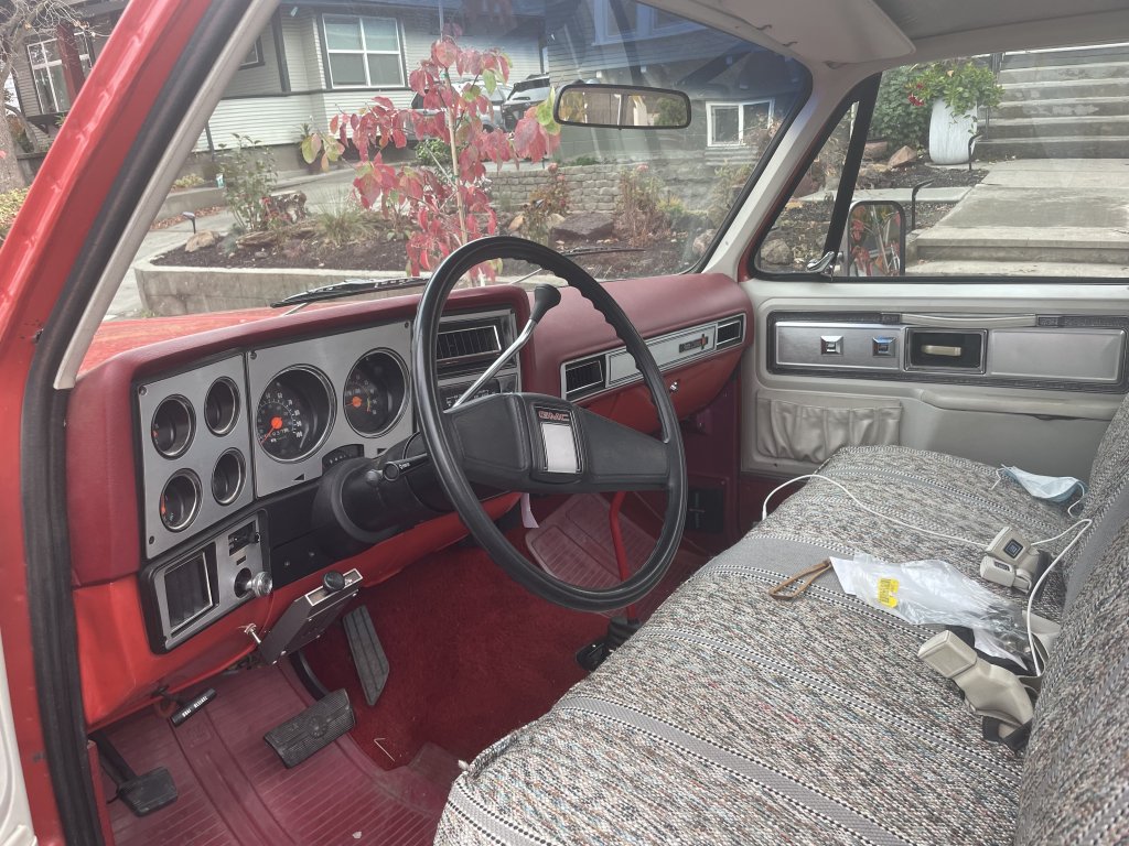

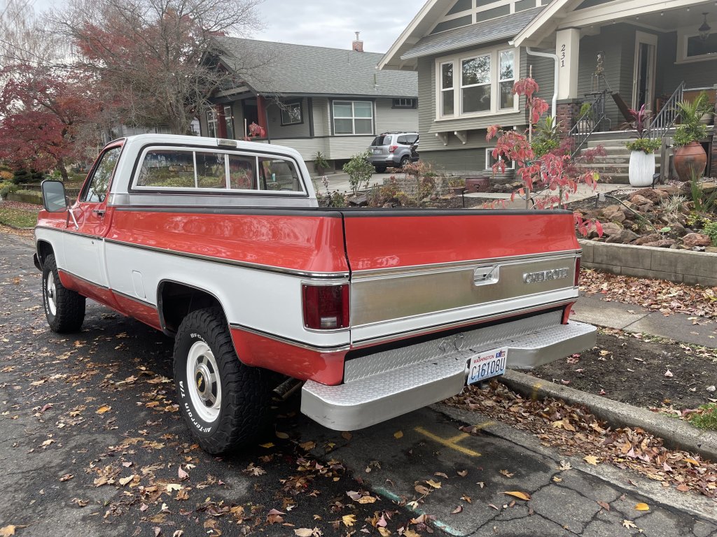

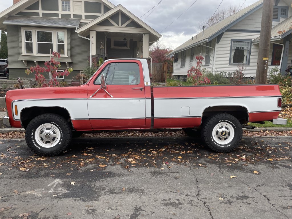

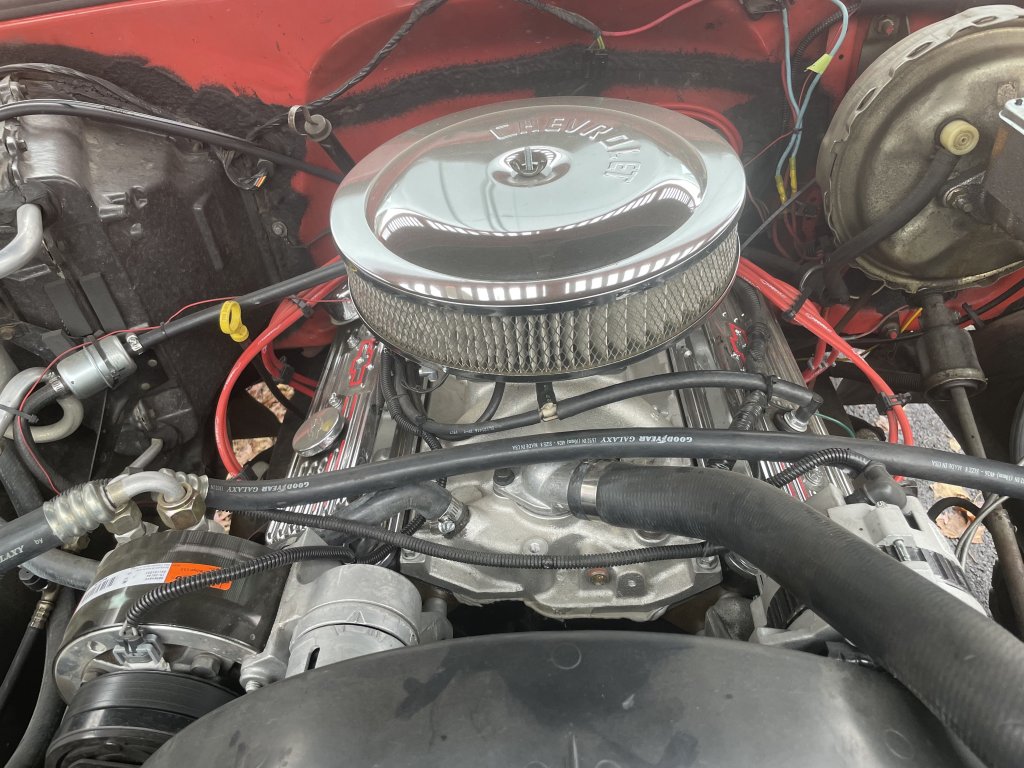

But need some pics of that ‘79 dumper! What part of WW you in?
I'm just a mile east of downtown Walla Walla, near Wildwood Park.
