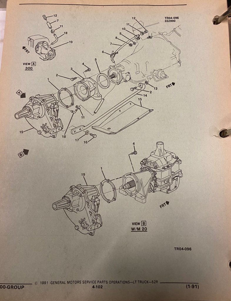

It’s pretty easy, just start by bolting it to the side of the tcase. The bar will line up with the correct bellhousing bolt.
