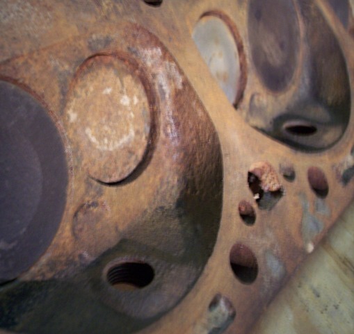

Its a good possibly of cam lobe damage if you had stuck valves, or the valves were ever adjusted to tight. Sounds like someone did a good job on the Qjet rebuild and if no vac leaks at the intake runners or carb, and its in time, keeping in mind, even with a timing light and lots of slack in your chain and gears, can make a liar out of a timing light too. Here is another suggestion to consider. Depending on the year model or the heads on the truck, I had an 81 GMC that I bought used for real cheap cuz the guy said it had a miss that he could never find and he got sick of being pissed off and frustrated with it, as it sounds you are with yours. I forget how or why now that I decided to pull the heads off, and when I did, I found the exhaust valves were recessed considerably. The good old unleaded gas damage that some claim does not happen and is just a myth. BS, I have the proof it happens. Those valves on the worst cylinders were recessed almost a 1/2 inch. Duh, no wonder it had a miss and lacked power. Put a set of rebuilt heads with hardened seats on the motor and it ran like a raped ape and smooth as glass afterwards.

Pic of recessed valves caused by unleaded fuel to a non hardened valve seat.
