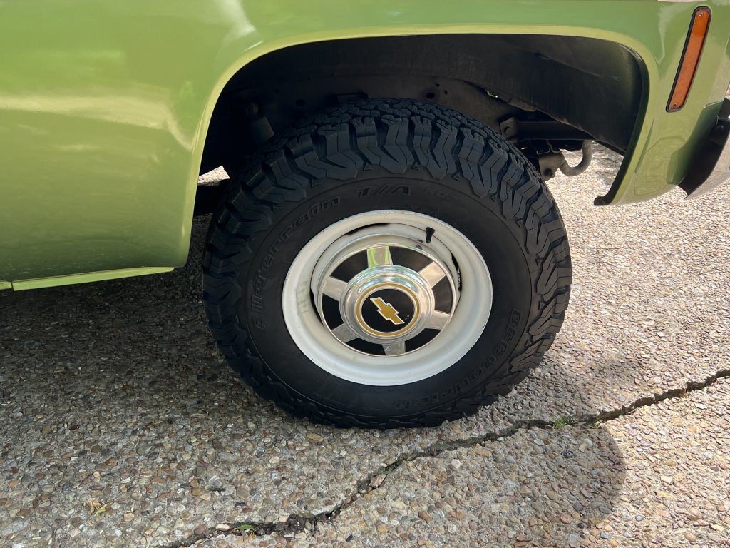

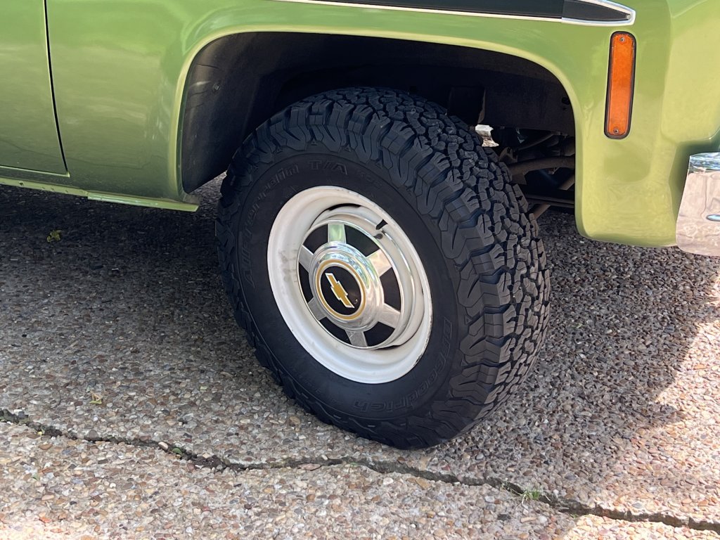

thank you so much for the GREAT information! Very useful and helpful. I will try to find some 16" Steel wheels which will fit my truck, accept larger tires, and my factory hubcaps. Thanks again!
