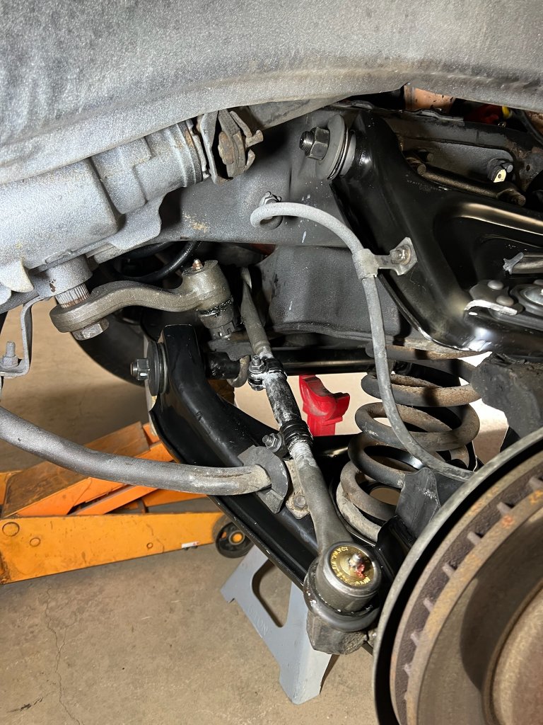

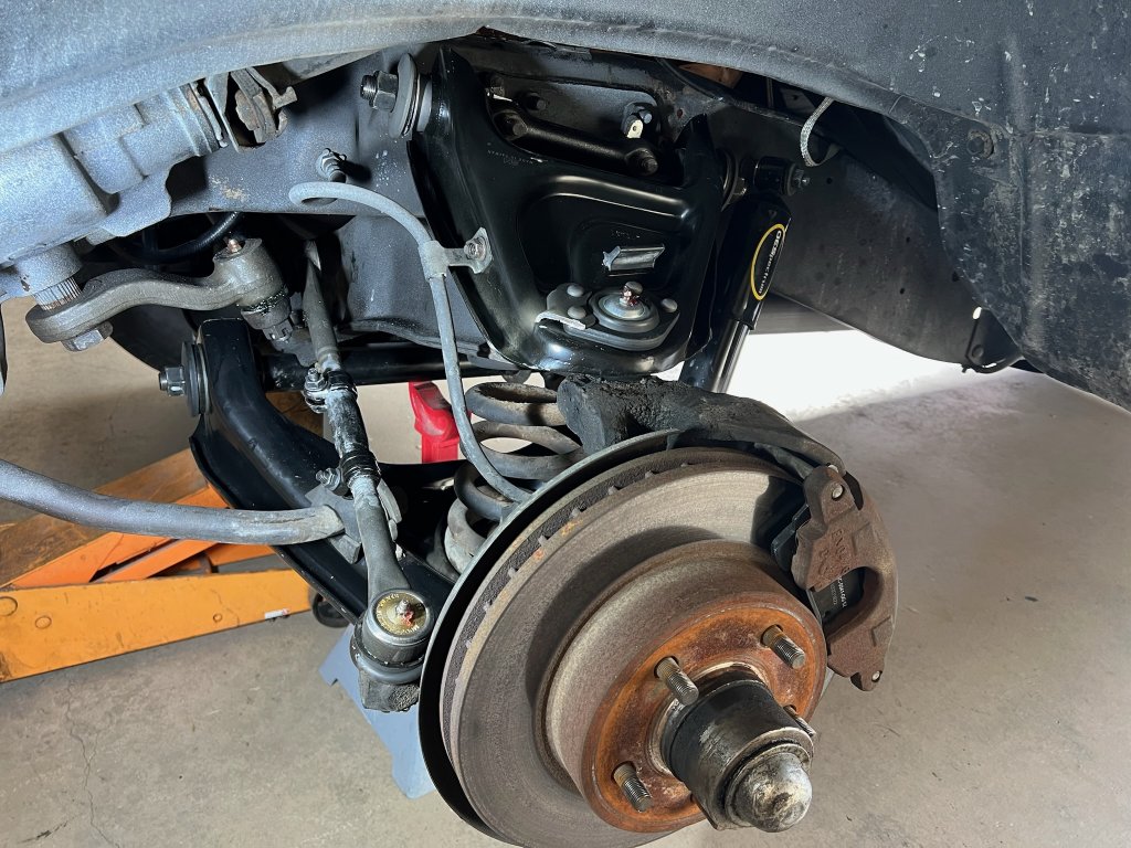

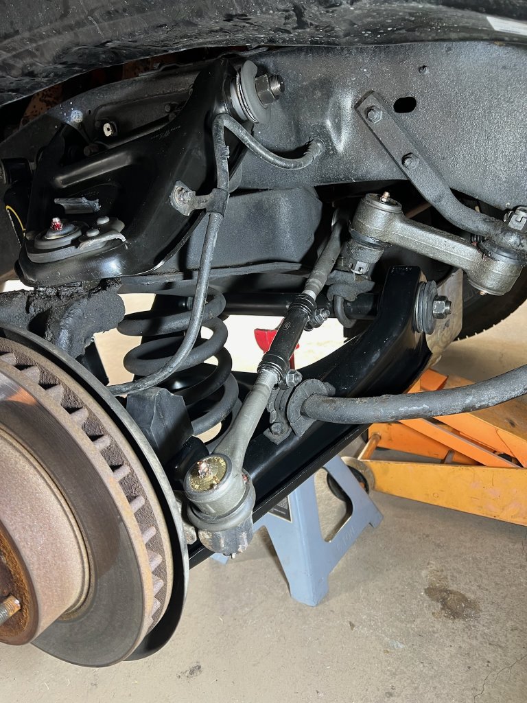

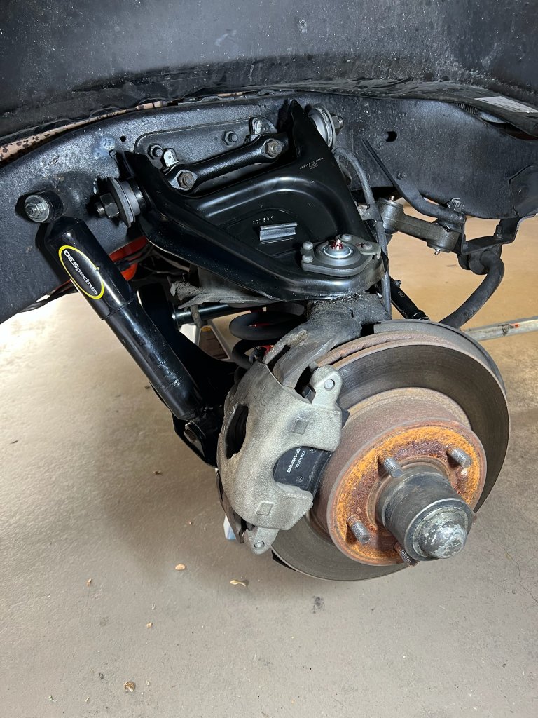

Agree with @animal on that. We did new upper and lower control arms from LMC and re used shims to get it to alignment shop. Perfect now
