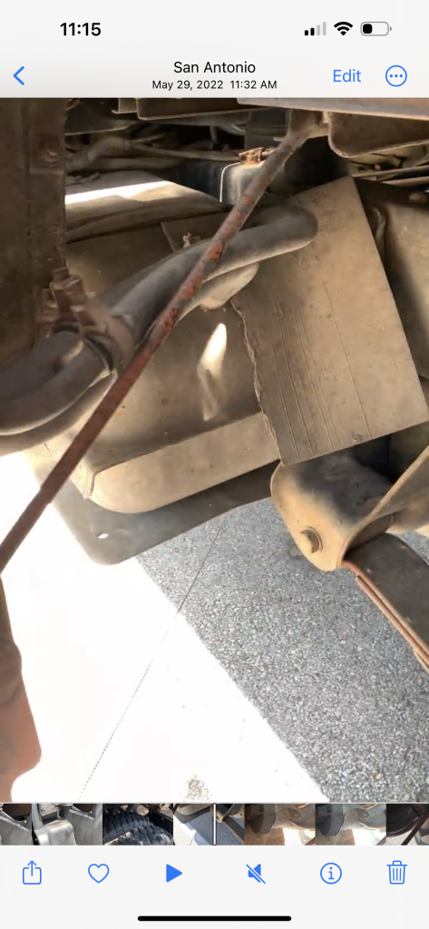

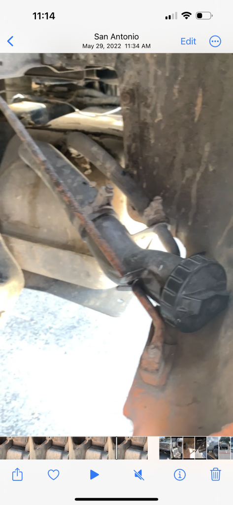

I have seen multiple threads on this topic but nobody has posted pictures of their setup. I have a 1980 GMC 1/2 ton with dual 16 gallon tanks. The previous owner changed out the fleet side bed with a Chevy step side. Not sure what year the bed is from but it does have fuel doors so it has to be somewhere between a 1979-1987. PO did not change the filler necks, filler hoses, or vent hoses. I have no clue how he was able to add fuel to the tanks. Current project is to replace everything from the tanks to the fuel door. Can someone post some pictures of their current setup for a 79-87v
