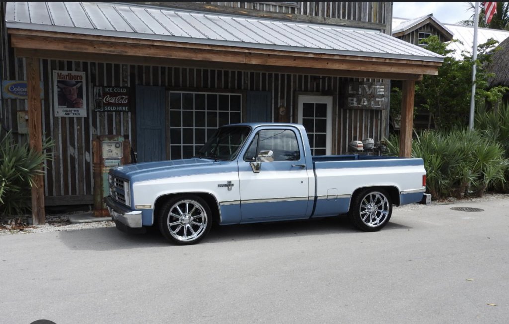

I am in the process of rebuilding a ‘87 squarebody. I want to lower the suspension 3” in the front and 5” in the rear and I have never lowered a suspension. I am on a budget, so…
What is best?
1. 3” drop spindles with stock springs
2. 3” drop springs with stock spindles
This is not my truck, but the stance I’m looking for.
Thanks for the help!
