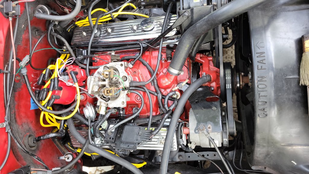

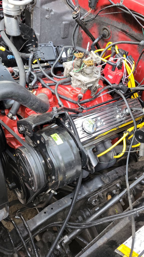

I have a 87 Chevy R1500 w/ 350 TBI. Truck sat for about 7 yrs and am getting it road ready for my nephew. Installed stock rebuilt engine a few weeks ago. New MAP, EGR, O2, TPS, ESC, distributor and coil. Disconnected spark advance and started up. Got timing roughly set around 0. Plugged the advance wire back in and Engine was idling fine but would not increase RPMs without it spitting and stalling. We were stumped...Started was not working consistently so we got a new one and installed today. Now with no changes to any other components I am not getting any spark or fuel delivery. Could it be a ECM failure? HELP!!
Side note: while my nephew was removing the bad starter he did not disconnect the battery and arced the wrench across the frame momentarily. Could that have fried something else?

Never a good idea to ground power like that, kill the ECM or module? Possible but unlikely. You say fuel delivery does that mean no fuel pressure or no injector pulse? If no injector pulse with a test light ,key on, check for power on each injector. If power is available attach the ground lead to the other terminal. Cranking, test light should pulse.

Check your fusible links on the smaller wires on the starter. Check your fuses in the fuse block. Arcing stuff in an EFI car can do bad things to the ECM... hopefully its just a bad fusible link or blown fuse

We checked all the fuses. None were blown. I will try checking the injectors now. But why no spark? They both failed same time. I pulled a ECM out of an 86 with EFI but nothing changed. 86 was in pieces and has been a parts Truck for a while so ECM may not be good either.

There is a different diagnostic procedure with or wo pulse. My guess is a module or related but guessing isn't a good idea.

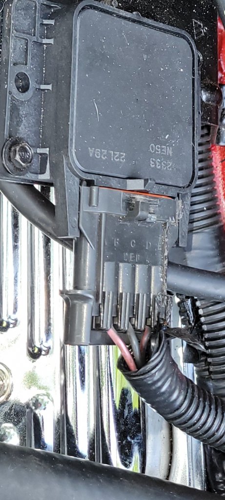

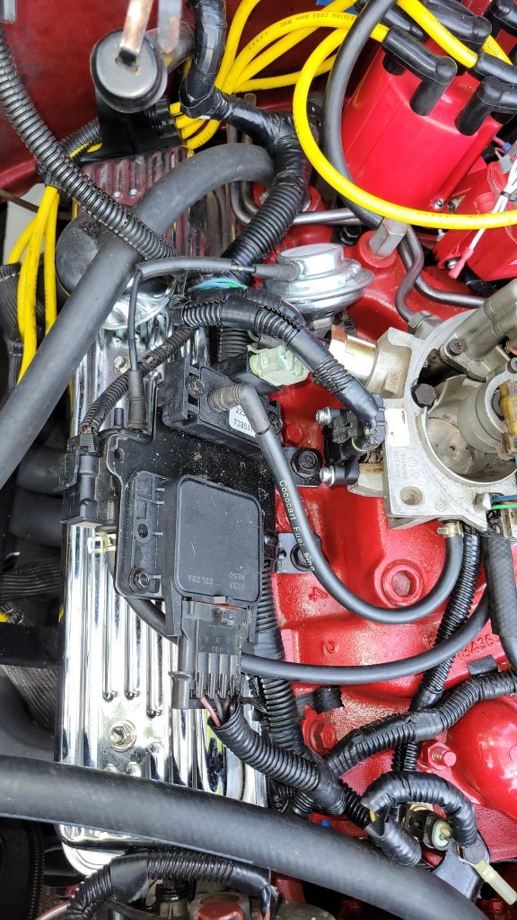

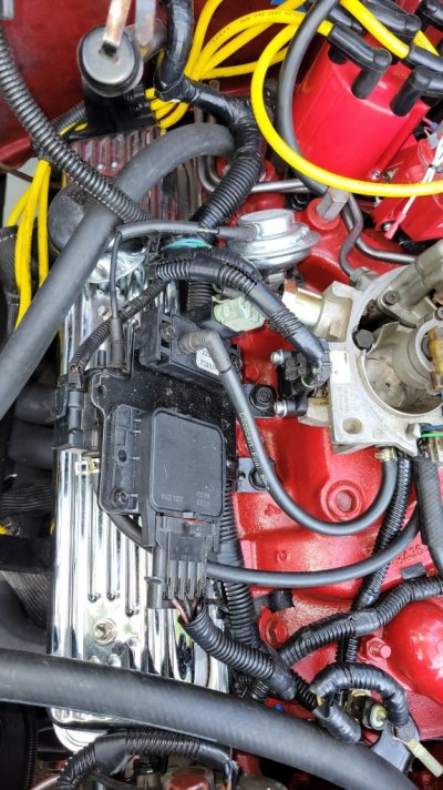

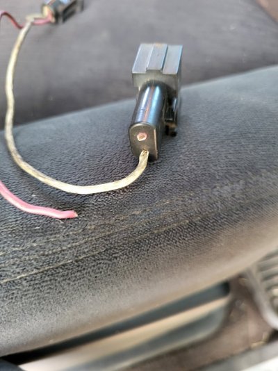

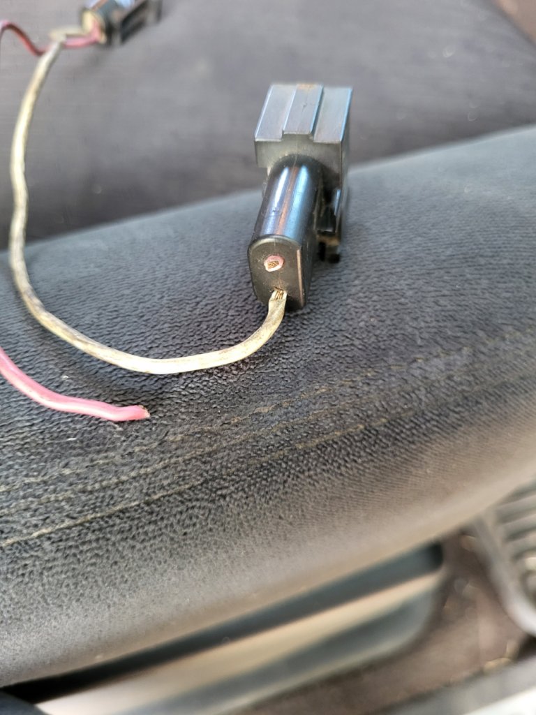

Ok. Thanks fellas. The issue was bad connectors at the coil to dist. $35 each!
Engine surges at idle (2000rpm) a little but settles down after warm up. Still cannot rev engine without stalling/missing. Where do I start?

Check for vacuum leaks. Then check the timing. Then do an IAC reset.
all good advice right there. you may also plug the vacuum lines for the EGR and see if that makes a difference. sometimes the wrong type of EGR gets installed mistakenly.
also check the fuel pressure.

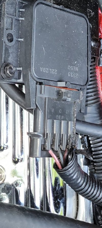

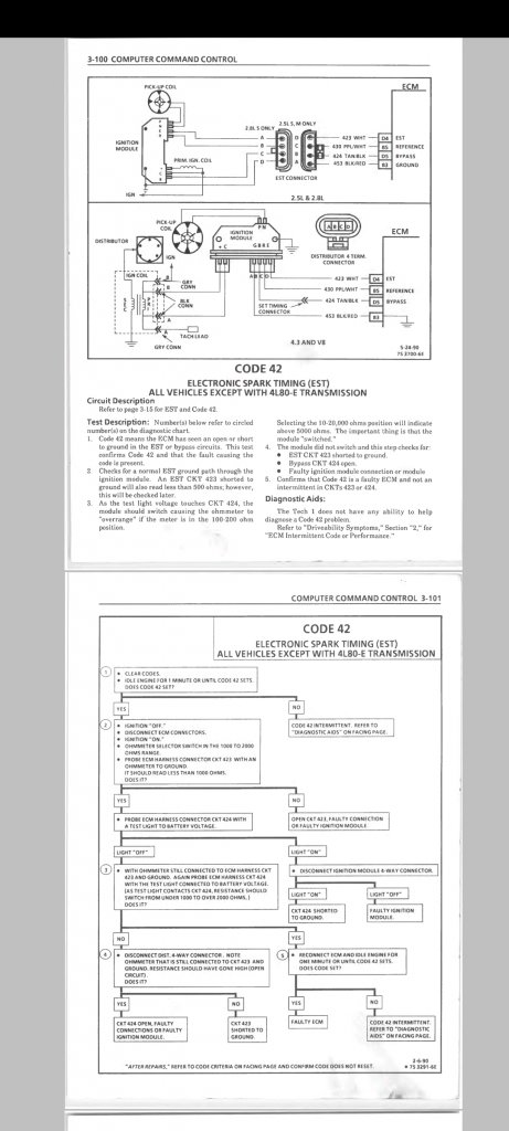

Ok fellas. I appreciate all the advice. I combed through the vaccum lines and confident those are good. Reset the IAC by jumping 1-2 terminals on OBD 1 and turn key to on. Is that the correct way? I did plug off EGR and idle changed a little. Also took ICM to Autozone for them to test. I was able to get the engine to 2300 rpm without missing or backfire. I bench tested knock sensor. Good to go. I am curious if the ESC is working properly. Getting 12v from red wire (B) and 9v from black wire (C) and good ground continuity from blk/red (D). Blue wire (E) goes to knock sensor. . When I tap on the block next to the KS the voltage drop from 9v to 5v - 8v depending on how hard I hit. My question is is 9v correct for the black wire and should it be showing a decrease in voltage as a signal?
One last thing: Does anyone know what reading I should be getting from the wires at the ICM harness? I read somewhere tan/blk wire needs to have 5v from ECM. It is the same wire that is disconnected when setting timing. The wire has good continuity on both sides but no voltage while key on and no voltage while idling. I feel this is my problem. Nothing changes with timing when I reconnect or disconnect Thoughts?

if you disconnect the tan/black EST wire and nothing noticeable changes with the engine running, then that is an issue. does the check engine light work? do you have a code 42 stored?
I'd start reading up Section 6 of the drivability and emissions manual that covers the EST system.

Yes I have 42 and 43 code stored.
