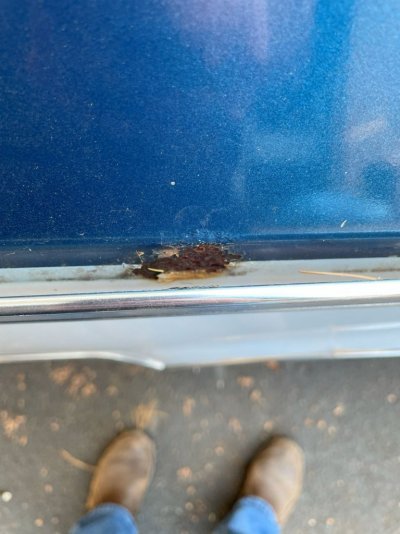

Today I launched a project to repair minor rust under the bedside molding on my 1980. The stickers holding the molding started to pull away from the bedside and pulled the paint with them, causing rust underneath. Pic attached. I found pitting but no weak metal and no holes. I'll document the project here in case anyone wants to help me learn by providing feedback and in case it helps anyone else.
I'll preface by saying that I'm tackling this project in my driveway, in the cold, and as time allows. Not ideal for sure, but rust waits for no man.
Today started with a run to Napa for advice and to pick up a bottle of Permatex Rust Treatment to use on any micro-rust that the sandpaper can't remove. Napa sent me across town to BAPS Auto Paints & Supply for more advice and more options since Napa didn't have any epoxy primer in stock. The BAPS manager came outside to look at the truck and take color readings of the blue and white paints. They sold me an epoxy primer aerosol.
First step was sanding to bare metal. I used 2" sanding discs with a sponge backing, attached to my drill. 80-grit paper made quick work of it. I cleared to about 1/2" of bare metal around the rust spots. Not sure if that'll give me enough room to work with the filler, so I might go back and clear some more before I get to that stage.
Next step was to apply the Permatex Rust Treatment. Bottle says the temp needs to be above 50 degrees, so I gently used my heat gun to warm the bedside before applying. I poured the rust treatment into a small container, applied with a small brush to the bare metal, and repeated after about 20 minutes.
Next steps tomorrow are to lightly sand to remove any flash rust and then apply the primer. No rain in the forecast.

UPDATE: Today started with applying a Simple Green Crystal cleaner/degreaser solution with a microfiber towel, followed by 320-grit 2" discs on the drill with the foam pad underlayment. In hindsight, I should have gone to the store for 320-grit sheets to use with a foam sanding bloc. I think the result would have been a more even finish without the swirls.
The point of the sanding was two-fold: (1) knock down the Permatex Rust Treatment that had had formed bubbles and ridges from the brush-on application; and (2) feather the surrounding paint to prep for primer. Sanding the Permatex sucked because it gummed up the sanding discs and I had to change frequently. I'm bracing myself for the same thing happening when I go to sand the 1k epoxy primer. Oh well.
After the 320-grit on the drill, I sanded with 600-grit on a firm foam sanding block. Everything I read said to use 320-grit before primer, but the BAPS automotive paint store said I should just use 600. Since the rust and the color transition are on two different body panel planes, I tried to sand separately on both planes. I was pleased with the result. I thought it feathered the surrounding paint nicely. The only bumps I felt with my eyes closed were the spots with rust pitting that will need to be filled later with filler. Pics attached.
After sanding and blowing off whatever dust I could with the compressor, I cleaned the remaining dust with the Simple Green solution and another microfiber towel. Then I followed with denatured alcohol to fully clean the surface before priming. Then I taped and gently warmed the surface with a heat gun. I warmed the primer in a bath of warm water.
The primer went on nicely but had more overspray than I anticipated. Oh well. At least I didn't tape hard lines so that the primer would feather in. After one coat, I repeated the warming steps and applied the second coat. I'm pleased with the results. Pics attached.
Here are two pics after applying Permatex Rust Treatment yesterday and before sanding:
Here's a pic after sanding:
Here are pics after priming. You can see the pitting where I need to come back with filler. I debated whether to go with regular Bondo or glazing putty because of the small pitting. I opted for regular Bondo because I anticipate needing to fill a larger area than just the pitting so that the bedside is as straight as possible.
