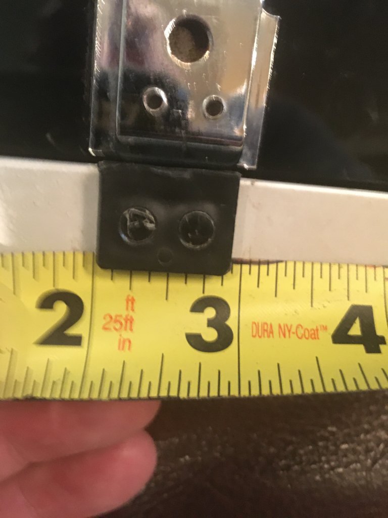

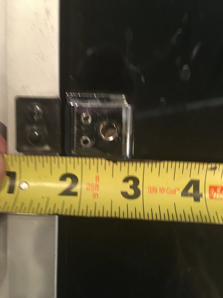

Yours is extremely similar to the window latches for the Blazer Slider windows... I purchased the rebuild kit and it came with two new latches.
The mounting screws are 3/8" spacing ... see pic below

Few more Pictures ... I hope this helps and that the replacement lock for Motor City K5 works for you.

Rob - I received the latch from K5 that you recommended to me and it was a spot on, perfect match, exactly what I was looking for. Thank you again for taking the time to take measurements and pictures. I appreciate you.
