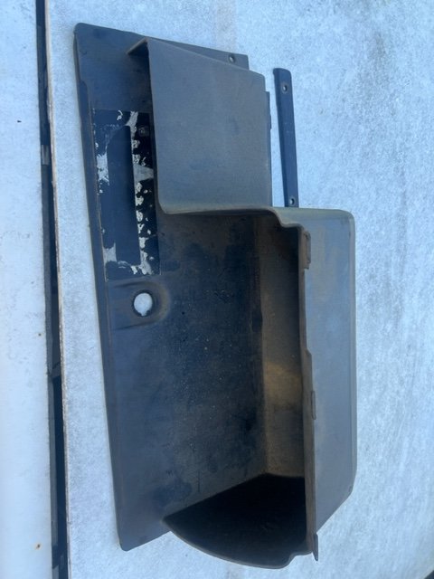

I have a 1986 GMC High Sierra S/B I recently acquired and I'm looking to see if any company offers replacement option code labels (for the glove box) with the option codes for my truck's VIN.
Anyone know of a source?

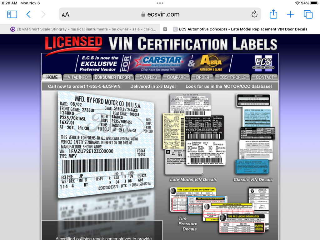

Heard good things about this company.
ECS Vin

that would be nice to get new labels . if that place is legit....for someone who is doing a complete restore to factory show room

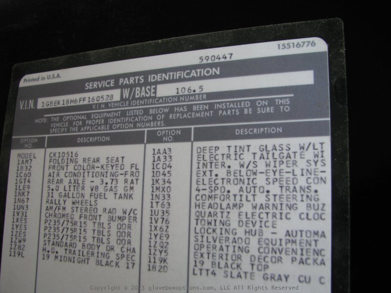

Corresponding original SPID:

gloveboxoptions.com has these and prints them with your options. They print them out on real mainframe impact printers like they originally where for accurate reproductions, cool.
Link to: 1985-1986 GM Service Parts Identification Label
