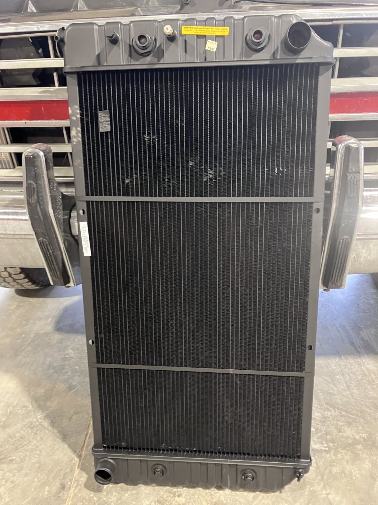

Took my 85 diesel rad with air to the local shop, full of holes. Ordered an exact replacement, brass copper, came to me from texas. They are out there but expensive, 700 bucks, (ouch), but it was exactly like the one I pulled so everything fit, still a PITA to install, took me 4 hours of struggling. My wife said it's so big...I told her thanks babe.
