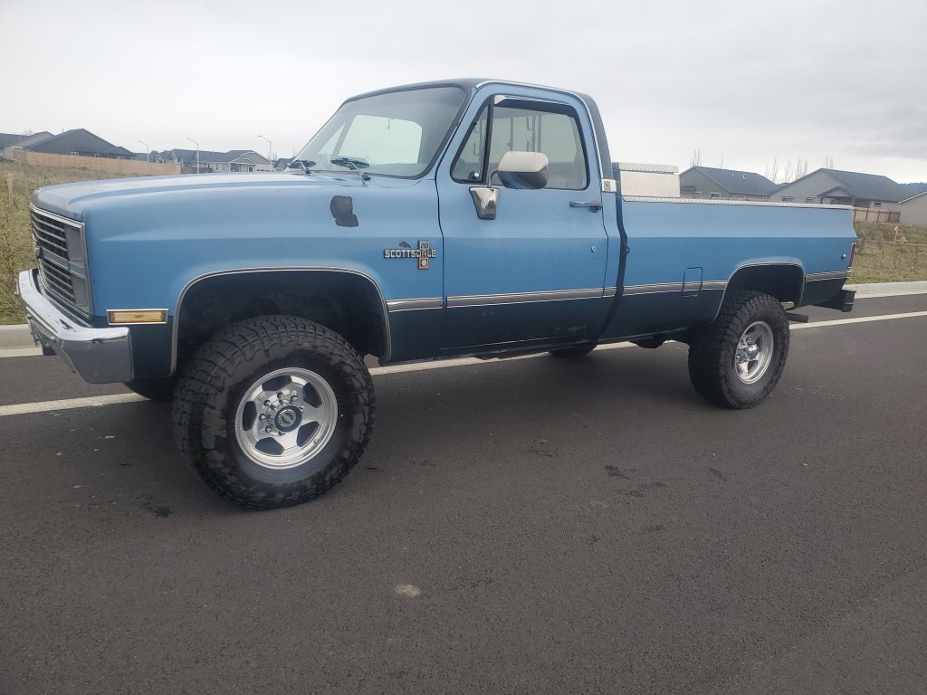

My 83 k20 has 305/70 r16s and is on a 2" lift. The front springs are either aftermarket or have been re-arched by one of the previous owners. I also have ORD's HD shackles up front which give it 3/4 inch more up front. I have not yet had any rubbing even offroad. But I'm sure its pretty close at some points when twisted up good.
I wouldn't try a 33 with complete stock suspension and any offroad use in its future, strictly street use might be fine. If it were mine, and I wasent going to change any suspension, I'd go with the 31 or even a 32 OD tire.
Edit: to answer your questions.
New front leaf springs will always be an improvement over clapped out/sagged out factory springs.
It is possible that you could change out only the front springs to level it out more, and add more tire. That way you wouldn't have to change the rear springs, add blocks, or a flip kit to match.

That's a good looking rig DR!
Thank you sir! Of course it was just washed in that picture.
Almost sold it a few months back TBH. Glad I didn't.
But now the trans is making some awful noise (I've been expecting it to) so that's going to need addressed this month or next.

Love your truck!... I think 307/70's are ... 35's right?
Thanks. They measure out to be 32.8 overall so a 33 just wider then a 285/75r16. When I bought these, I was trying to get the narrower 285s but the tire shop had these on hand and the 285s would have been a 4-8 week wait.
