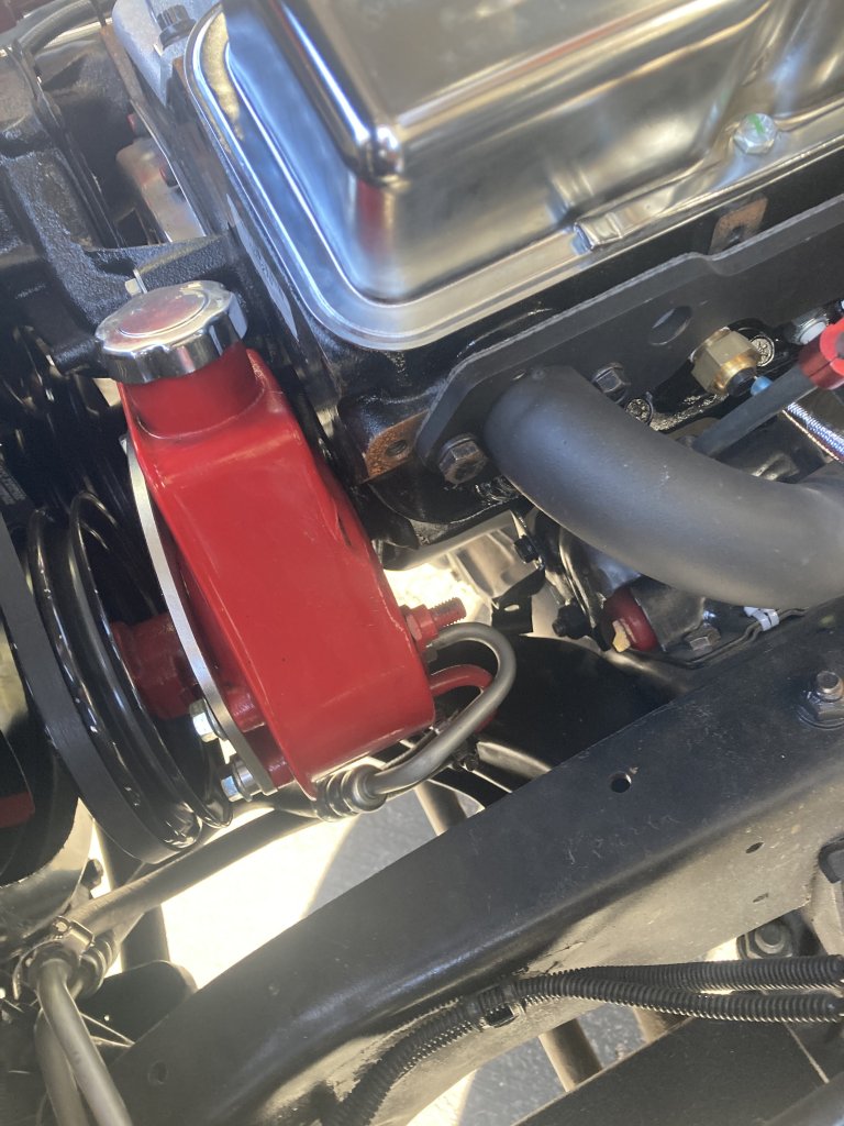

Hello everyone! Recent member and this is my first post! I need help though…I recently bought and installed a 355 from summit in my 1981 k10 Suburban got it tuned and all that good stuff but my concern is the power steering pump is being ripped away from the block and bending my new bracket which I’m sure won’t take long for the belt to fly off at the very least…who has a fix for this style of pump? It’s not a sawginaw pump it’s a new cardone one from Orielys with the stud on the far driver side. I’m planning on a temporary fix using 90* bent zinc or steel from Home Depot to bolt from the back of the pump to the header bolt?

There's supposed to be a secondary bracket behind the pump. But also since it's aftermarket it doesn't cradle the pump like the factory bracket. A/c brackets.

Every header brand I’ve seen listed with Summit has a footnote about a PS and/or A/C bracket that has to be purchased with it. Did you look at one of them to see if it’s what you need?

No I did not actually. They did send an alternator bracket with the headers but I didn’t need it. These are Hooker Headers if that helps

its a saginaw p pump, aftermarket block-only or head-only brackets will fix this and look nie

So I have the original brackets still I just didn’t want to have to go through the hassle of taking everything apart again and press off/on the pulley. Sounds like maybe I need to buy the sawginaw pump or put the original bracket back on though

you HAVE a saginaw pump??? Why would you need another? your brackets you got, what did they come from? youre missing half of it( just noticedy ou have the machined ones)

is that bracket for a type ii pump by chance

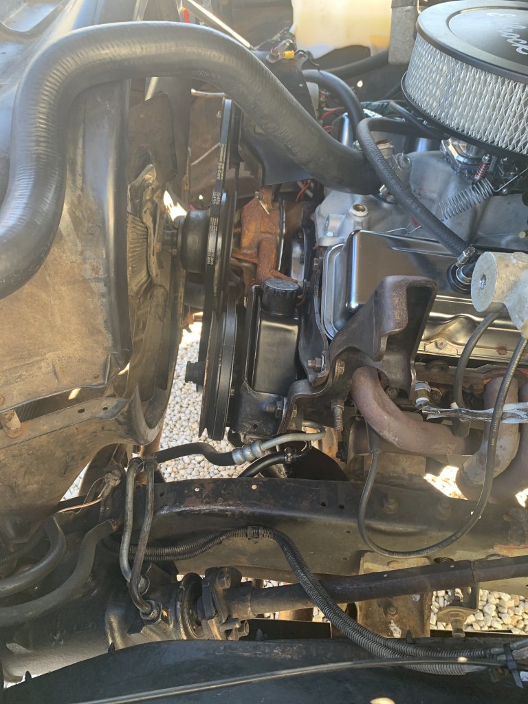

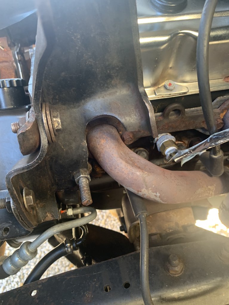

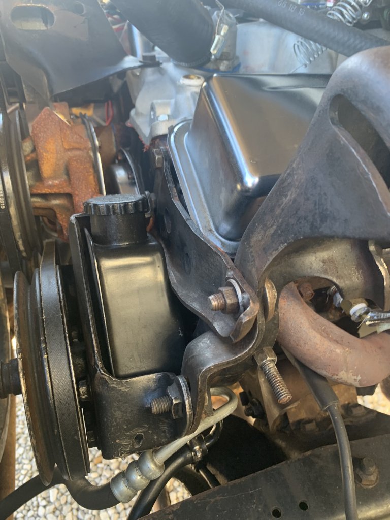

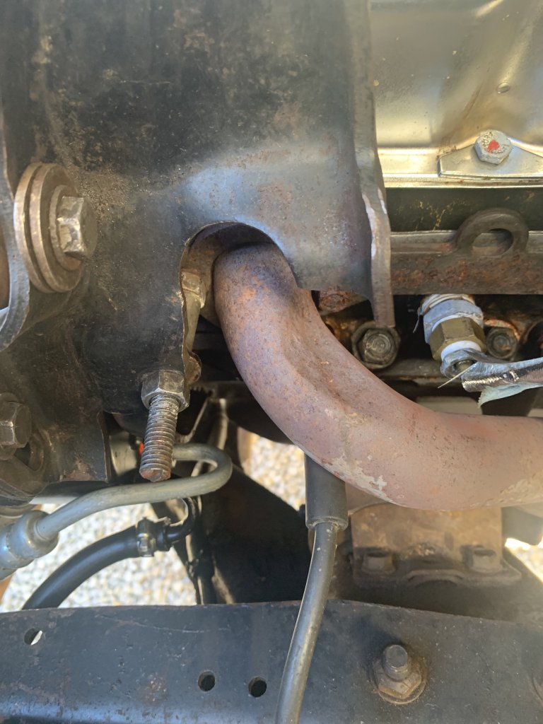

I used the original bracket I put a thread rod on it with a spacer and bolted it up

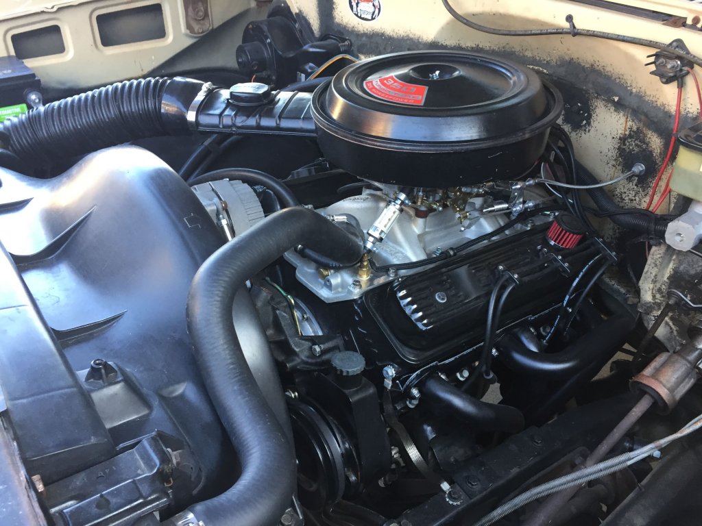

I used Alan Grove #402L brackets on my 82 C10. They worked great with cast iron manifolds and then headers. Neither came anywhere near the bracket or pump. I've used several Alan Grove brackets over the years. They aren't cheap, but are well-engineered and built in the USA.
#402L is near bottom of this page: https://www.alangrovecomponents.com/Small_Block_Long_Pump.htm
Instructions: https://www.alangrovecomponents.com/images/Instructions/402L.pdf
