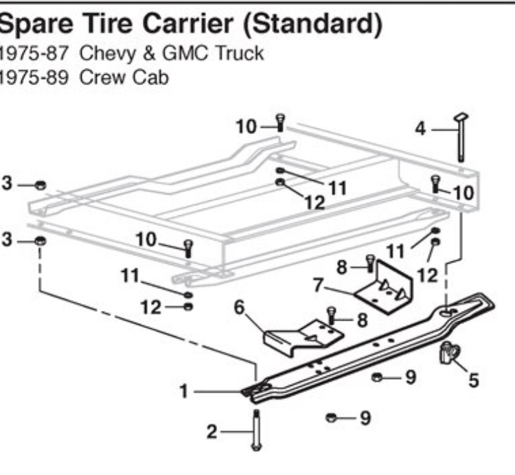

My spare tire holder was completely missing when I bought it. Does someone have a picture of which parts I need to order? Thanks in advance.

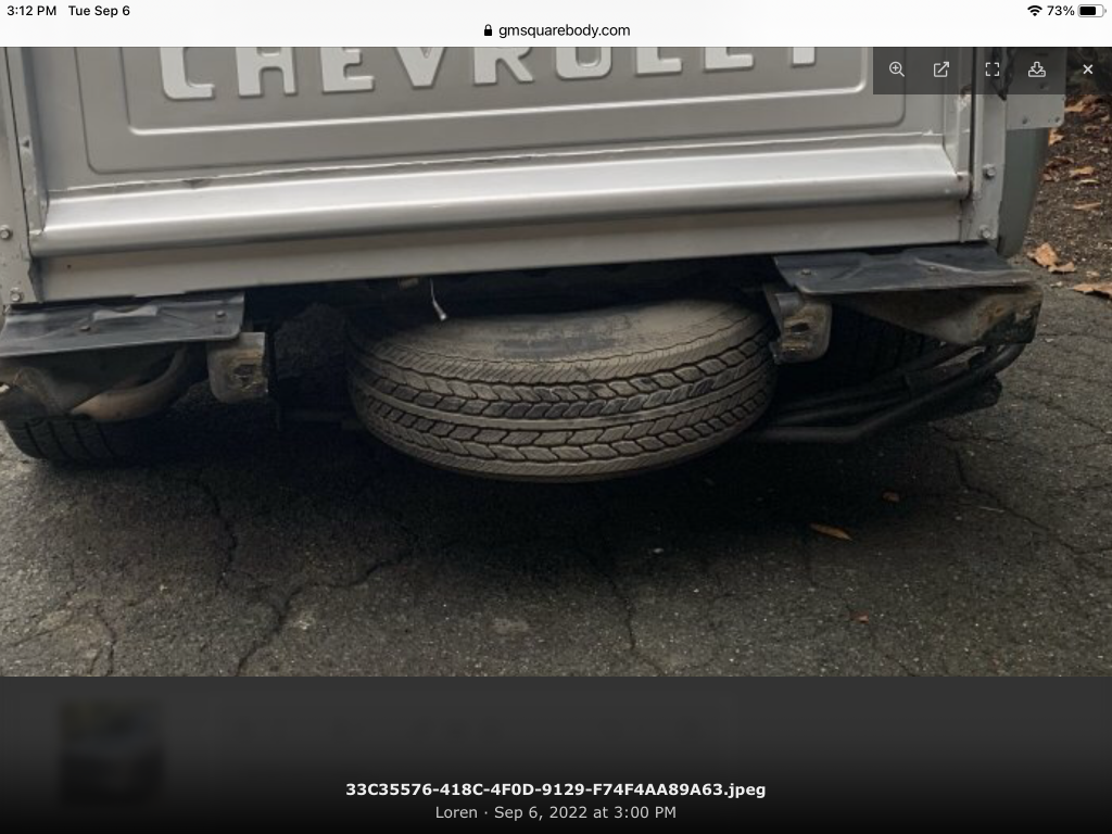

Or a glide-out carrier. LMC sells both.
Glide out on mine, off now, going back on?
haven’t painted yet

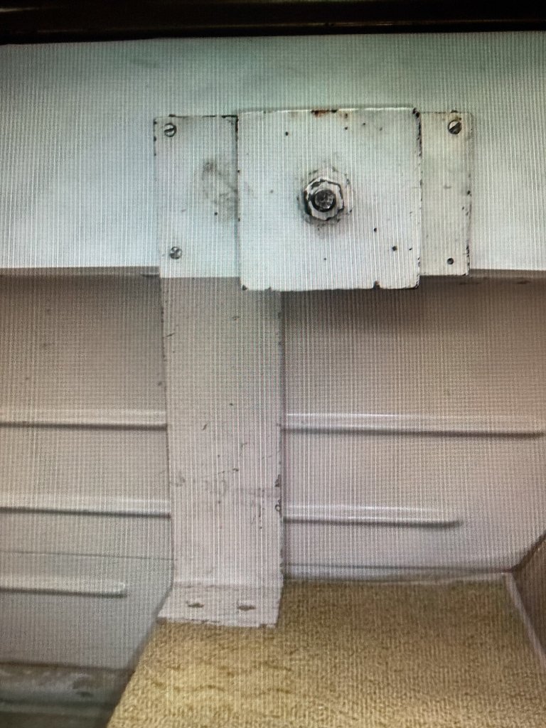

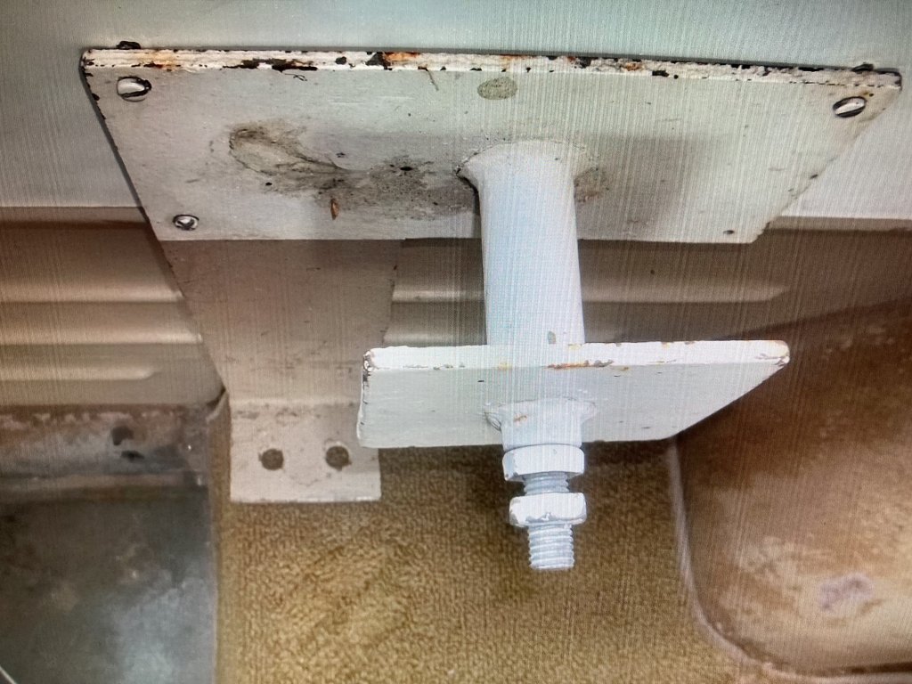

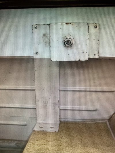

I used to have a 65 Suburban, which had an underbody carrier on it, but the original owner took it off and made this for it. Simple steel bracket with all thread that goes through the rim with a plate over the center hole.

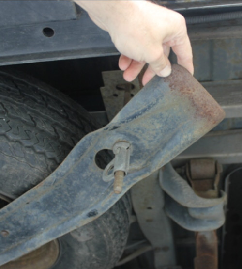

The stock under truck tire carrier works okay, but it’s an abomination that is a real PIA to use. I usually end up putting my spare onto a small floor jack to hold it up, so I can get it in to position and bolt the carrier arm back in place at the same time. My spare’s exact position is critical because it has to go straight up, and at the same time clear both the trailer hitch and dual exhausts.
