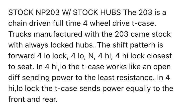

Starting at the dash going towards the seat. Low lock, Low, Nuetral, High, High lock. My '79 truck has a P/T kit with locking hubs. With that, High becomes 2wd High (normal driving) and Low becomes a 2wd Low.

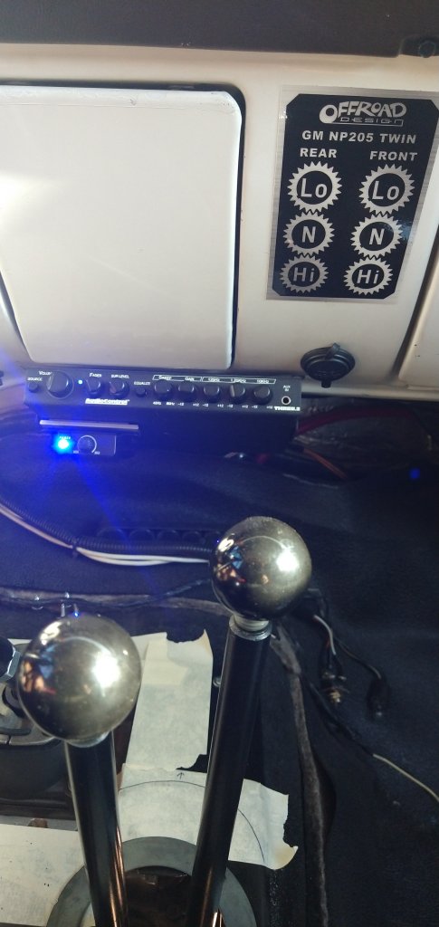

I even confuse myself if it has been a few months since I've driven it. I finally ordered shift knobs that have laser engravings showing what they do. Hopefully they are here tomorrow.

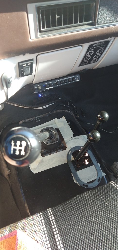

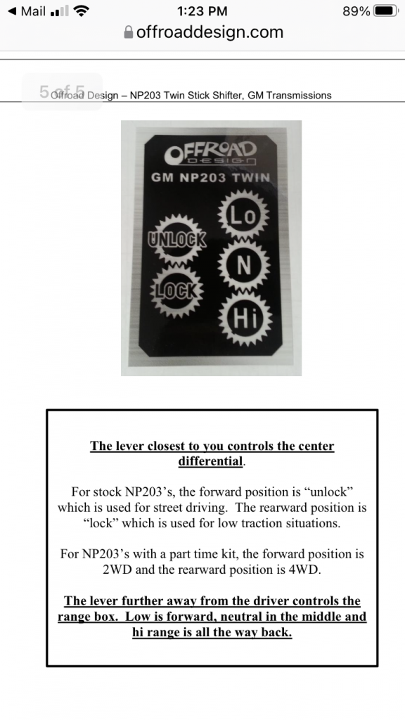

For the twin stick np203 which I have and is now not available from ORD any longer or temporarily

Sweet! I love shifting it. The triangulated bracket I made for it is dead solid and the shifter throw is only about and inch in either direction. I was driving it around the house in front wheel drive while I was waiting on my rear shaft.
Yeah, I hope they bring that kit back. It will be annoying to build my own setup, knowing that a kit used to exist and it was affordable too.
