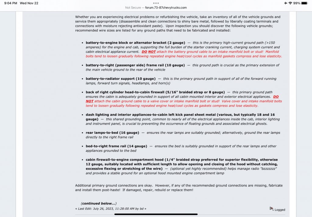

Have you checked all your grounds? Here is a list of the ones you need.
More critical than you might think… don’t ask us how we know…
