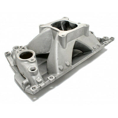

Hi, new here. I recently purchased an 85 GMC K1500. The 305 had issues so I took it out. A friend had an older 350 4 bolt main block and gave me a set of L31 vortec heads and a High Rise intake. He said that I'd need to get a larger cam or else it would be gutless on the lower end. It has an Edelbrock 1406, headers, and is manual transmission. I will be using it as a daily driver. I was a mechanic years ago and have build many SBC engines but nothing performance. Any advise on a cam that does not require modification would be greatly appreciated.

I believe it's the Pro Comp PCE147.1025.

Thats a lot of intake for a mild 350 build. Is it a single plane intake with a 3000 to 7000 rpm power band. :oops: Personally I would look for a cheap dual plane low rise intake for your build. Jeg's has a nice intake.

Yeah I think that's why he suggested a mild cam. So are there no cam's that'll make this work or is getting another intake my only option unless I want to modify the heads? If it won't work it won't work. I was just hoping to get a little more out of this motor without going overboard. I'll look at the intake too, do you have a model number or anything? So looking at these intakes I think I see what you're saying. The taller the intake it seems the higher the usable RPM range. So my guess is even with a larger can I wouldn't get much benefit from this intake under normal driving circumstances? If that is the case and I got the shorter intake, would a mild cam be beneficial? Like I say I'm just trying to get a little more from this engine but it will be my daily driver.

Like John said -- That manifold and those vortec heads will not play well together.. Vortech heads are designed for moderate lift low RPM "grunty" engines.. They run out of flow around 4,000 - 4500 RPM.. That Pro comp intake is just starting to "come on line" at that RPM.. Basically, you can have either, but not both..
That manifold is designed for high RPM high flow applications.. Cams that have miles of duration and skyscraper lifts.. Special high flow heads are a prerequisite.. Not to mention you'll need a very low ratio (high numerically numbered) differential.. With this combination, your truck will pass everything except a gas station...

That's what I needed to know. I'll look for a different intake. If I get a low rise intake should I just keep the stock camshaft? Hell yeah, come on I need a car guy out here. I just moved out here in 2019 and don't know anyone. I do woodworking, hunting and a little martial arts too if you're into that sort of thing.
