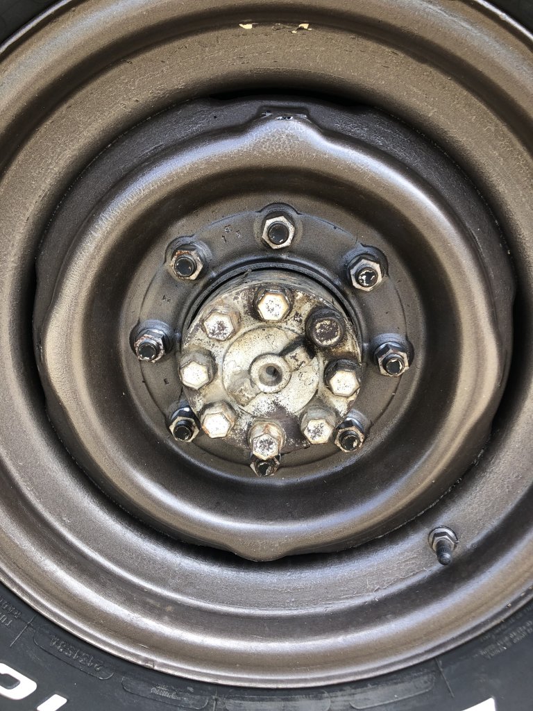

Full floating axles do not support the weight, the two bearings on each side of the hub are supported by the axle spindle.
Semi floating axles support the load with one bearing.
So if your full floating axle hub wobbles, it is a bearing problem, not an axle problem. Could be as simple a the bearing adjustment is too loose, or could be worn out parts. Early GM full floating axles used barrel bearings and both the inner and outer load from the inside. This could also be an issue if not assembled correctly.
Please post a picture of the rear wheel, hub cap removed.

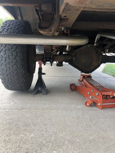

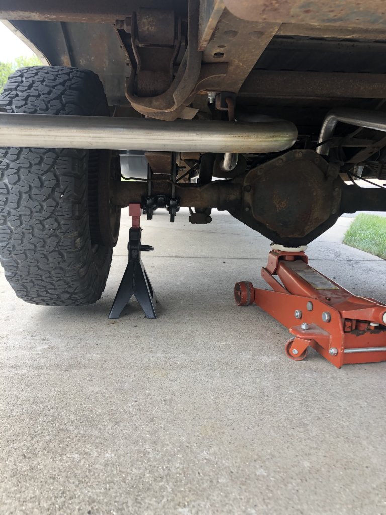

Video of left rear wobble.
Left rear wobbles, right rear barely.

Might just be my angle but it almost looks like that may be in the wheel or tire. Have you verified that it is in the drivetrain and not just a wheel/tire balance issue?

Looking at the drum spinning looks even. Yes I agree with Andrew, bent wheel or bad tire.
Looks like just the dust shield is mounted crooked on the yoke, non issue.

Answer to your first question, the axle is very easy to change on your full floater. Remove the 8 bolts and it slides out. To re-install, slide it in, rotate and push down to make the inside splines lift up to move into the differential side gear. This is not your issue.
I would remove the wheel and tire and have it spun balanced to see if it is bent rim or bad tire. While the wheel is off look to see if the hub mounting surface is flat or has a rust bump.

Update on this. Yes, it was a bent wheel. No more vibrations at 45 and 70 mph. Thank you guys for the replies.
