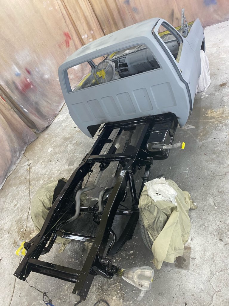

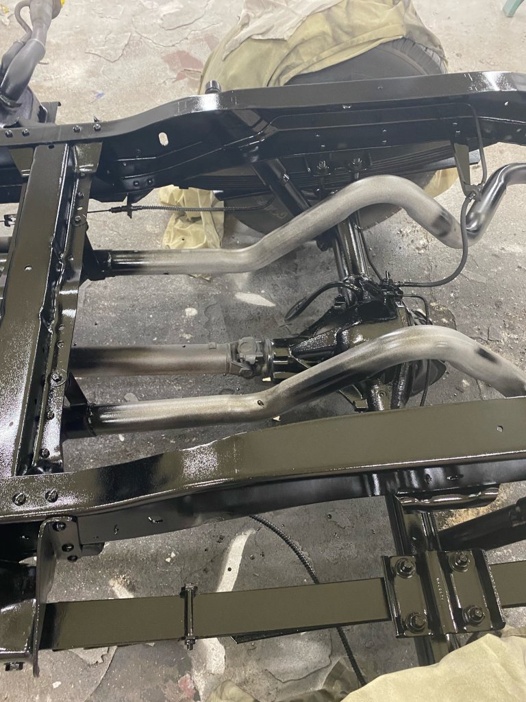

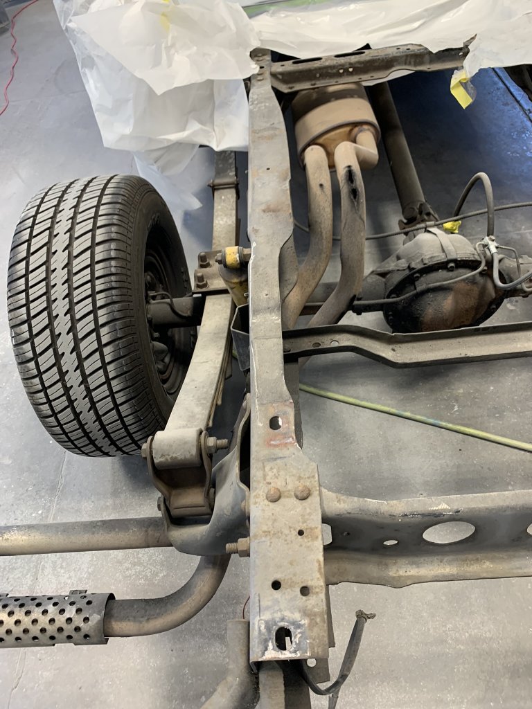

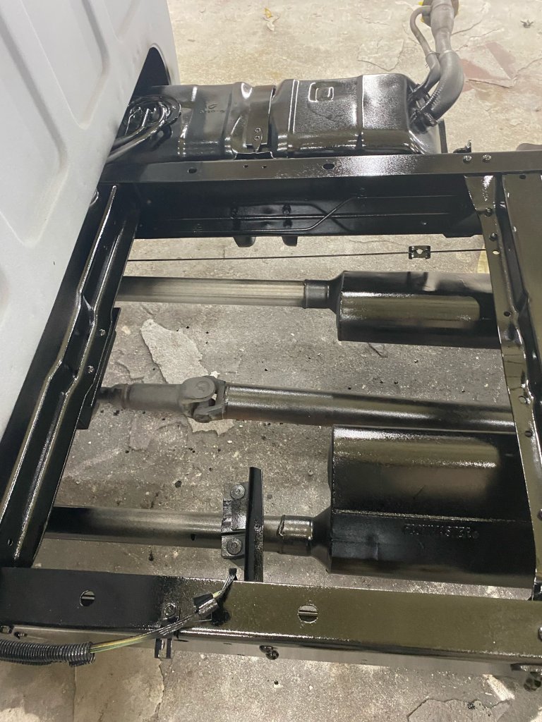

To me that sounds good. I love the idle sounds, my issue would be and especially because I have a smaller motor than you, hills are pulled at 3K with a loaded trailer. That's when it would get annoying, for me.My truck came to me with a falling apart muffler shop exhaust on it.
It was all 2-1/4" pipe with some cheap turbo style mufflers under it.
After one of the muffler fell off whilst driving, we decided to whip up a temp exhaust with things we have laying around.
We started with a set of Flowmaster Delta Flow 40's that turned out to be too quiet for our tastes.
Currently on my truck we have a set of Jones Flow Pack mufflers.
They are 2-1/2" and a single chamber straight through design.
Simple, cheap, and effective.
They were $25 each when I bought them and work quiet well.
The truck is fairly quiet at an idle and you can just barely tell it has a little cam in it. When you jump on the gas it lets you know.
Currently it just dumps in front of the axle with 45 degree bends that send the spent exhaust towards the ground in front of the tire.
This clip is while we still had the stock exhaust manifolds on the engine.
Now we have headers on the engine and it sounds even better.
Soon we will be switching it up again for the forever exhaust with 3 inch pipe all the way from headers to tailpipes. The mufflers I choose will more than likely be the original Flowmaster 40 series mufflers after the Magnaflow Cats I have to install. We are going to be using fancy V bands so we can take it apart easily...
I'd love to see the angle back and out. Typically guys doing before rear tire exit just do a 90 degree and straight out the side. I actually think there is something to this as far as old school low cost exhaust looks are concerned, but I think if a guy angles the exit towards the rear, or even the ground that would be better than straight out as far as noise in the cab is concerned.
Side note thanks for the fun conversation guys I've been really enjoying talking exhaust. Kind of makes me want to pull my single setup just to try experiment with other combos.
