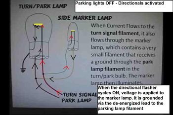

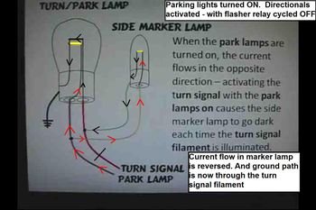

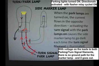

First thing I would do is check your driver side front turn/park light (the one facing forward). Make sure it's not burnt out and it is the correct bulb. Also make sure the socket is grounded. That bulb has two filaments. The side marker lamp grounds through one of it's filaments.
The side marker lamps flow current in different directions depending if your park lights are on or off.

Just a side note. When the bulb with two filaments go bad (or it is not the correct bulb) it can cause a lot of strange problems. Especially when the two filaments are touching. If I remember correctly the bulb should be 1157
