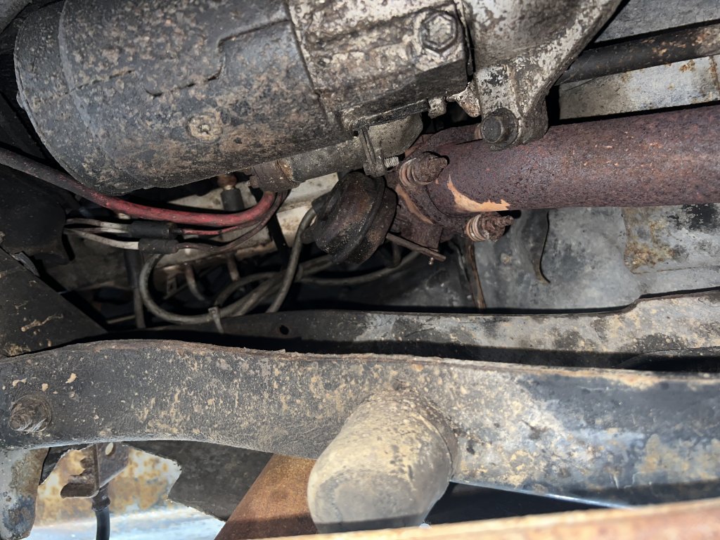

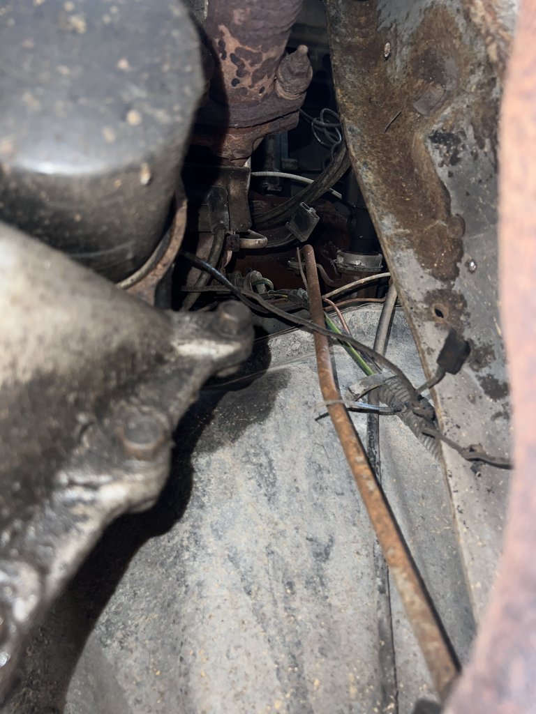

So I finally noticed some leaking from the truck, since I have driven it a little more and found that it is leaking at the shifter seal. Upon poking around down there a little more, i have a few questions I could use some help with.

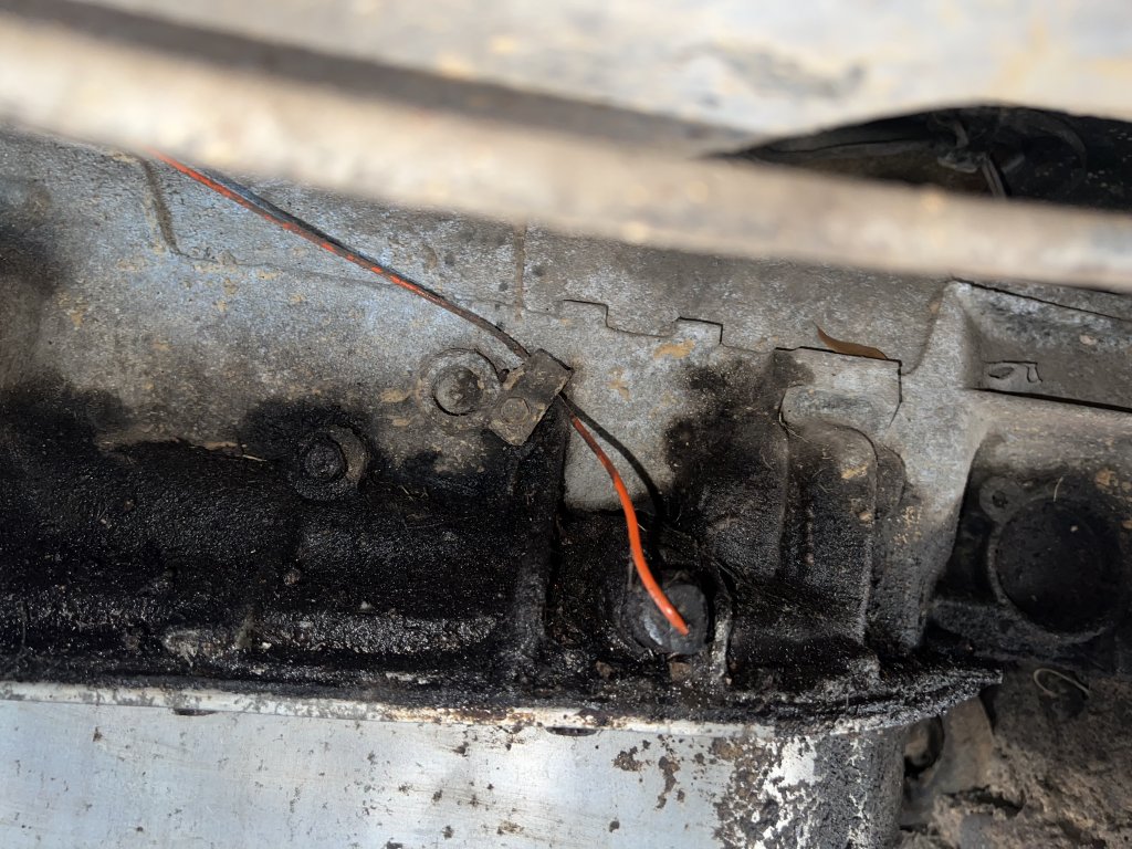

Is the single orange wire with a female connector on driver side the lock up switch?
On passenger side I see trans cooler lines and vacuum actuator before thst, but no “kick down” cable. I’d like to add it back, but I don’t see where to connect it.
I guess now I know why the Speedo isnt working as it isn’t connected, but it’s so long that it goes past transfer case, so I’m assuming it’s wrong one, but I don’t see where to connect that either. Supposed to be driver side near tail shaft?

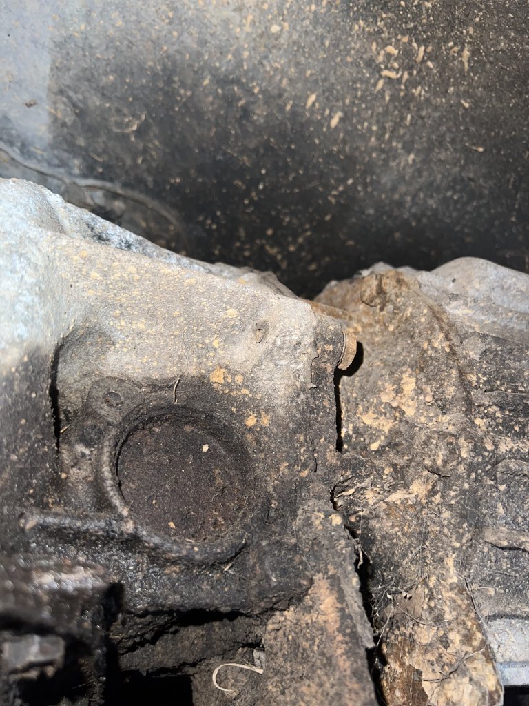

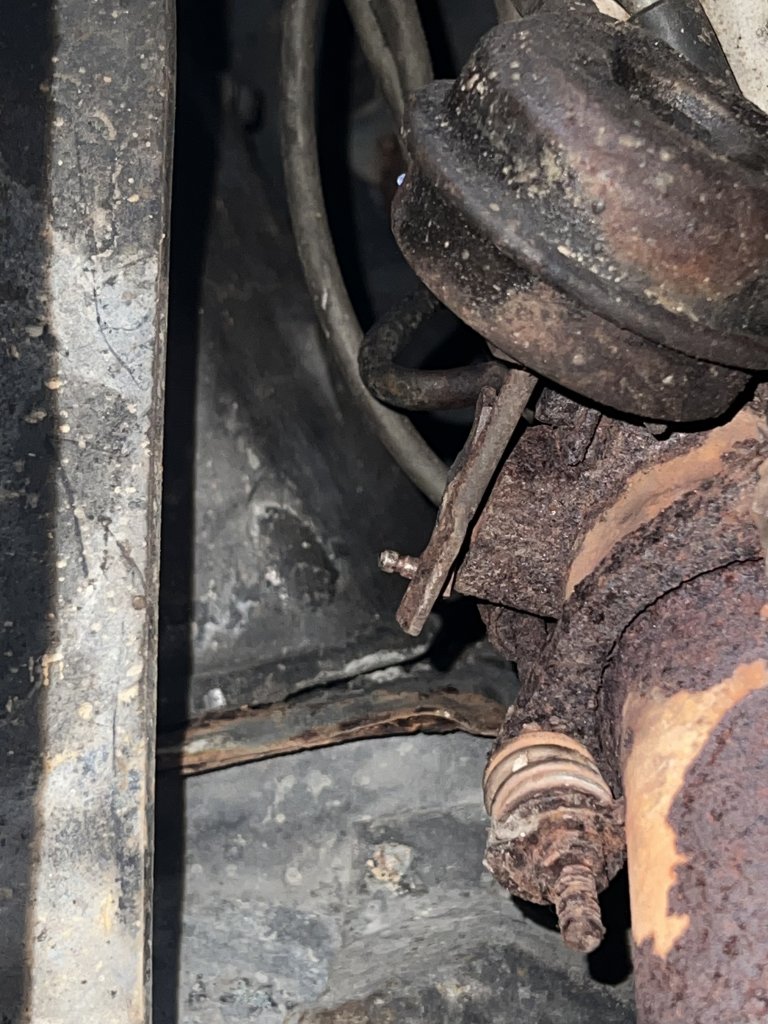

What is the solenoid looking thing there by starter and manifold? Something to do with EGR? I'm assuming that is why it isn't connected to that little piece above it?
The last pic of of driver side of a couple of connectors that I see are not connected & I have no idea what they are for, so I would like to get them reconnected.
Thanks for your help!

The 3rd and 4th photo appears to be a EFE valve - early fuel evaporation in emissions speak. It was spring loaded open if the design is the same as my 1980 and pulled closed by a Thermal Vaccum Switch- TVS - on start up.
It let exhaust gases go thru the intake manifold to help preheat the fuel mix.

I see, so it isn't needed. I mean, I didn't think it was, since it has been driving. How do I tell if the lock up switch is working? just a bolt meter, or? When I did get it on the highway it did seem like it was revving pretty high, even at just 55mph, but I guess that's normal for a three speed?
I don't know how to tell which transfer case I have, but maybe its in the same location.
Any idea on the last photo? I just wonder what those two connectors could be for.

I cannot tell on the phots. Looks like you are under the driver's side looking up. Cam you see the 2 prong connector from under the hood?
I am wondering if it is maybe for the cruise module.

Hi Dan,
The small wire going to the transmission's case connector is for the detent solenoid. Th400s dont use a purely mechanical kick down system like the TH350; the detent system is "electro-hydraulic" in that it uses a solenoid to perform the same function as a kick down cable and corresponding valve. The th400 has a valve train in the valve body with two valves: detent and detent regulator. They work with the detent solenoid to help manage downshifts.

Nope, that's the vacuum modulator. Not a solenoid. Your pan looks like this?
This is a TH350 Pan.
This is a TH400 Pan
I'm 100% positive those pictures show a TH400.

that flap by the manifold is the EFE as goldiue said :)
