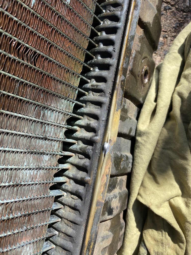

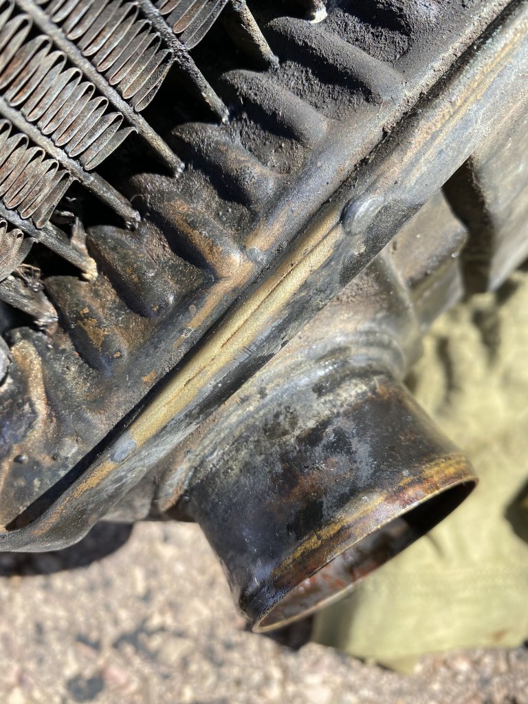

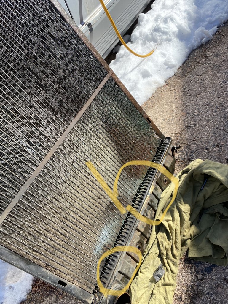

Ok so I topped off the coolant the other day, let it run for a while and looked for bubbles, didn’t see any, so took it for a drive. It started hissing coolant after a couple of miles. Limped it home and pulled the shroud since it appeared to be leaking behind it. Finally saw where it is leaking. Too damm cold to work on it so let it sit.
Pulled the radiator today and found the problem, a crack or two where the tanks mount. They appear to have been fixed at one time, but either cracked more, or whoever fixed it didn’t do a very good job. Can I just solder these, should I stop drill them, or is it not worth repairing?

If it was mine I'd get out the steel wool, 60/40 solder, some flux and a propane torch.

I have soldered one or two of them. Acid core solder and good flux + clean and bright. Don't get it to hot

I never drilled them.
