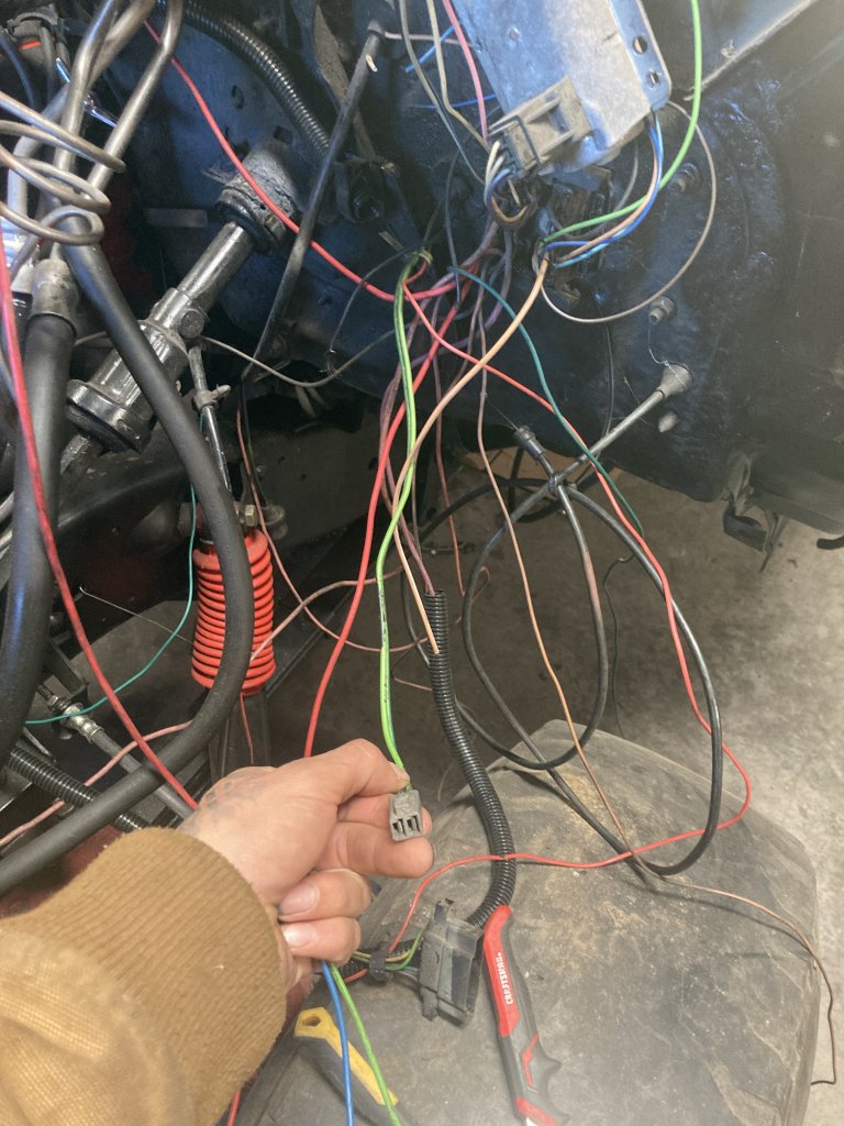

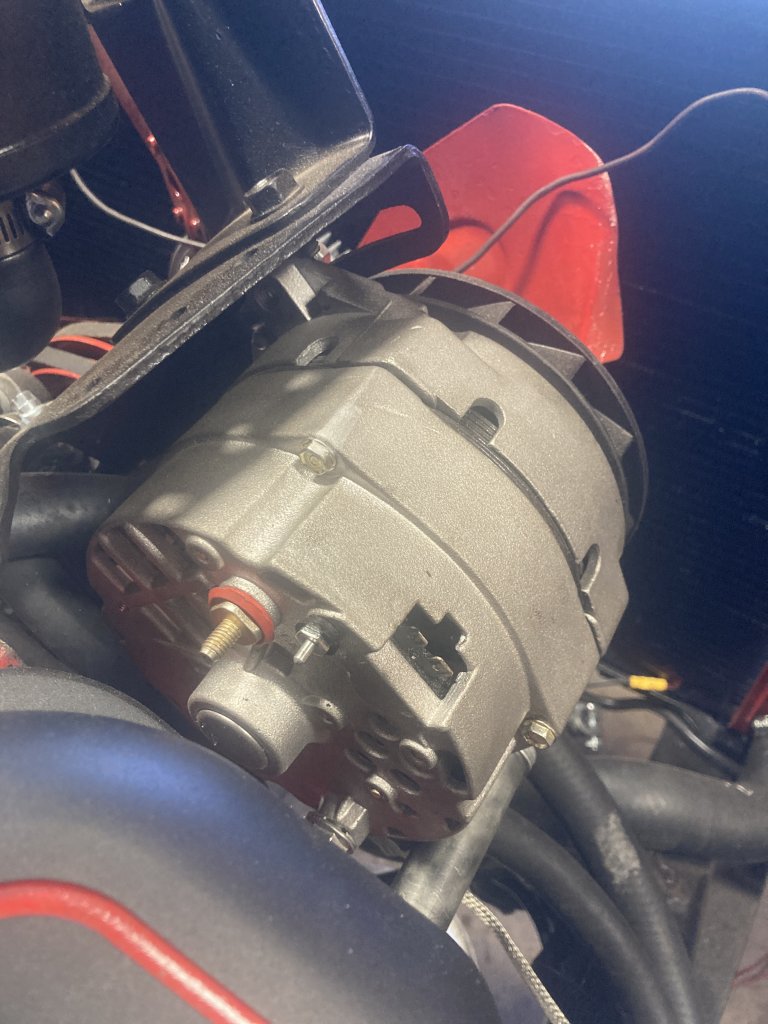

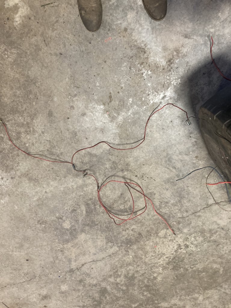

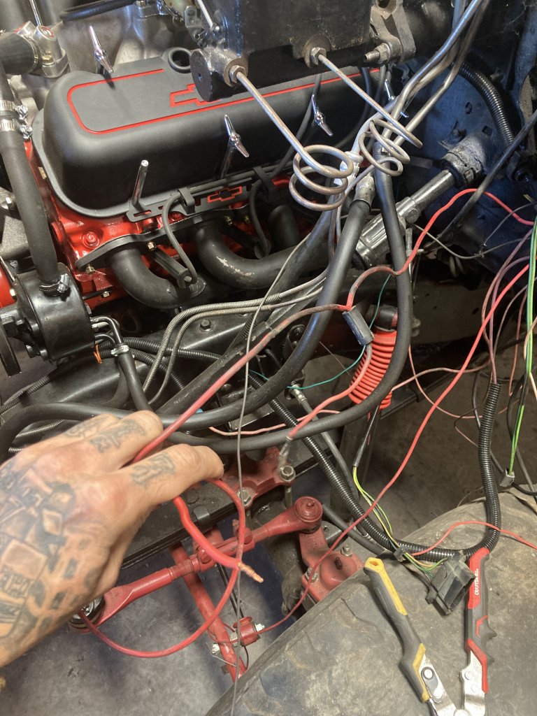

I have a few questions about my wiring on my 1984 k30. On my alternator wire do I go from after the starter. Like where do the fused links go between. And also do I need an excite wire??idfk know what that even is just saw something about it.something like a one way wire or some bs also what the frick is this blue and green guy. And which one of these wires is my oil pressure sensor I included some pics. Thanks in advance bros

open the 84 wiring diagram and start tracing wires...

The dual green wire connector you are holding goes to the AC compressor.
I never took one out ? Weird guess it just has the wiring for one in case because it could have been an option?

OP looks like he has a crate engine or an Engine that is extremely Dolled up, possibly a swap of some kind. Can you confirm what alternator is mounted on your trucks engine? Nothing wrong with your engine, I think its awesome, I just wonder if you maybe arent using a 10si or 12si alternator and instead have a CS130 on. Your truck would be OE wired for a 10 or 12si

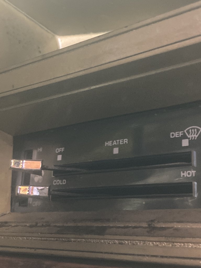

Your truck originally came with this engine? is your heater control say AC on it or does it have manual AC looks/form to it?
if either the one on the left is in there, or there are other things in the truck to suggest it had AC(hows your dash for vents? one on the left of the driver?) then your truck originally had an AC system and your engine would have had an R4(Probably?) pancake unless the A6 or whatever was used then. Your engine probably had them on the driver side, my guess, but it all depends on the trucks original setup. Do you have your SPID label?
It’s a crate 454 it was cheaper for me to buy a crate then send mine to the machine shop.
It is an extremely dolled up crate motor. My goal was to have the outside look rustic and under the hood and interior look pretty. Cause all in all it’s still a big ol man toy and as far as the alternator can you school me a little more I’m not quite picking up what your putting down. Pardon my ignorance
No mine looks like this . Sorry for the bad angle it is on a lift and I can’t really reach .
