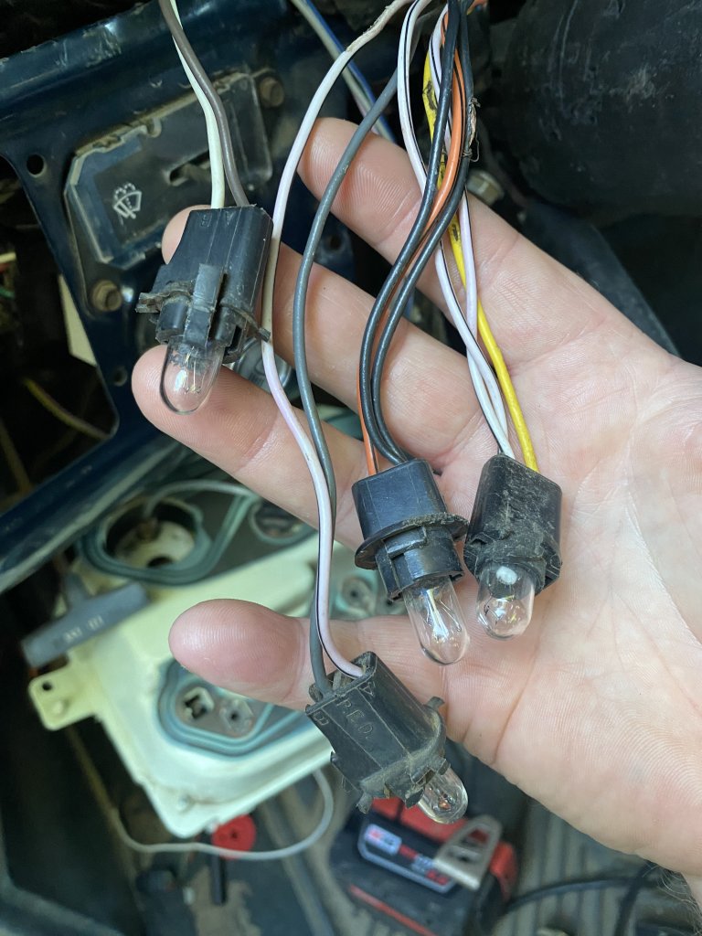

Question for everyone. Would anyone know what these indicator lights go to? It was originally a diesel so assuming one goes to water in fuel warning light and glow plug warning light. And assuming two go to indicator lights. Any help would be greatly appreciated.

Could also be wait to start light / oil pressure light etc

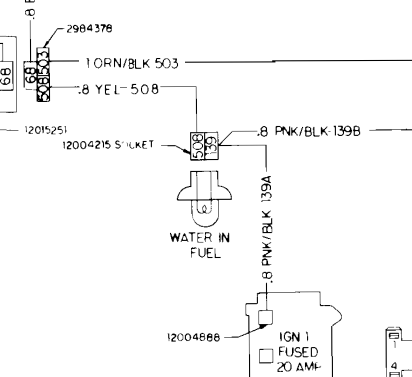

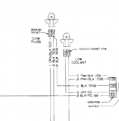

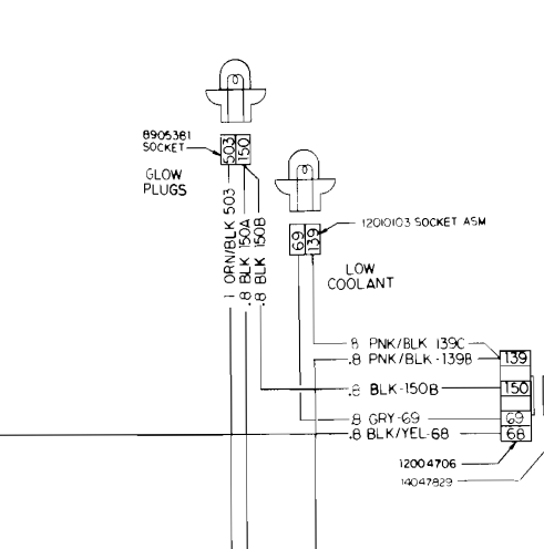

ORN/BLK, BLK, BLK = glow plugs
YEL, PNK/BLK, PNK/BLK = water in fuel
PNK/BLK, GRY = low coolant
