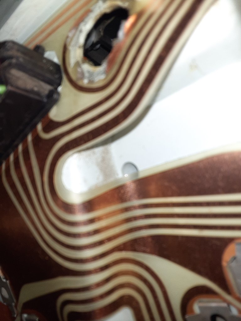

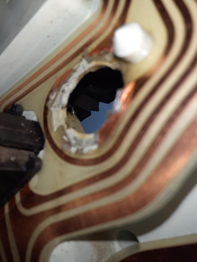

And, the big reveal:
I was right.
Crapo pics because the cluster is still in the truck, but that destroyed trace powers the high beam indicator as well.

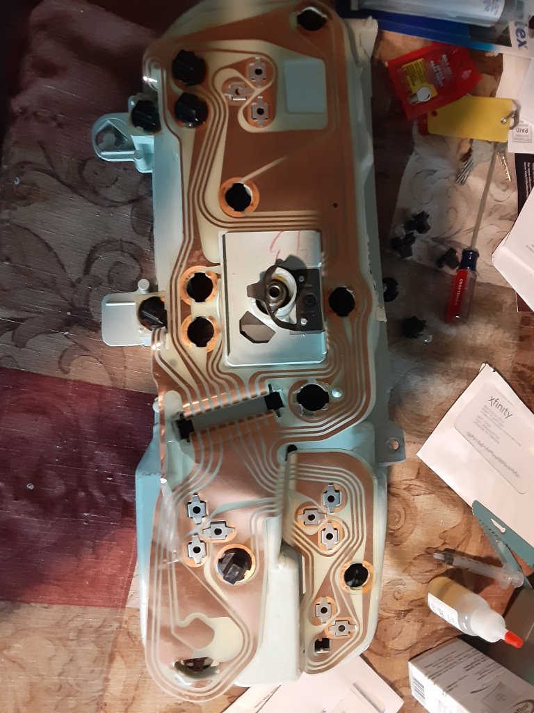

Baby steps - cluster out, disassembled, circuit board replaced, and back together.
Interesting thing- the voltmeter has 3 studs but only 2 are used.
Look at the pic of the housing - you only see 2 clips on the left hand side.
Oh, yeah- I wondered if you could pull the clips out from the back side without taking the cluster apart.
I did not go crazy in the attempt, but my answer is no.
And, after putting new bulb holders in where the old fit loose, I wound up changing a few out with the old to get them to work.
Weird.
And, a little silicone action on a few of them.

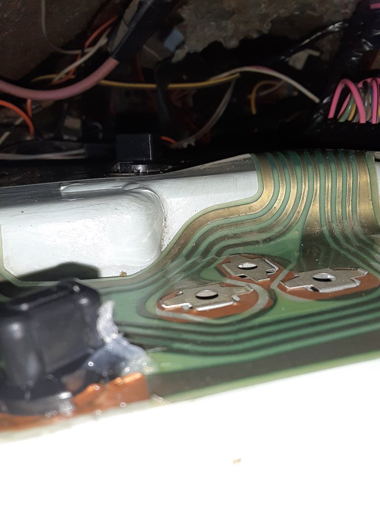

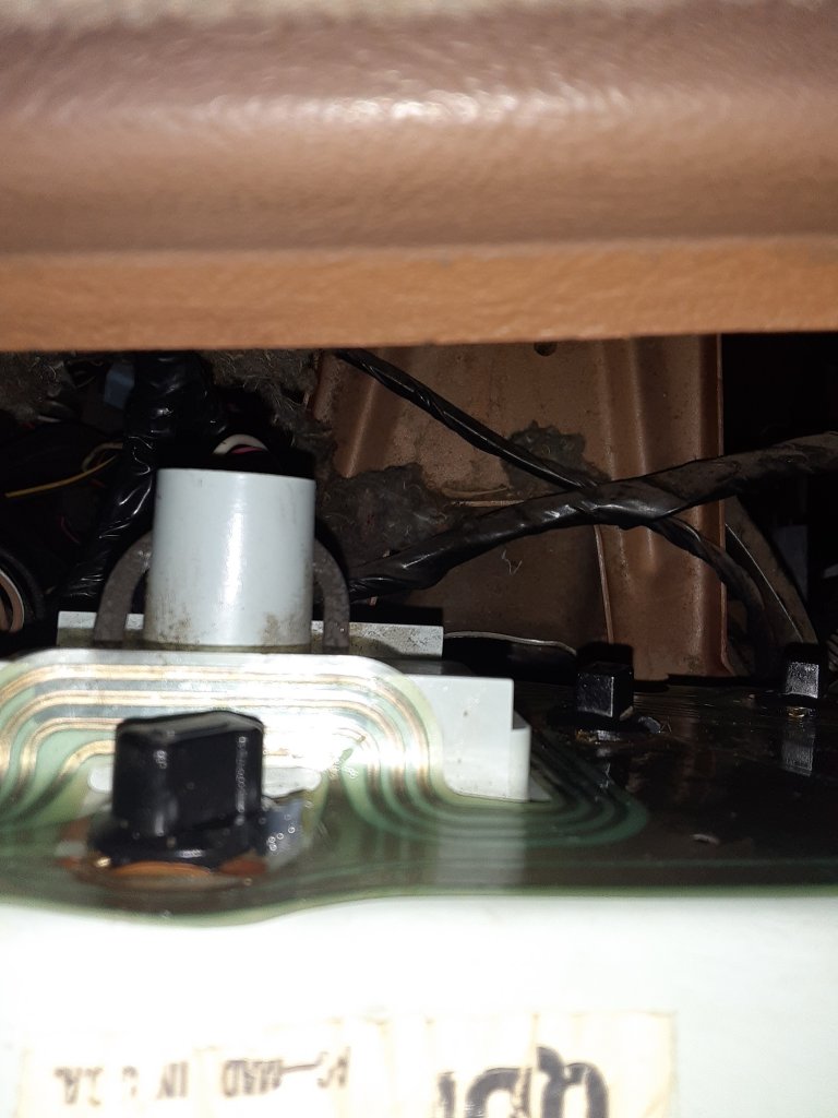

Ultimately, the answer to will it work is we will see.
One thing one the silicone, or shoe goo, trick that I should have done differently was to put the silicone in the holes where the bulb holders go or on the holders themselves. I put the cluster in last night and 2 bulbs were acting up.
Decided there was no way I went through all this for that outcome and back out it came - well, out of the hole in the dash but resting on the column - for some more silicone.
Seems like the same damn LH speedo bulb as before plus the high beam indicator were the biznitches.
Back in tonight, bent the shift indicator housing back to good enough, checked the bulbs after installing- still working- and put the radio back in the cluster- yeah, that's right - crap as s aftermarket stereo bs - and all that is left is bezel screws and the lower column cover.
