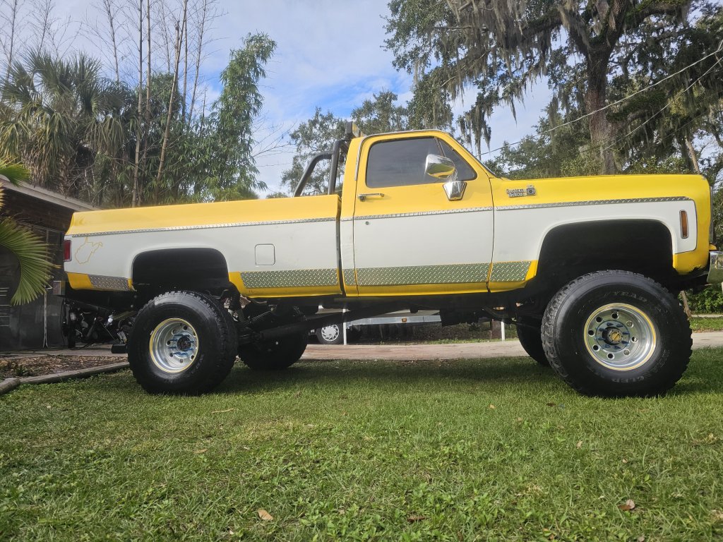

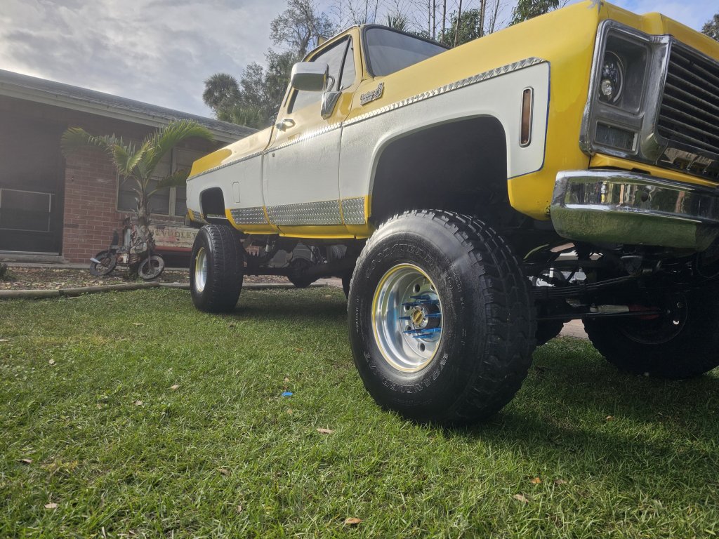

What up guys? Quick question.
I live in Daytona Beach and I'm planning on running the old girl down to the beach tomorrow for some pics since she's done(for now), and of course a little playing and testing.
I was wondering what to expect out of these Goodyear Wrangler 37x12.50x16.5s on the sand and anyone able to recommend PSI?
Thanks so much in advance

No experience with that tire on sand, but just about any tire on sand likes to be under-inflated. If you have a way to air down when hitting the sand, then airing back up for the street, do it. I don't know how heavy the sidewalls are on those Wranglers, but I'd imagine they're pretty good, being Military issue. What I'm getting at there is that you should be able to run a pretty low pressure in the tire, and it not damage the sidewall. This will give you a much better footprint in the sand.
EDIT: Truck's looking good by the way.
29,221
24,372
They should perform just fine. I wouldn't air down too much though, being 16.5's and the rims aren't exactly narrow. 15 psi or more should be plenty safe.
