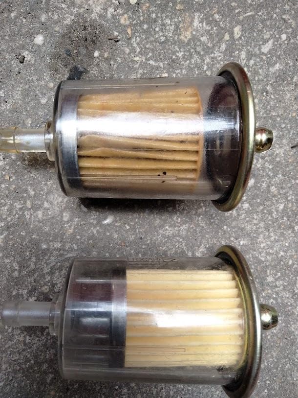

and then there's the clear Chinese fuel filters that come apart internally allowing debris and bypass and then block flow with the detached cartridge.
