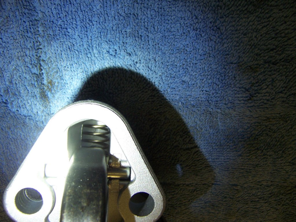

AC Delco or Delphi. Many brands do not have the return spring [pictured] inside and fail. Ask me how I know.

Thanks for the info. I'm headed into town this morning to pick up a Delphi brand one. I didn't see any AC Delco ones for sale.
