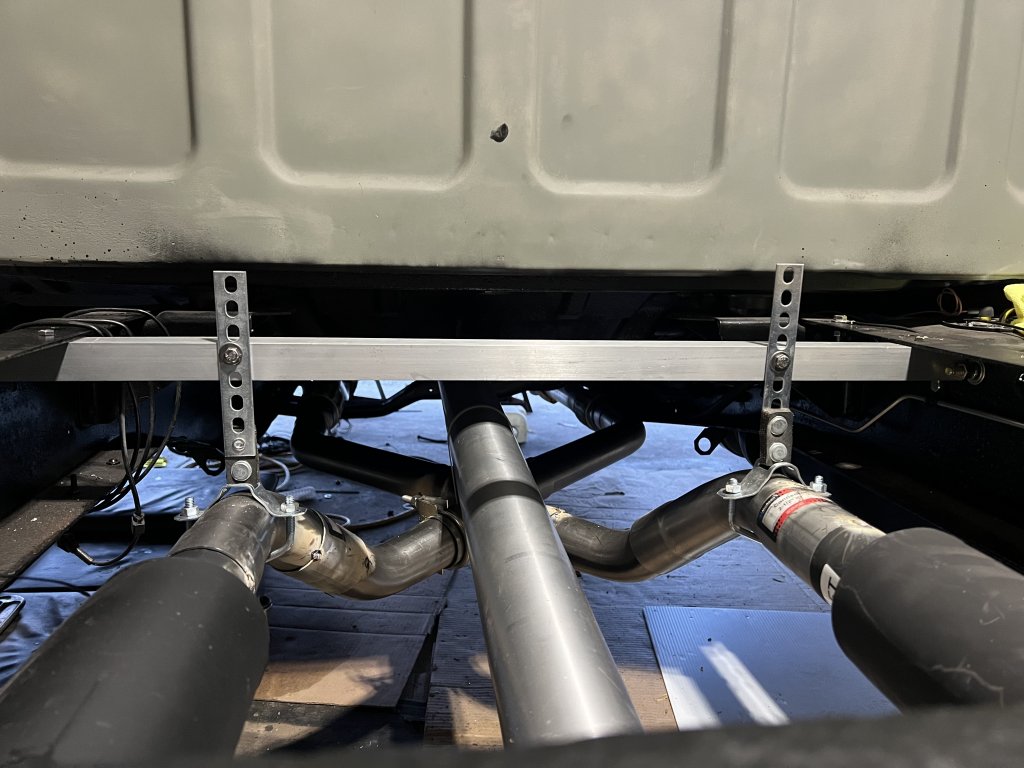

Instead of welding in brackets/hangers, I decided to run an aluminum angle from one side to the other and bolt my hangers to that. I’ll trim the hangers down.
Does anyone see an issue with that?

I have a similar bracket setup at the front of my mufflers but used HD angle iron with pre-punched holes. It’s not that attractive, but it works.
