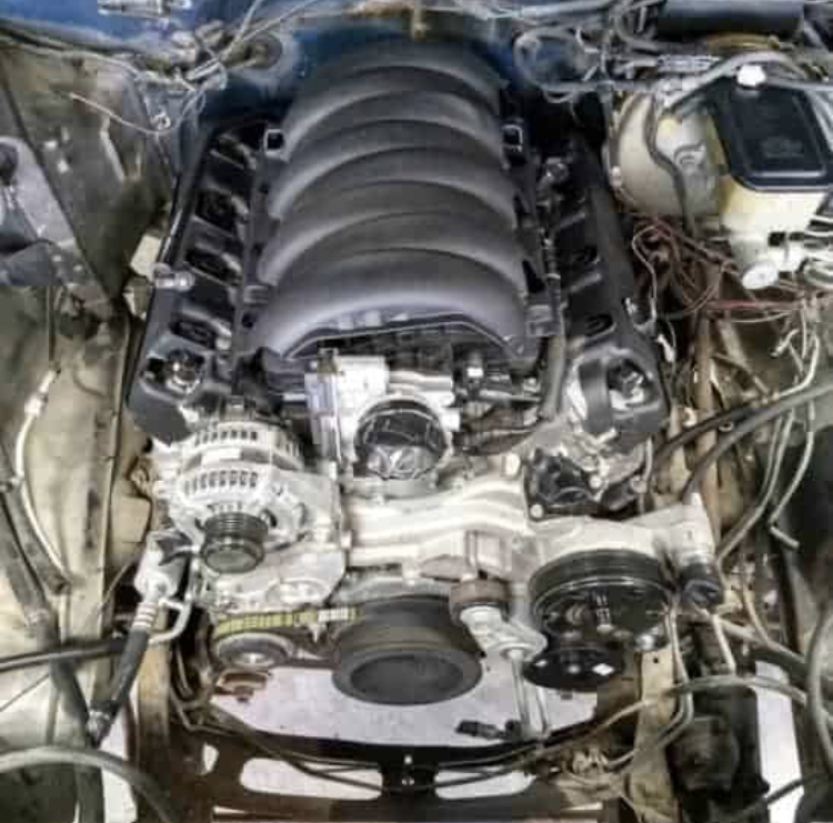

Install seems pretty straightforward, I found a bracket kit for engine, trans and power steering mounts. From what I see it’s a bit close to the master cylinder but not an issue for me since I’ll retain the hydro boost.
I’d love to keep the 454 but I want fuel injection, I’m not interested in TBI and I don’t see good reliability with the aftermarket stuff. So that leaves finding a vortex 7400 donor. All said and done I’m looking at $10k-$12k no matter what I do. So the L8T keeps coming out on top.
My truck is a camper special so 10,000lb gvwr and has 17,000lb gcwr and I’d like to have a drive train that’s built for that, the 6.0/6l90e with 4.10 was rated at that but L8T is over that with 3.42 gears.
So I’ll be switching the rear end to 3.73 maybe even go down to 3.54 (Dana 70).

I got my donor 97 K2500 Suburban for $500. Running and driving. The interior was completely shot and the suspension was falling apart, but I drove it home and parked it to strip it for the swap. I probably made ~$1000 in selling the parts I didn't need back on it. Rebuild prices for engine/trans is pretty accurate. You can do an 0411 swap to run the L29 and can basically tune it for free if you have a tool that can communicate. I use the OBDxPro VT, but there are others for cheaper. Its $100 for the HP Tuners credits, or ~$60 for a wireless/BTE tool, or like ~$15-20 for a wired tool to communicate. Tuning tools are free at that point. You can read/write with PCM Hammer or LS Droid and tune with TunerPro RT or Universal Patcher.
I also got an L9H and matching 6L80 with the E38 ECU and harness about 6 weeks ago locally for $1500. Trans is toast(that's why it was being sold), but engine was in great shape. I pulled it down anyways for the cam/valvetrain upgrade and decided to have it cleaned up at the machine shop and checked out with the heads getting a full rebuild and once over. I'll be in the L9H for about 5k when all is said and done, but as the dyno sheet shows that I attached in your other thread, its good for about 550hp and 505ft-lbs of torque, with more than 400ft-lbs being made everywhere from 2k RPM up. Tuning for the E38 is just the standard 2 credits on HP tuners.

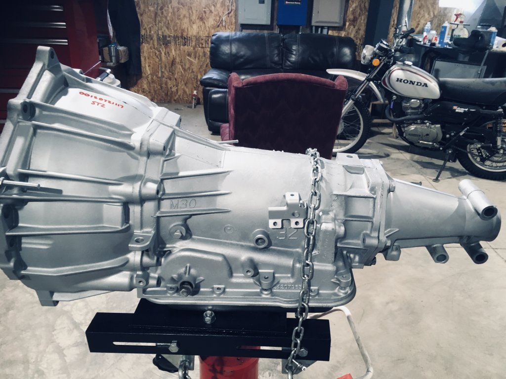

I have the combo in our 2018 GMC, great combo, hwy steady 13.5 towing around 8-9.5 mpg. Also have a lq4 W/ 4l80e, 115000 miles, runs good 1500 in Portland Or. my 454 with a 4l80e is a great combo as well, $3000 bucks. My other 4l80e trans from a box van, 500 bucks Seattle area. I think you are paying way to much.
