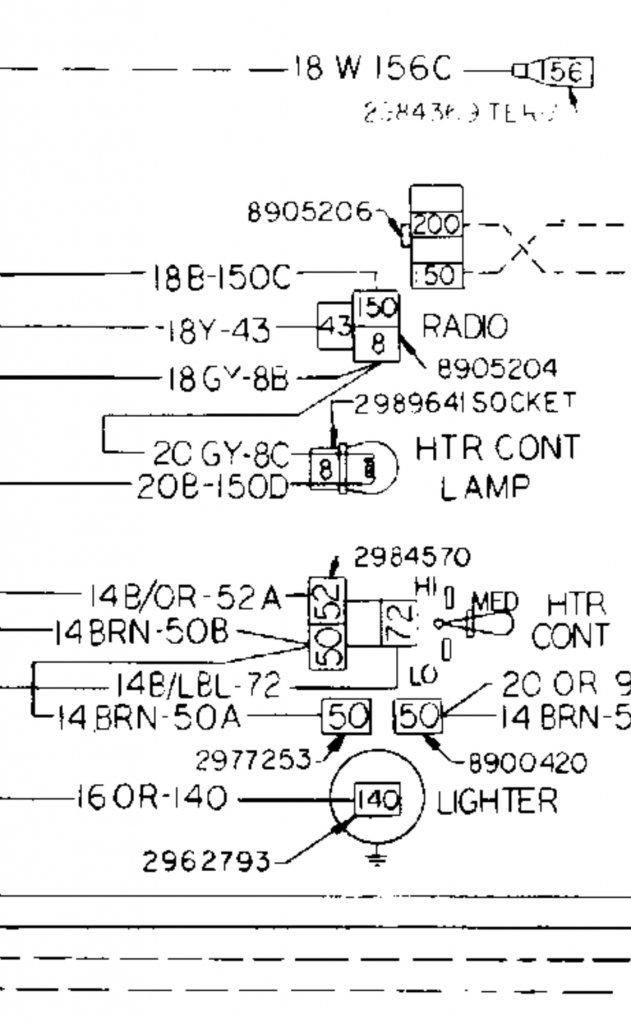

I’ve had this issue for a while and now it’s bugging me, I know what the cause is but don’t know how to fix it. I put a RetroSound radio in my truck a few months ago and since then I haven’t had dash lights, I know its back feeding power and blowing the fuse, I just pulled the fuse out for my dash lights so I don’t keep blowing the fuse. Now the RetroSound radio requires constant power and keyed power, but only has one power wire in its harness. My question is what’s the best way to correct this so I have dash lights but still have my radio

The dash light fuse isn't blowing because of "back feed".. It's blowing because it's wiring is not heavy enough to carry the current of the lights AND a radio.. There is a receptacle on the fuse box marked "Radio". That's where your radio can receive key on power. The constant power needed for the radio can be had on the cigarette lighter plug or courtesy light plug or the dome light plug. Stop guessing at which wires on the radio do what.. This information should be in the installation instructions.

Truck yellow changes to retro red- switched power.
Truck orange to retro yellow (with fuse) is batt- always on. (Most people splice to orange wire going to cigarette lighter.
Truck grey is not used- it is for back illumination that retro doesn’t have
Black is ground.

2 gray wires- look at the diagram in post #7. If you cut the connector off (or someone else did) I would guess one gray wire continued on to the lamp. GY=gray. Y=yellow B=black
Example of reading diagram
18 GY -150C
(Wire size) (Color) (-Circuit)
I’m not 100% sure, but fairly certain you can still splice into the cigarette wire- the radio shouldn’t draw a lot of amps just to keep memory.
Retro black ought to be connected to truck black - ground.
