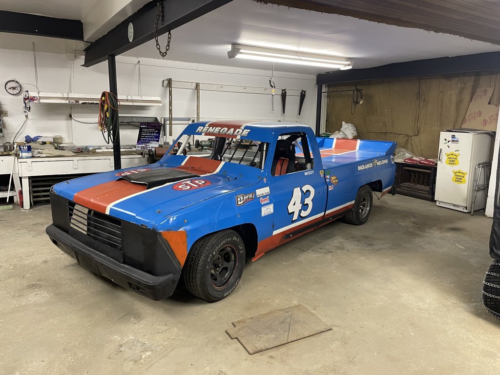

Thanks for the reply. It is a 84, its a race truck that is being converted from auto to manual with hydraulic clutch. Peddle assembly is already in just need to mount cylinder with rods, there are no dimples as most the firewall has been smoothed previously. Was hoping someone had the measurement so I could grab the correct or even one size smaller hole saw then dremel out when Im back in town on days off. If I was near the truck to measure this would be a non issue

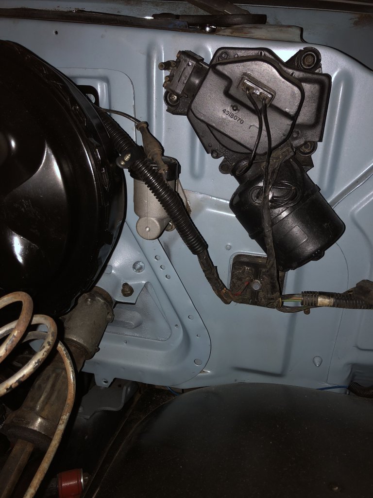

Heres a pic if that helps at all.
I'd guess about an inch, inch and an eighth..

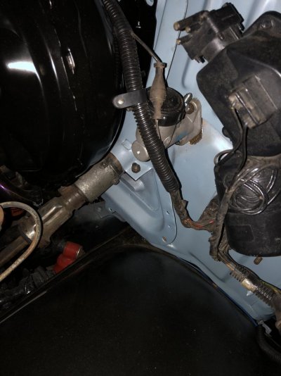

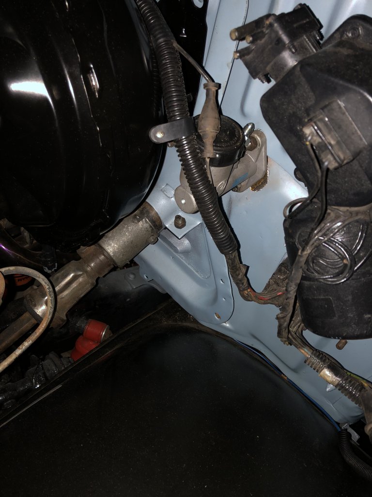

There is an existing hole in the firewall on my 74 that was close enough to use for the clutch M/C, just to the right of the brake M/C, so you may not have to drill a hole. I think it had the speedo cable going through it, which, depending on your transmission choice, may not be needed anymore or possibly relocated if still needed. What transmission are you going with?

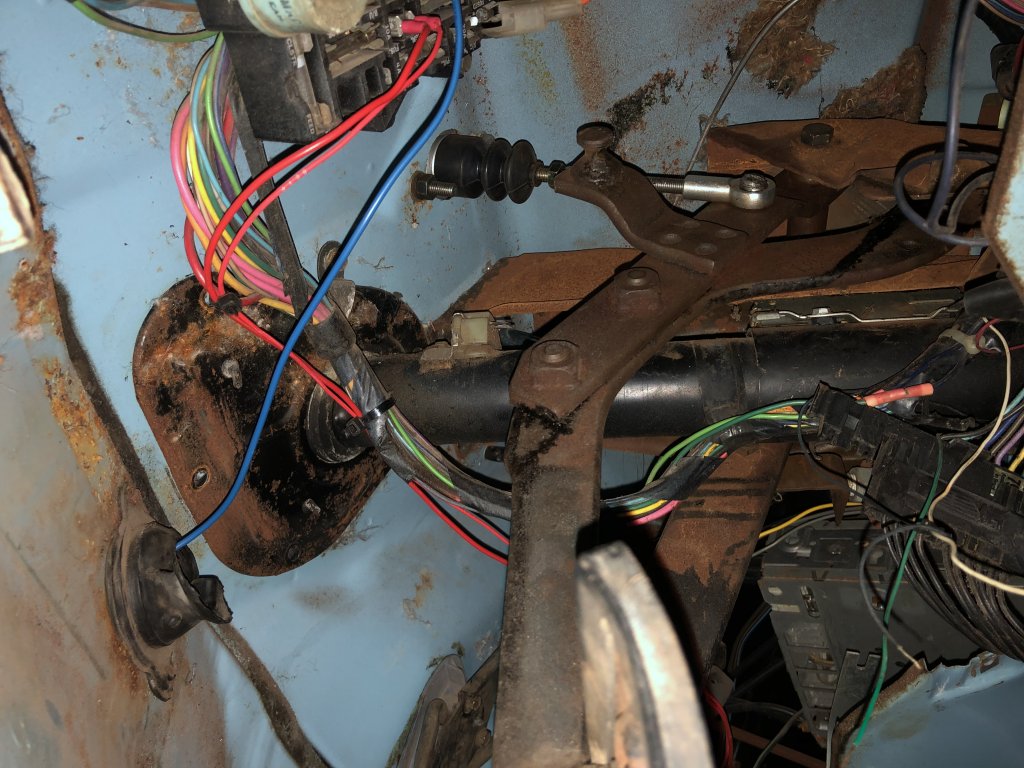

Would you happen to have a picture of the hole? I am using a saginaw 3 speed (its a hobby stock truck). No speedo

Truck looks awesome! I'll get some photos this evening with the MC attached. The hole I'm talking about is the one to the right of the brake MC with the cable coming out of it.

Here are some other photos from using the existing hole for the clutch MC
