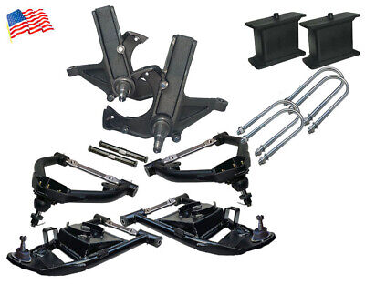

So I randomly found this c10 lift kit. It says 7 inches if lift but then there is 4" rear blocks. I don't understand how you are getting 7 inches out of that. I'd expect 4. But also is this a real kit?
There also seems to be several others.

My guess is it will be 7” “leveled” if that makes sense. A stock truck is around 2.5-3” higher in the rear than the front typically. So if you look at lowering setups, it’s generally a 2/4 or a 5/7 drop, this will result in getting the truck level.
So in this case going up the front needs to go up farther than the rear to be leveled since the rear is already higher.

ok i see. so in order to match that 4" of lift in the rear it goes up 7" in the front. somehow with stock springs.

so, if i took this kit and put it onto my truck w/stock springs i would achieve roughly 4" of lift?
No. If you scroll down and read in the description for the specifics, it says it comes with 4.5" lift spindles and 3" lift control arms. It doesn't come with springs, so it's intended to use with stock springs to achieve the 7" of lift.
Yea. I thought you needed better springs.
