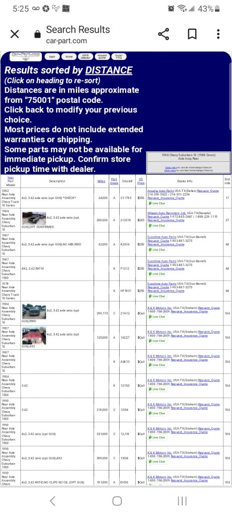

Light duty running around with a 700r4 you don't need to change gears.I've always used factory gears. Your truck has a super common 10 bolt, if you really want to change gears, do some research,so will I but I think a 3:42 was pretty common in burbs and the whole rearend will swap bolt for bolt. Pik n pull probably 100.00 . A little more ambitious there are probably several 10 bolts in the yard or craigslist with better gears to pull and swap gears. As in I could pull a 3:73 out of a 8.5 ring and pinion from monte carlo better yet check ebay for a 3:42 pull out from a grand national and swap gears.
@Velder check this

@Ricko1966 thank you for the input, are you saying replace the whole axle with one from a salvage yard? Or just the gears? sorry I don't understand, I cant really read the picture you posted

@Ricko1966 Sorry I did not see your last post till after I posted, Yes I did see the picture, but I can't read it.

Okay your 700r4 has a 3.07 1st gear multiplied time rear gear let's say 3.42 30 3.07 x 3 42 = approx 10.25 no calculator my th350 is 2.48 1st gear times 3.73= approx 9.25 so you would actually have more pull in 1st gear than me. What I was saying about rearends,yes a whole burb rearend would slide right under or if you find the right gearset in a different year,make,model 8.5 10 bolt rearend you can just swap the gears. The reason I said check ebay for Grand National pulll outs,is the guys hot rodding them swap in steeper gears but from the factory all GNs are going to be 3.42 or 3.73 somebody may have their left overs for sale cheap.thats where I got 1 of mine gears and and a posi carrier cheap. Okay open the thumbnail,screen shot it then open it in picture gallery so you can read it.Complete rearends already pulled gear ratio you'd like in the 250 price range. By the time you buy a gear set,bearings,seals,gaskets and shims,you are going to be well past that,and you get to learn how to setup gears. Which depending on how you do it us more money in tools you probably won't use again. I can tell you how to do it with a straight edge, a pair of calipers,a dial indicator and gear paint. Whether you can do it that way or not. I cannot tell you.

@Ricko1966 thank you so much for the explanation. I will certainly look into the salvaged axle option, I am not to far from three or four yards, so that might save me some money, time and headache. and thank you for pointing me to that site, I have never been on carparts.com before, that is super cool!
