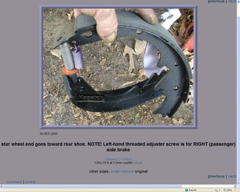

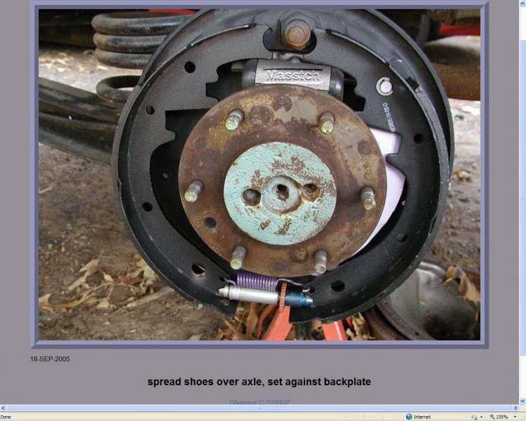

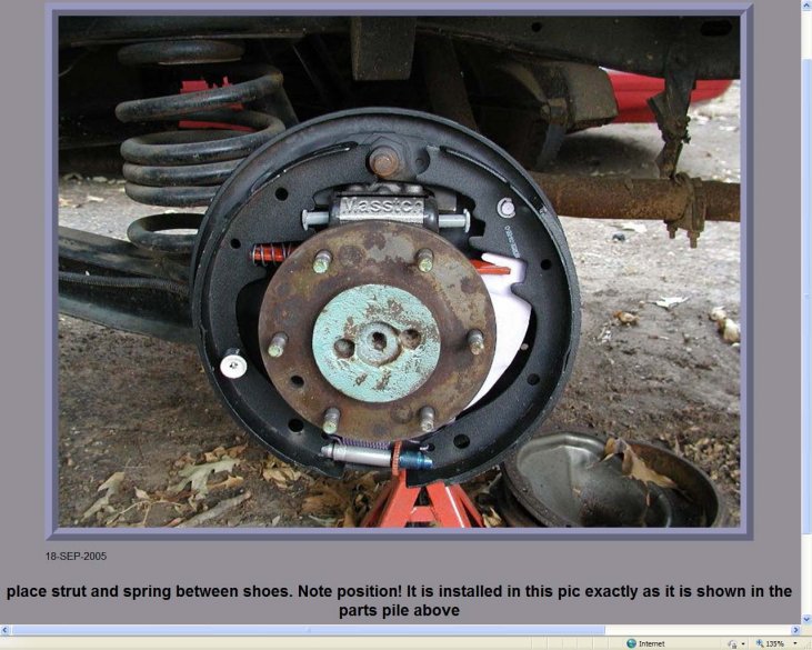

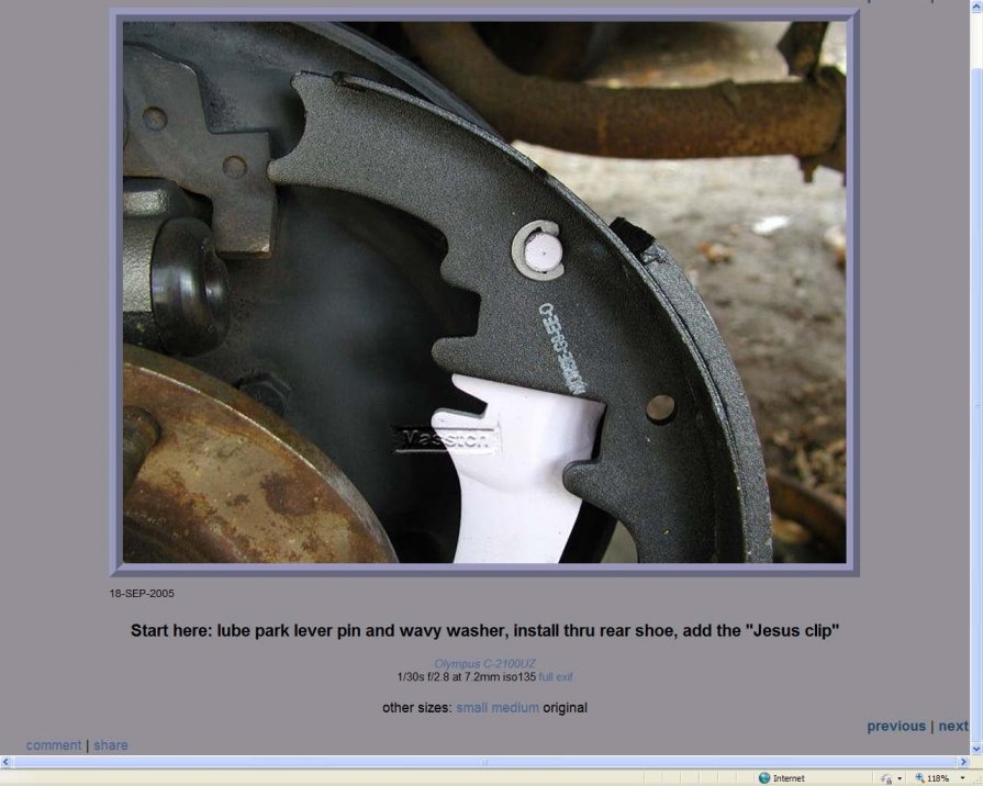

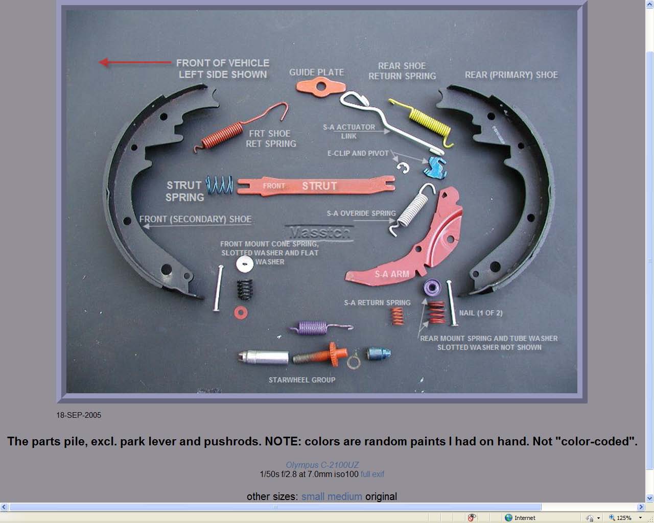

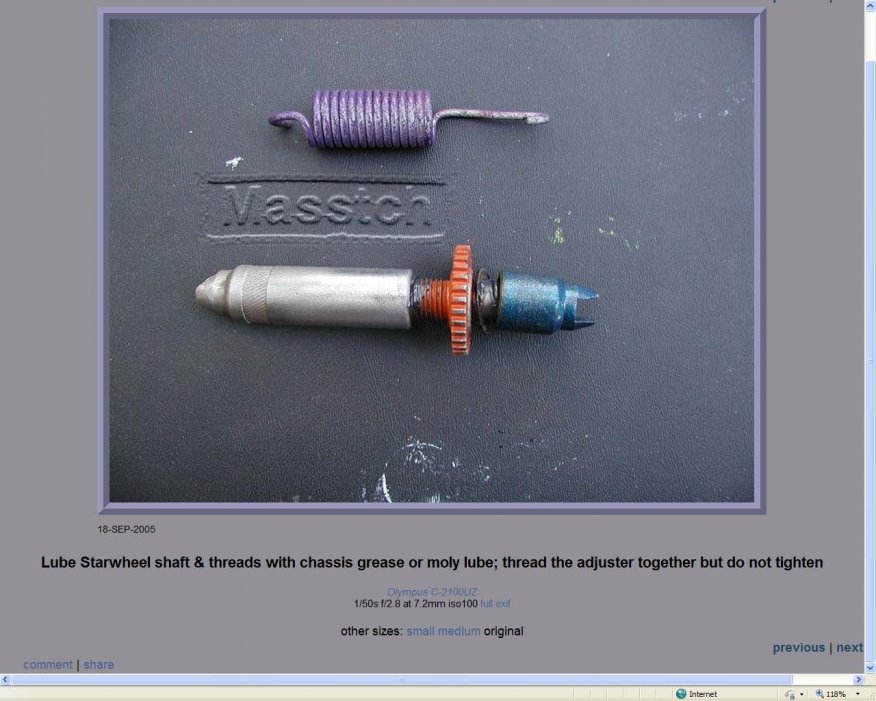

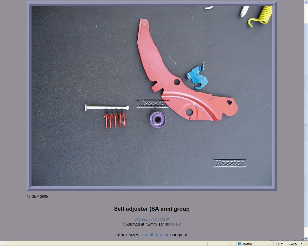

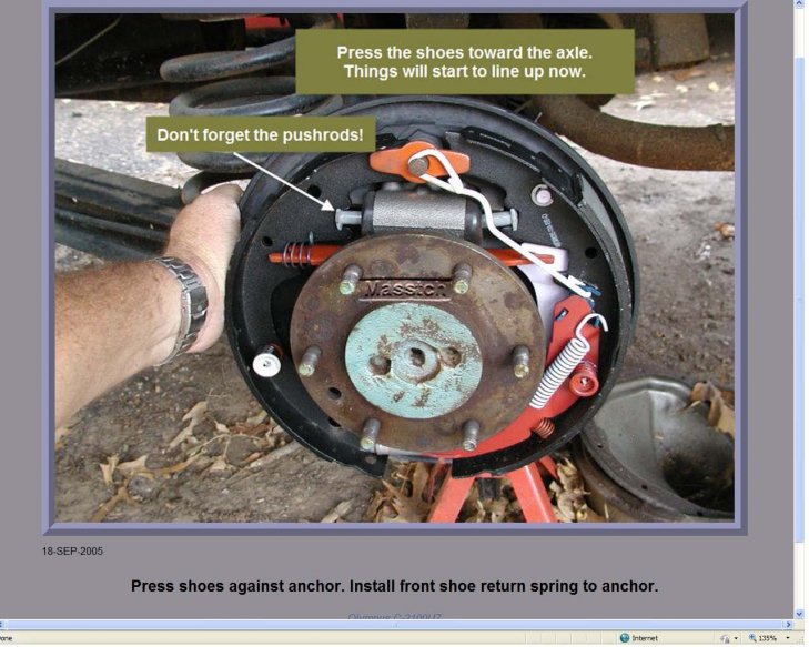

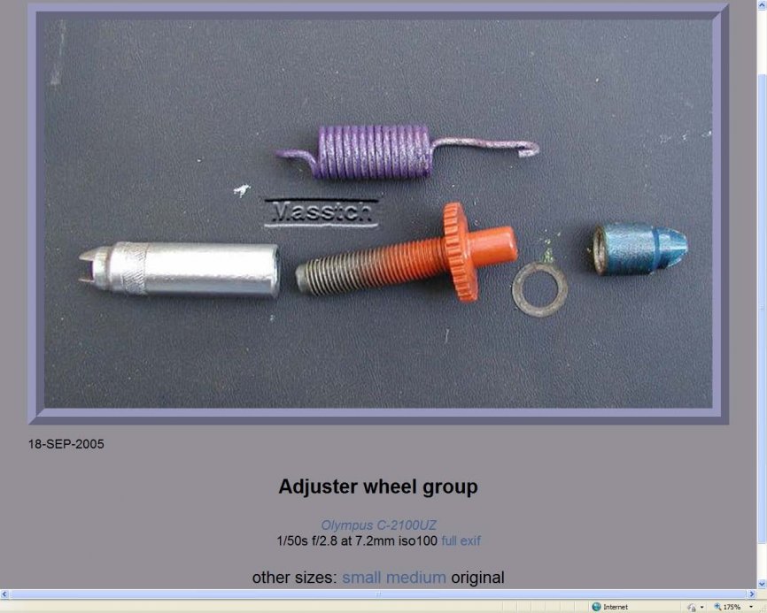

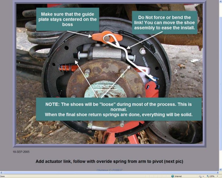

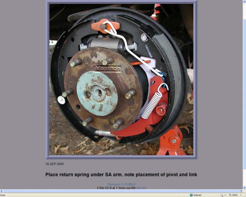

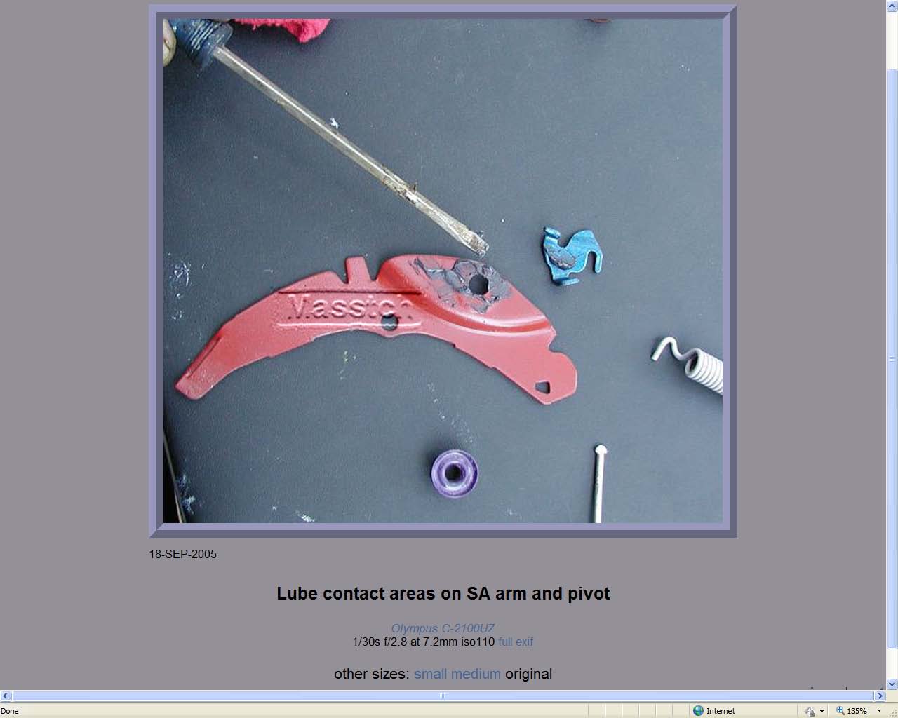

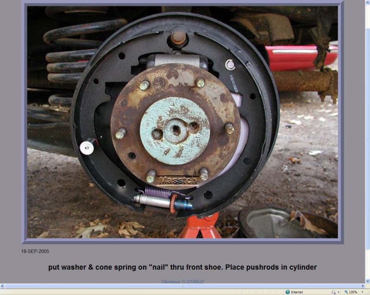

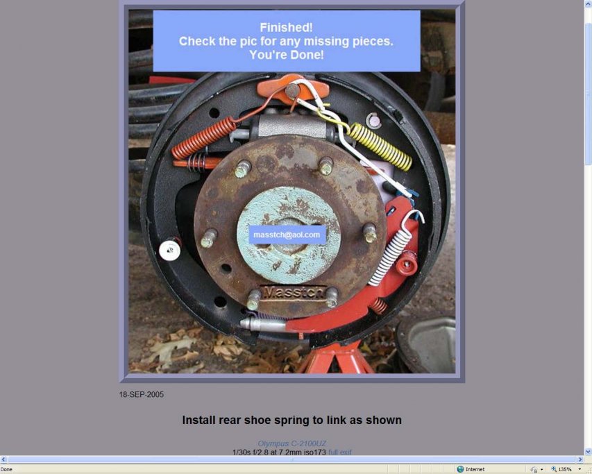

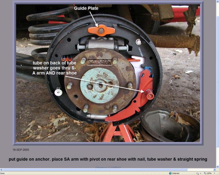

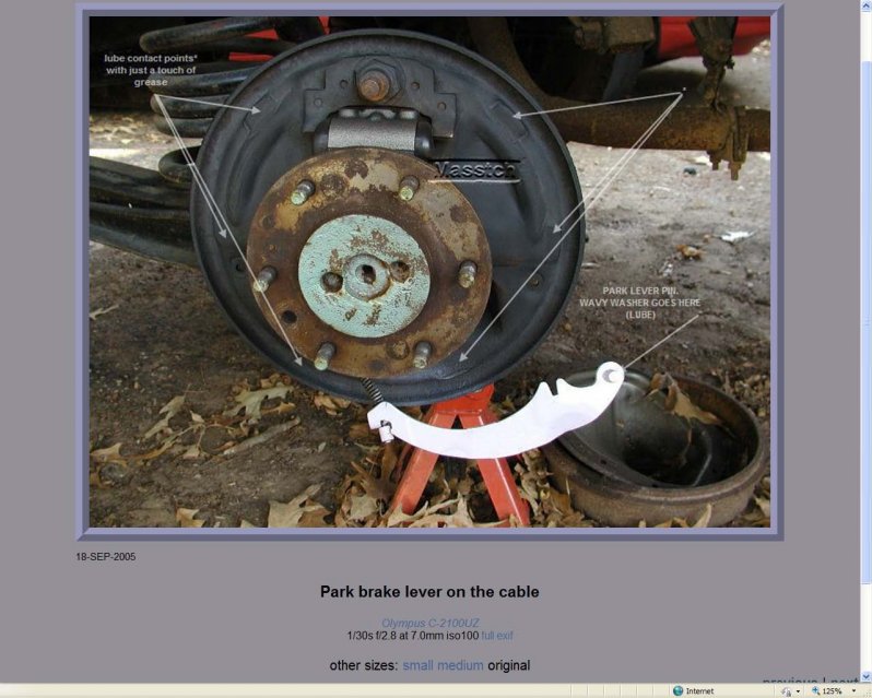

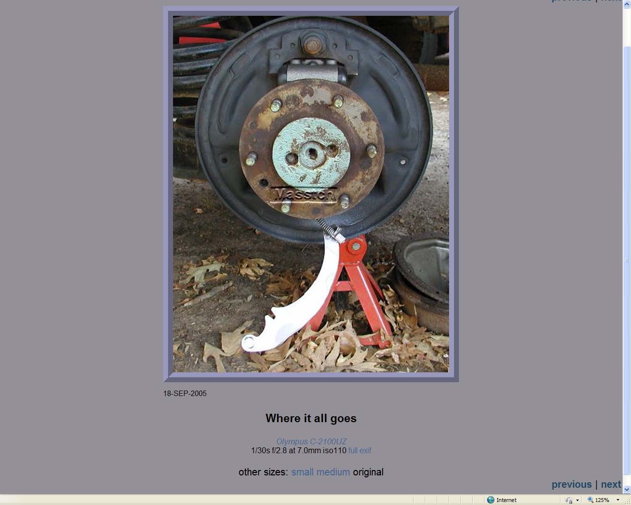

Drum Brake Rebuild Tutorial
The whole procedure (Thanks to Mr. Slaughter).
1 - 5:
chengny
Feb 22, 2012
4,084
1,028
NH
Jerry
K3500
350/5.7
6 - 10:
chengny
Feb 22, 2012
4,084
1,028
NH
Jerry
K3500
350/5.7
11 - 15:
chengny
Feb 22, 2012
4,084
1,028
NH
Jerry
K3500
350/5.7
16 & 17:
