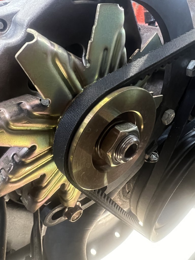

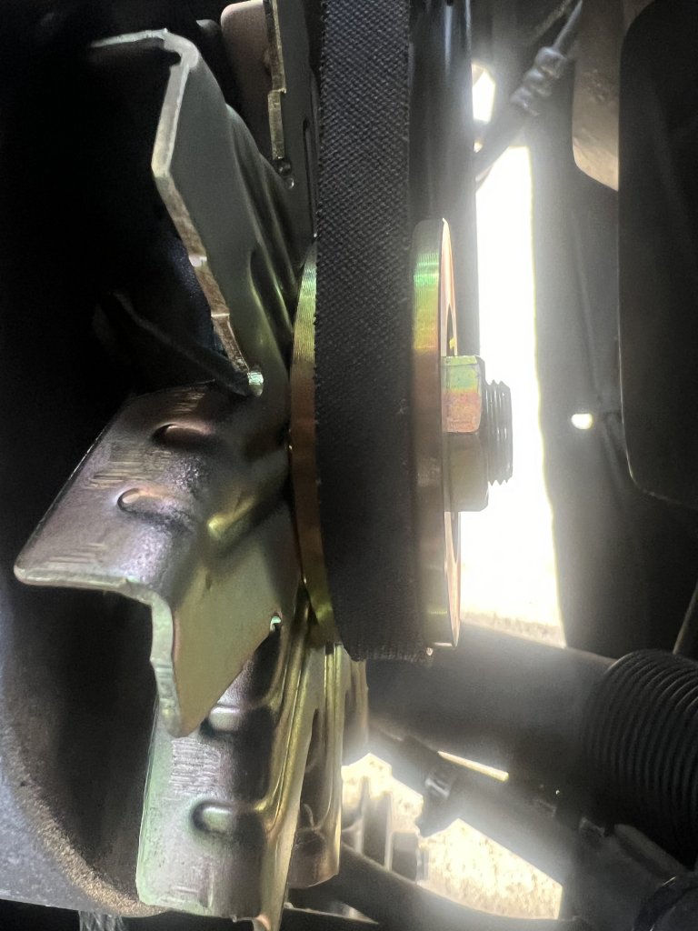

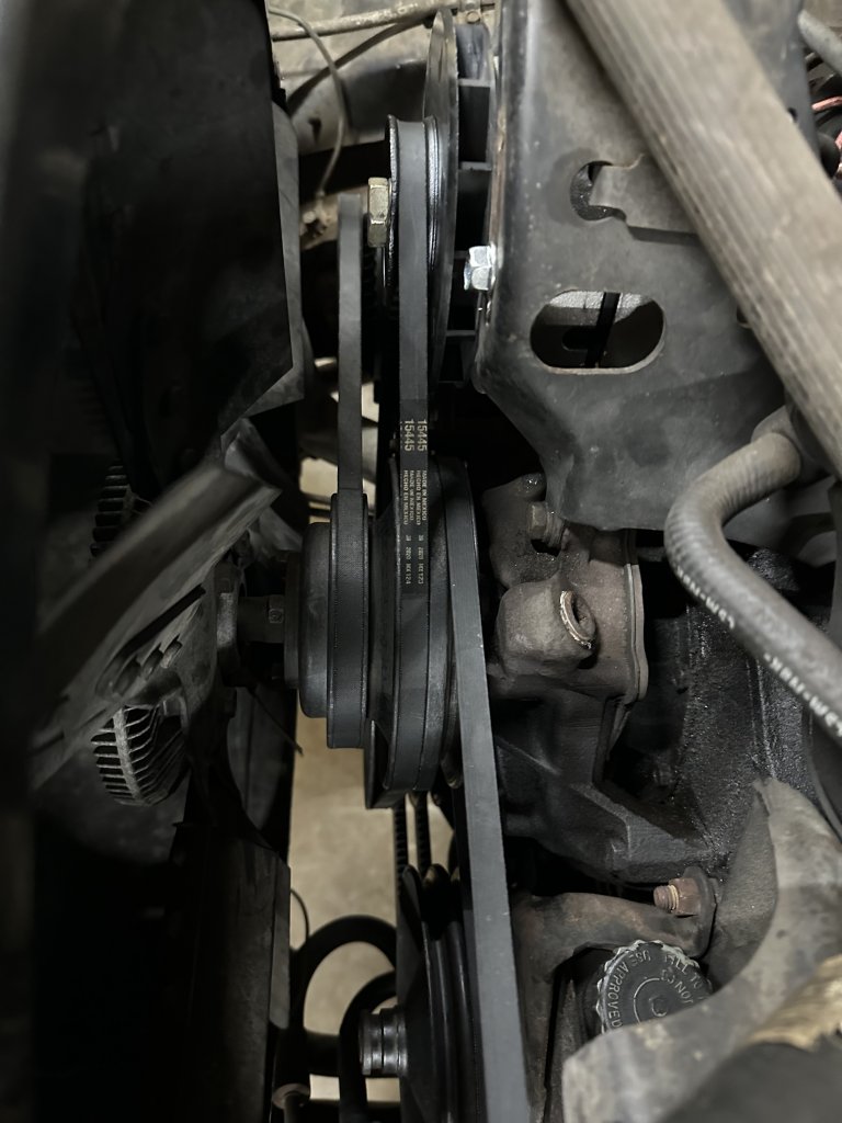

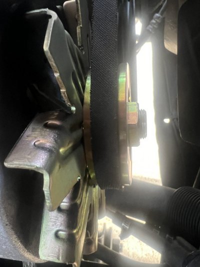

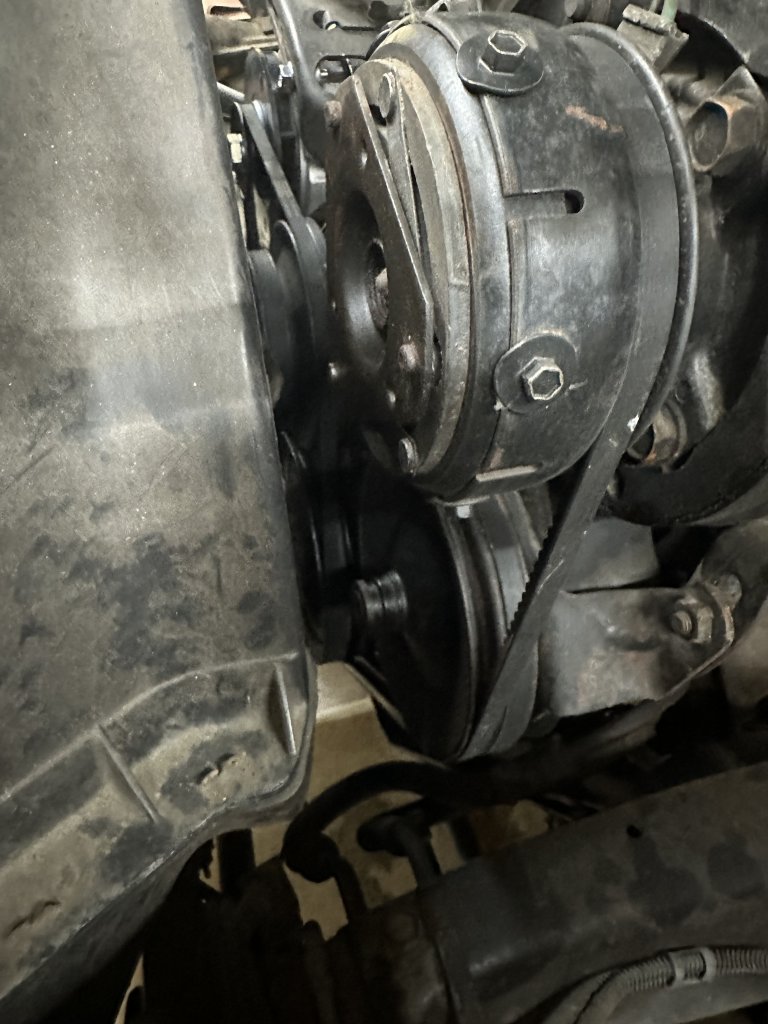

When you say you have tried different pulleys, were they used?
Take a look at the depth your belt is sitting at on all the pulleys. It looks to me like the belt is sitting too deep in the one for your alternator. The running surfaces should be straight and the belt should be sitting at or at least very close to the top of the V.
Sorry, didn't have more time to look for a better image, but here is a link that shows what I am referring to.
Likely just the angle of the pic, but the first one looks like there could be an alignment issue as well. Put a straight edge on it if you haven't yet.
edit; Forgot to mention, it looks like there is a bolt missing for the smog pump or whatever is below the alternator.
The pulleys are on rebuilt alternators. I'm on my third alternator. Thank you for the reference as the belt does sit a little lower in the pulley. It's not flush. Maybe this would cause the heat issue on the pulley?

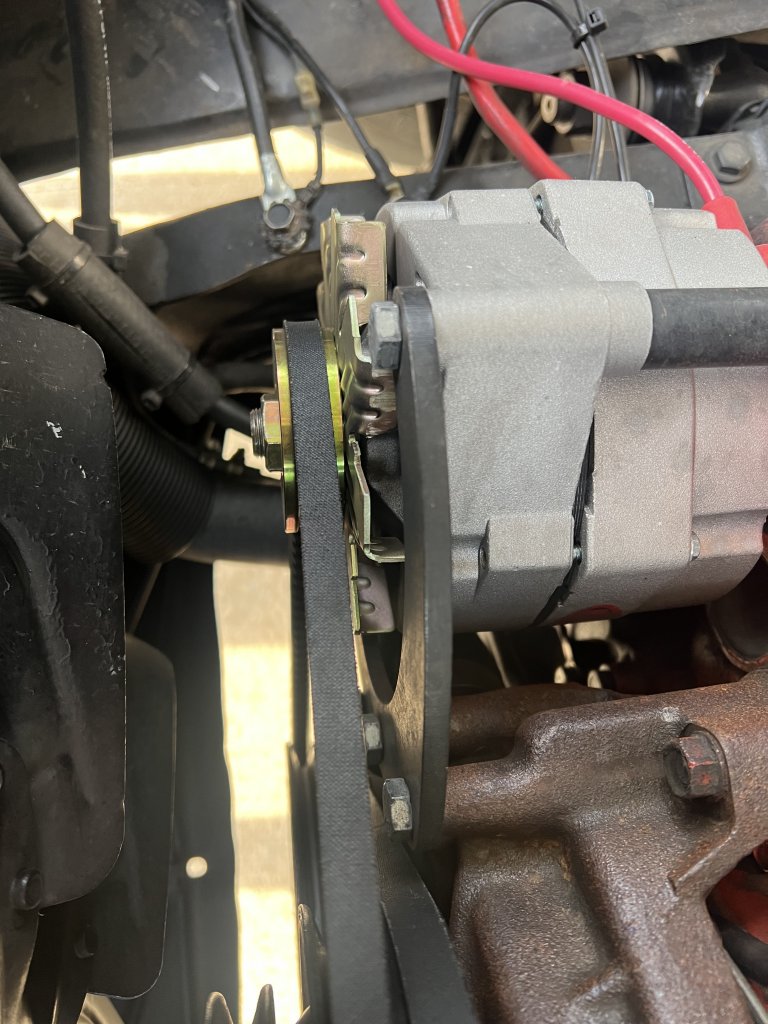

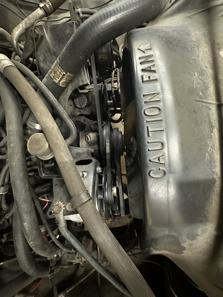

We are with @Snoots and @Buck69 bigger belt. Here is a pic of E’s setup. Got belts on Amazon which has a Goodyear belt section with free shipping and returns. Due to our custom set up, we ordered several different sizes and sent back the ones we did not use. Very convienient
Randy and E

Plot twist: I removed the alternator belt and fired it up. Still have a chirp which goes full squeal in upper RPMS. I removed the belt to the smog (?). Still had the noise. I removed the belt on the non-functioning a/c and it is all quiet again.
I'm still confused about the heat on the belt/pulley of for the alternator. Maybe it's slipping due to being too small. I will order a new belts and I will install a bigger wire from the alternator to the battery. I've seen 6 awg used on the site. I have 4 awg used for the stereo. Can that wire be used in this application?

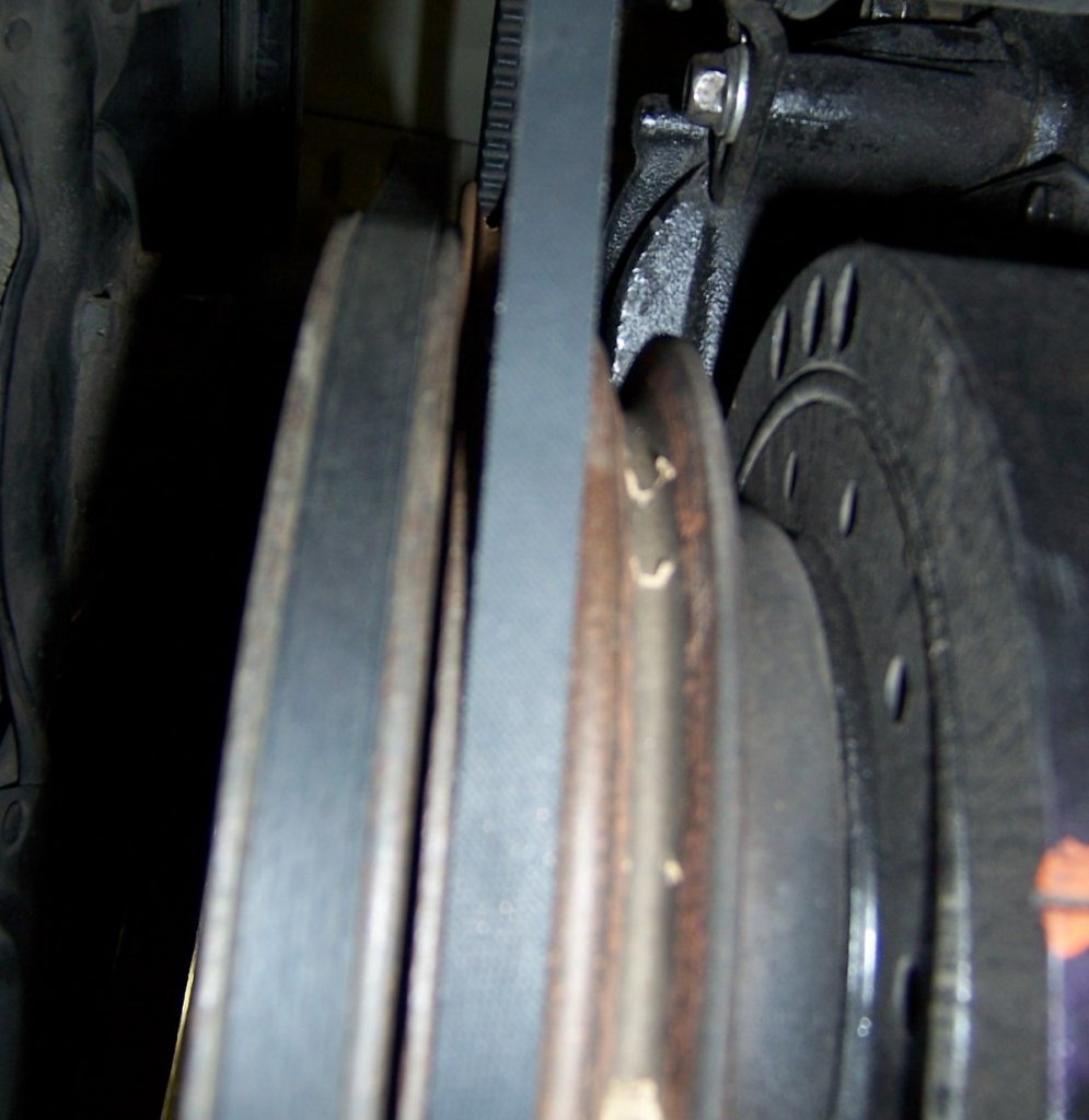

Have to respectfully disagree that belt construction is the issue unless width is incorrect. I have installed almost every brand belt out there and with the exception of serpentine belts never had a drive issue like this I could blame on the belt.
On pulleys, what you need to pay attention to is crank and water pump diameters. It's hard to explain. The comparative difference needs to be the same. We are referring to the alt belt only. If the pully sheave diameters are same on crank, they need to be the same on the water pump. If they are different on crank, they need to be different on the water pump. Reason it seems to be alternator pully related is the surface area of that pully is less than the other pulleys in the arrangement. I could be wrong pictures don't show what I need to make that determination.
Pictures below show a drive with different diameters that are matched, if that makes sense.
Don't start making additional changes. Alternator wire size and a small pulley will not cause this problem.

You do not need to change the wire.even after the squeal is corrected. Stay on task fix the squeals. Maybe the angle of your pics,but looks like an alignment issue. Pay attention to what fastvsays he's very knowledgeable your heat is from the friction of the belt slipping on the pulley, put a penny on your finger rub it on your jeans fast and hard ,it will get hot. The belt slipping across the pulley does the same thing. Quit changing alternators they are not the problem,and everytime you change a part you add a new piece into the equation.
