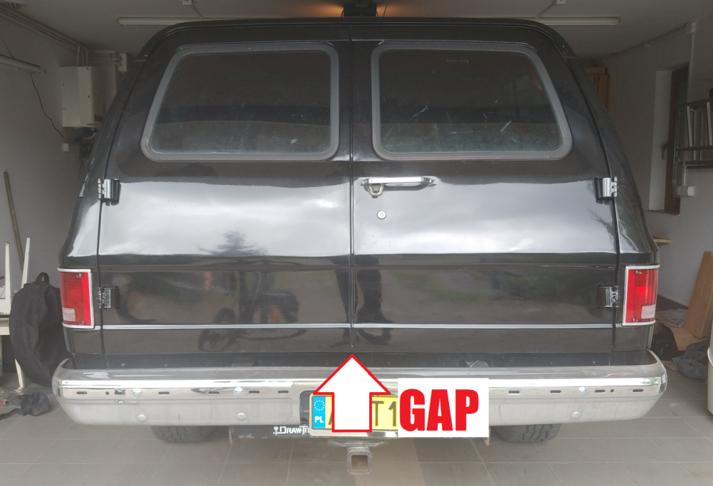

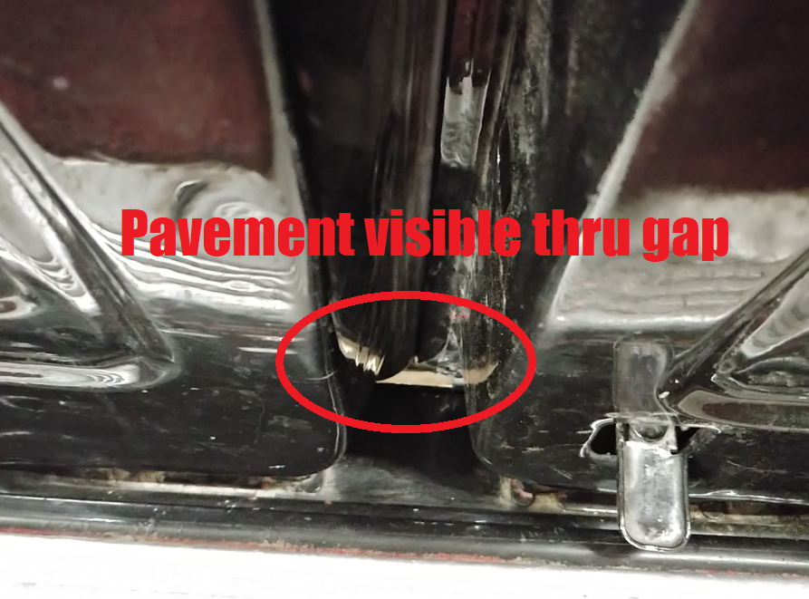

My barn doors are rattling, they seem to latch correctly (can be latched either on one "click" or deeper on a 2nd "click"), however after closing they have still some play, can be pushed in compressing the gasket. Those latch ears are adjusted as far in as possible while the latches in doors seem to not have adjustment. I have also a gap at the bottom of barn doors through which I can see pavement making me think that I'm missing some gasket on the opening? I have a gasket all around one door and on 3 sides of the other door, which seems to match weather stripping available online.

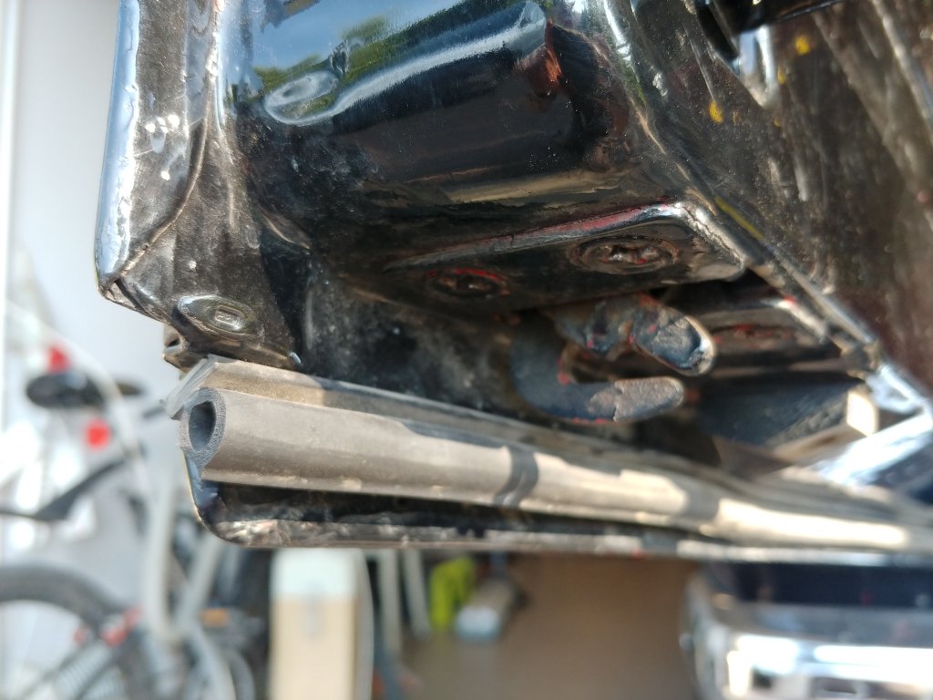

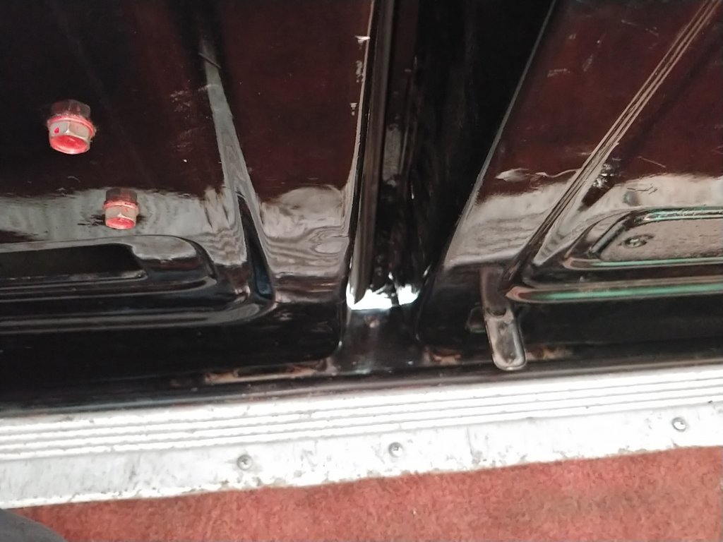

I took some pictures: that's how the barn door opening looks in my burb, you can see daylight from the inside with the doors fully closed

Barn doors doesn't seem to sag, I have one sagged door (front right) but that's something I'll have to look at later on. Unfortunately being in Poland means that parts are not readily available in parts stores. Actually part stores are almost nonexistent, everyone buys stuff online these days.
In the end bending the barn door strikers (that three ears, one of them broke, so now I jsut have two on the bottom) together with adding a 1-2 mm thick rubber "washers" under rubber wedges (bumpers) helped to get rid of the barn door rattle. There is still a gaping hole in the area between doors and floor that I have no clue how it supposed to be sealed as I can't find any seal or whatever that should go into that place.
Looking at LMCtruck it appears that nothing should go in that area. I have weather stripping on both doors.
EDIT: I've just realized something: My weather stripping on left barn door seems to look different than on LMCtruck page. Do I have some aftermarket universal gasket?

You can make your door weather stripping tighter by using foam backing rod and silicone spray. Foam backer rod is a low cost product that comes in a large coil and is used to fill large gaps prior to chaulking. The silicone spray will make your weather strip slippery without hurting the rubber and it does not smell later on. Spray the weather strip and slide the backing rod into the hole of the weather strip. When you close your door the weather strip will collapse less causing the door to be tighter. I used 3/8 inch diameter foam rod for my F350 but my squarebody will get it as well. Type Foam backing rod into Google Images.

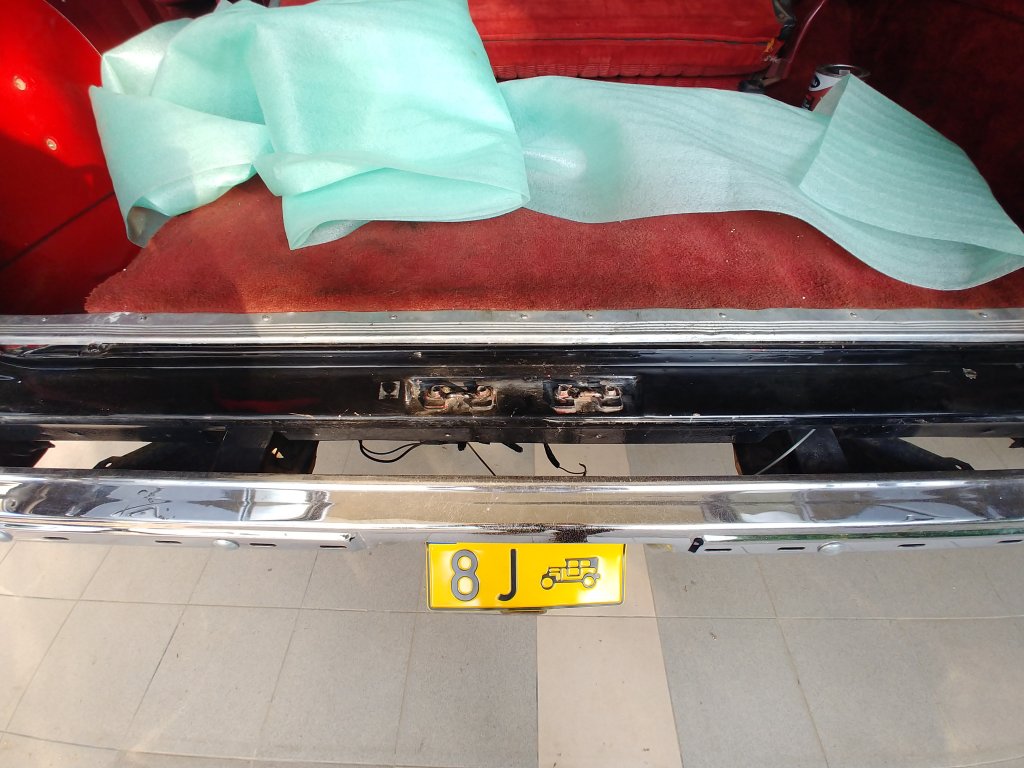

I glued a piece of black insulating foam to cover that hole, looks similar to that foam backing. Also got a replacement door striker from LMC.
