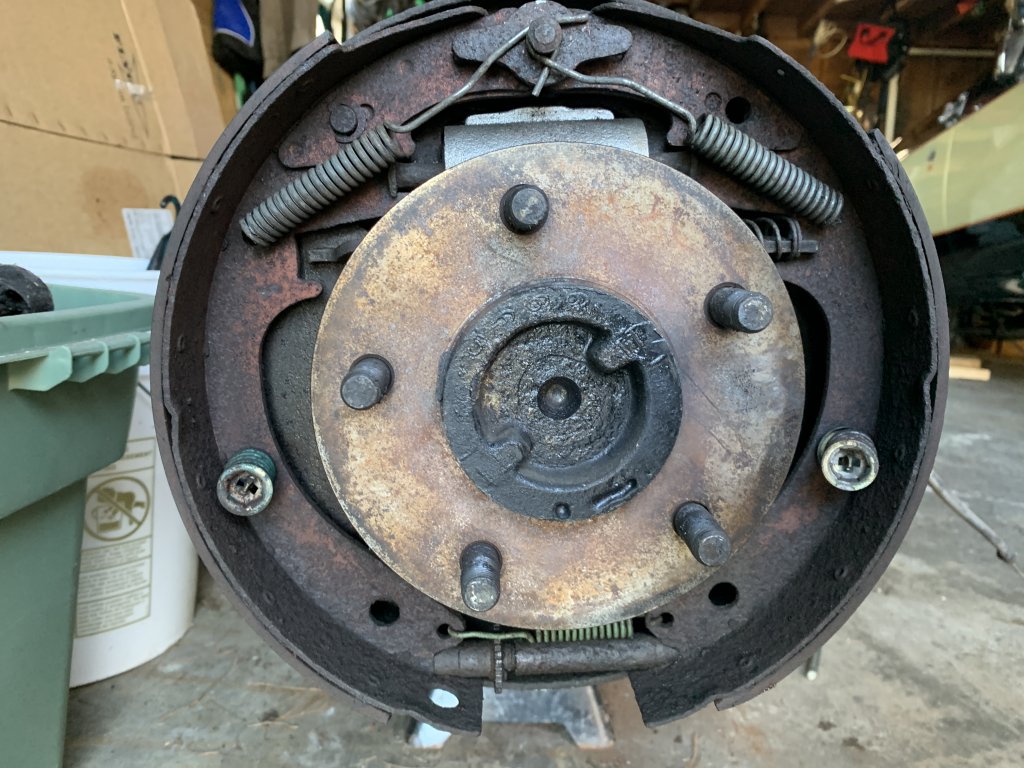

Were there any years that GM didn't put automatic slack adjusters on their rear drum brakes?
I am getting the brakes on my 1980 step side back together and discovered there was no slack adjuster lever on my truck.
Every picture I have seen of gmc/chevy show these included. Mine are 11x 2-3/4 shoes on a 12 bolt rear end if it matters but I am sure it doesn't.
Also the two upper springs are very similar in size and shape on mine, while every pic I can find show a smaller spring on the side of the adjuster where it attaches to the slack adjuster.
I have ordered all the missing parts and will just chalk it up to the previous owner lost the parts or just didn't know what he was doing.
The more I work on this thing the more issues I find, but I guess I will get it sorted eventually.
Here is a pic of how it looked before I took everything off last fall. New shoes and hardware will be going on. Hoping to reuse the drums.
Thanks

Self-adjusters were stock. One incorrect spring, missing parts. Needs self-adjuster and hdwr kits. Be sure and check cables for being stuck. Also lining appears to be delaminating on the top.

Replacing both rear cables, front cable, wheel cylinders and shoes. Couldn't source an intermediate cable, but thankfully mine is in ok shape.

Previous owner probably lost some of the parts and didn't mind periodically adjusting the brakes, so he never bothered ordering replacements. Maybe he was just too cheap!
