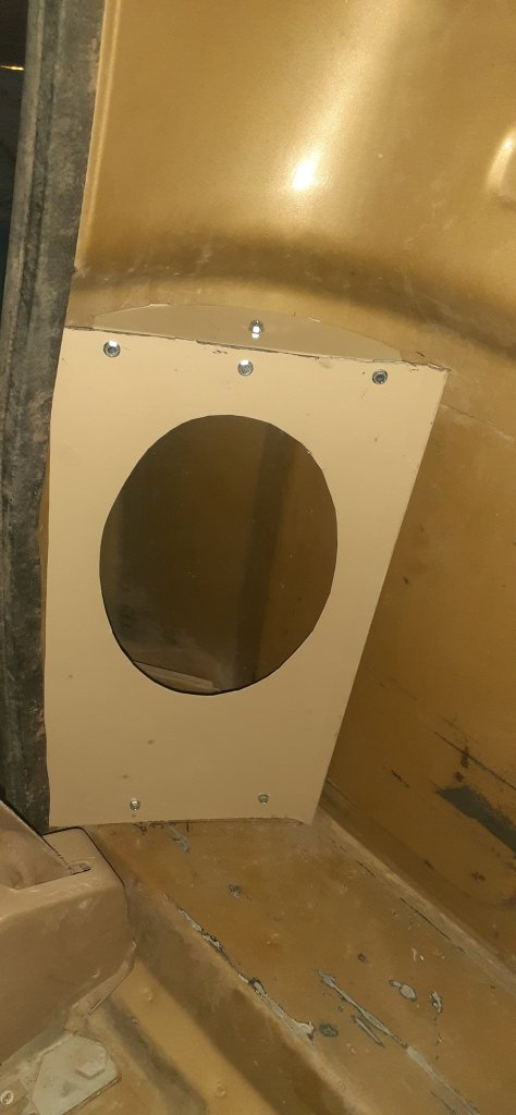

Modify them. What do you have to lose? The good thing about steel is you can always fix it. I had to build my own rear speaker mounts for 6 x 9s. Sometimes you gotta do what you gotta do.

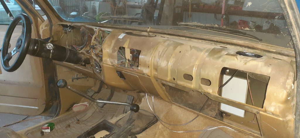

A little "snippin' and tin bangin'" saves you 40 bucks. This truck didnt have anything for rear speakers. I also put some little 4 inch under the dash. They didn't fit perfect cut a few self drilling screws holds them nicely.
