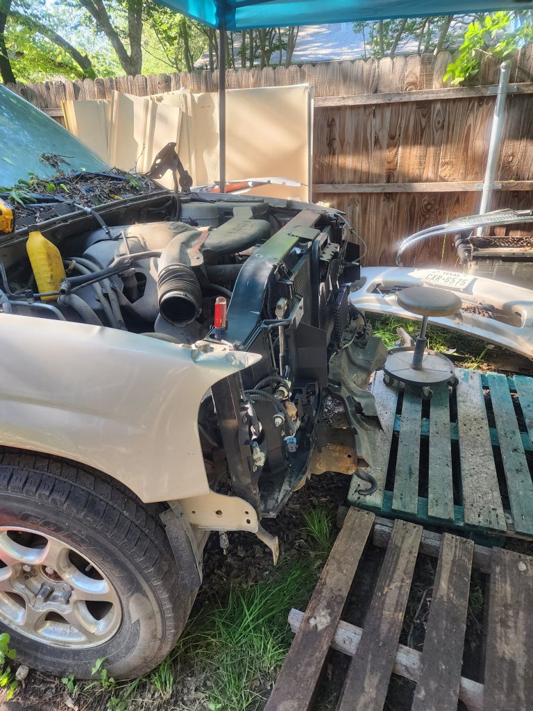

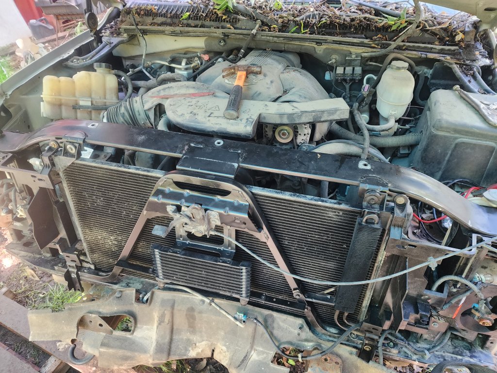

Not the update you're looking for, but it's the update I've got. Dad came in Friday afternoon (that's him standing in front of the finished truck), it rained all day Saturday, but Sunday evening by 11 it was 90% done and still ugly, but much less ugly. Still need to splice a trans cooler line, then refill all fluids and get it moved out and cleaned up from where it's sat for over a year. and eventually the hood gaps straightened out and a fresh coat of paint on the new/used hood and maybe the fender, but for now the paint was the same color code and the price was right. This was my running 6.0 that was going to get swapped into my 87 V2500, but I think I've decided it's better as a daily, and the 87 needs something more like an 8.1 next year.
I'll get started on the 2013 teardown probably this weekend.
